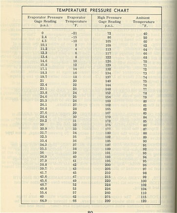

        this thread is useless because people would rather share political opinions about Freon type rather than answer my questions. People don’t take the time to read either or you’d see I posted the pressures.
        Idling: Low: 50 and high: 115. 6pm 85F ambient temp.​

          Here's your temp and pressure chart.
          For 86 degrees ambient you should be about 32 degree on the evaporator, 30psi on the low side and about 175psi on the high.
          yeah... you have a tired compressor.
            Click image for larger version Name:	r12_a_c_pressure_temp_chart_e9bedf3a8cfcecfd8e506e1928fc8f4f63419207.jpg Views:	0 Size:	48.8 KB ID:	10127110
            thank you. First worthy answer. After some research, looks like I can still have the R-12 compressor rebuilt. May source another r-12 compressor at a junk yard to send off for rebuilding. Then switch them out so I don’t go weeks without AC.
