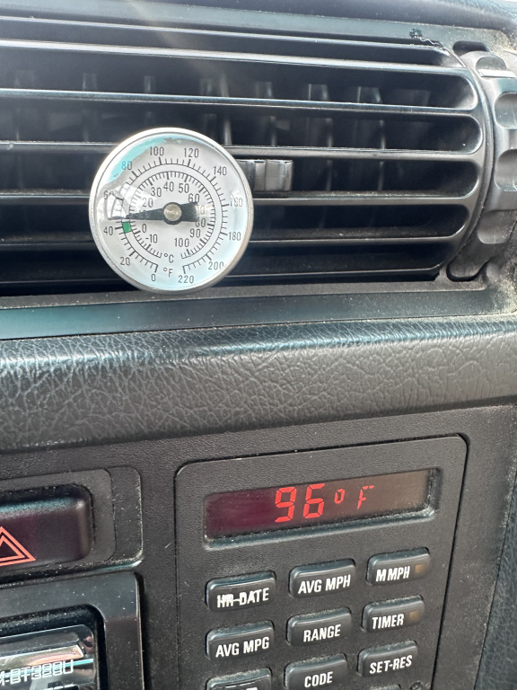

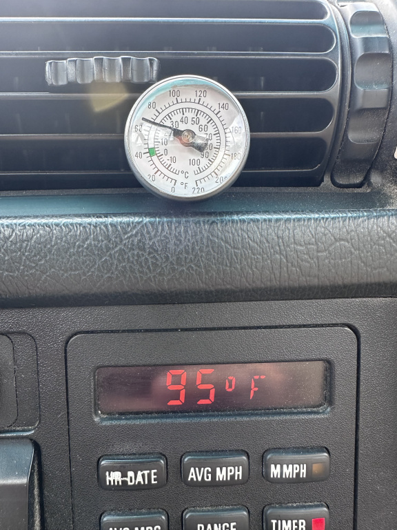

    I took pics of the thermometer on my drive today. It was so cold in the cabin that i needed to turn on the heated seats. This is clearly way colder than anyone needs and would much prefer consistency across vehicle speed than extreme freeze while cruising on the highway.
    Vent temp while doing 65 MPH:
    Click image for larger version  Name:	IMG_6483.jpg Views:	2 Size:	212.6 KB ID:	10126349
    Vent temp while idling:
    Click image for larger version  Name:	IMG_6486.jpg Views:	1 Size:	219.5 KB ID:	10126351
