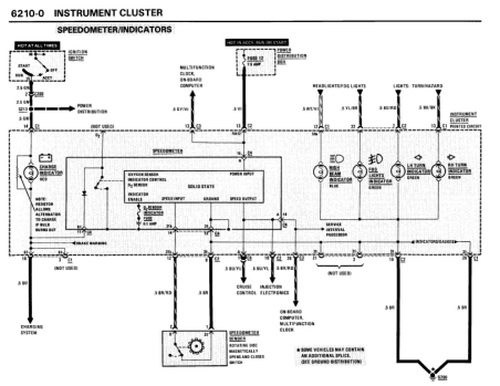

    Has anyone figured out the best way to drive w/o a cluster and keep the alternator charging?

    have read about guys putting a diode or bulb on the alternator circuit at the cluster connection. that's the circuit that gets broken shutting the alt down when the cluster is out.
    edit: have not seen a pic of how it was done.

      Doesn't the cluster have a resistor in the circuit?
      "Note: Resistor allows alternator to charge if bulb burns out"
        pretty sure it's dependent on model year.
        • reelizmpro
          • 9538
          Early 84-85 models did not have the bypass resistor. If the bulb goes out, the car doesn't charge.

            well mine is not charging w/o the cluster. if the resistor is in the cluster then it wouldn't help if the cluster is removed but would if the bulb blew

              The resistor connects the contact 14 (+12V) and 16 (charging system) of the C1 connector.
              You can measure its resistance.
