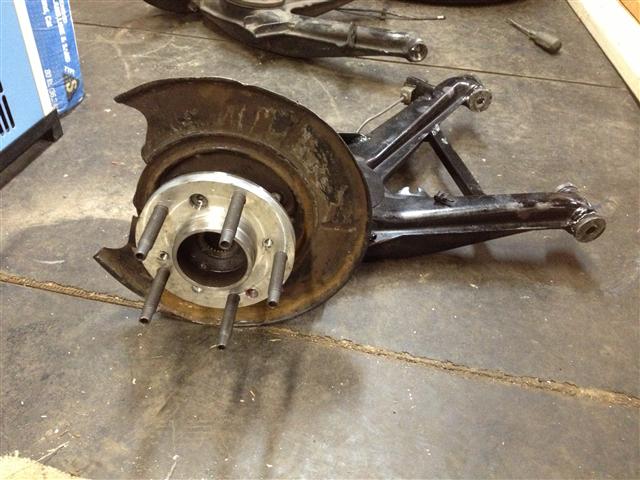

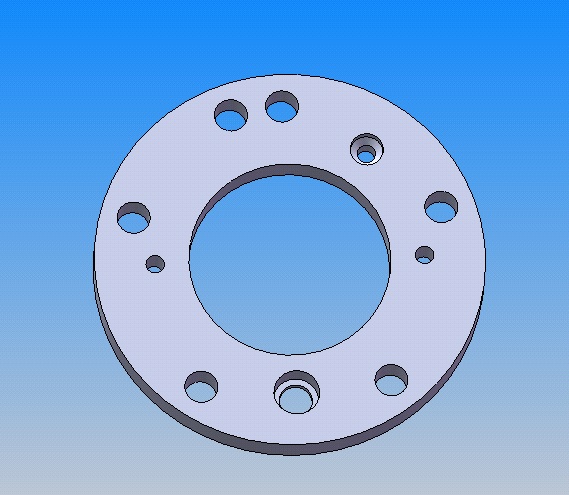

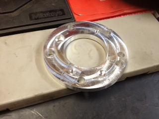

              Here is the hub spacer that I made. I just have to turn a ring to press into it that will locate the rotor and wheel. I should have the car back on the ground this weekend. I should be able to fit the 15x8 wheels with et20 offset and 225/50/15 RA1s without a problem.
              I don't know how this compares to the e30 M3 hub placement, but I had these e36 parts, so I went for it. I just wanted to show another option out there.

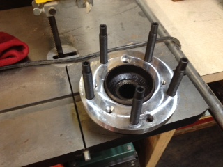

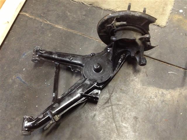

                  I wasn't sure what the offset of the e30 M3 rear hub was between the bearing and the hub face so I didn't go that road. I know it can be pressed into the standard late e30 trailing arms. I didn't want to buy the e30 M3 hub if it didn't bring the wheel mounting face toward the center of the car. I assumed the e30 M3 hub moved the wheel mounting face further out because it has wider fenders. I am doing this to run et20 wheels. By using the standard e36 rear hub, the spacer I made, and rotor, the wheel mounting face will be the exact same width as it was when it was 4 lug. I am going to assemble it tonight. Any specs on e30 M3 rear hubs and rotors would be greatly appreciated. Maybe that is the better rout of doing what I am trying to do. It all depends on the offset on the hub. I suppose if someone could measure the offset of a rear rotor from a standard e36 and a e30 M3 that would give me the answer.
                    I got it all together. Here are a few pictures. This should allow me to go back to the et20 wheels in 15x8. I wasn't able to get the parking brake to fit, but this is for a track only car, so it is not that big of a deal. I believe this places the wheel mounting face in the same location that the e30 M3 hub would.
                    It really would be nice if there was another hub that had the same offset between the bearing mounting face and the wheel mounting face. It needs to be 31mm to fit the e36 rear rotors.
