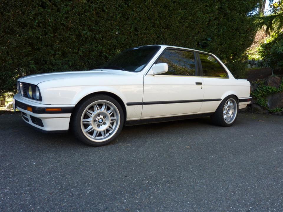

                      '97 E36 M3 front, '99 M Coupe rear. 17x7 on 215/45/R17.

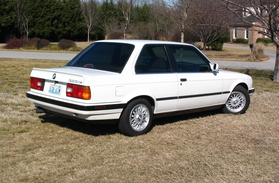

                          Originally posted by MikeK
                          BBS RK007 16x8 - et15 - 225/45-16
                          Looks good. i got the same wheels for cheap from a friend. Looks like you dont have M3 brakes? My clearance is so tight with the 16" wheels and M3 brakes, that I had to stick the wheel balance weights on the outside, which looks tacky

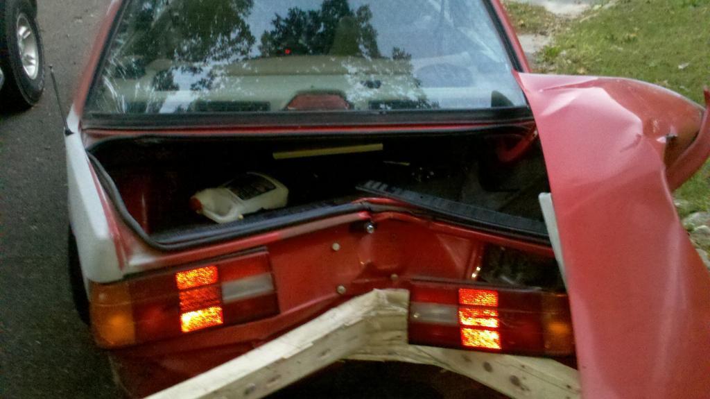

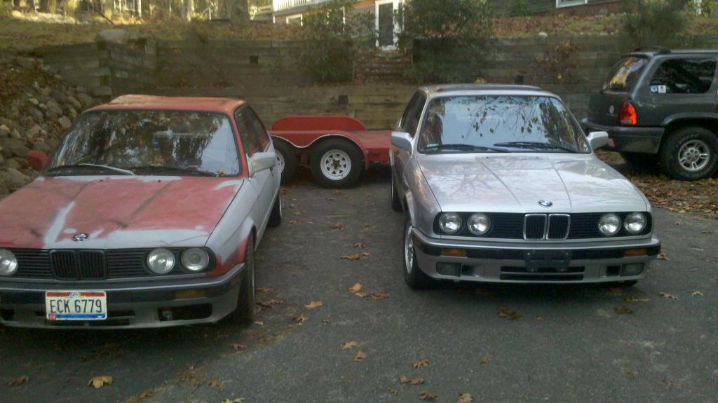

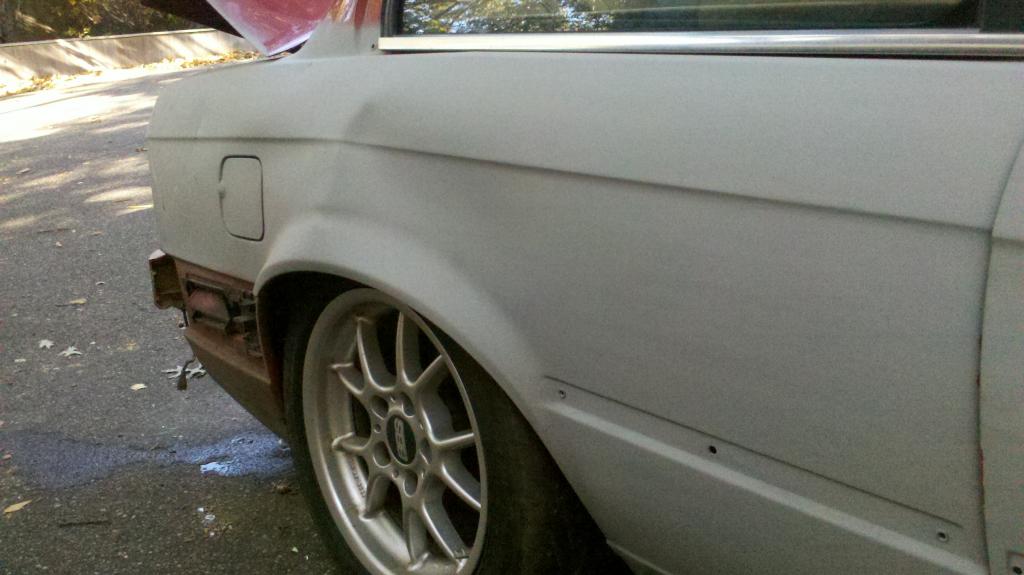

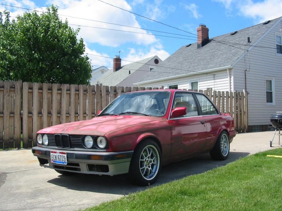

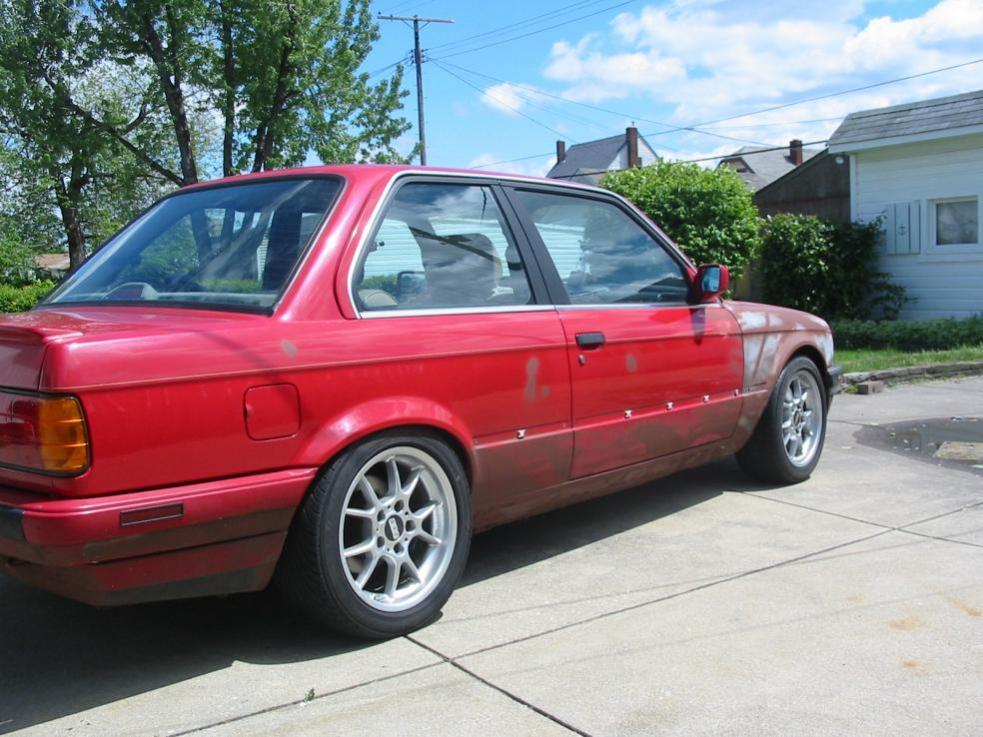

                              Heres mine with the BBS rk's on it. Seeing Mikes car in this thread reminded me I had a pic of it. they look better than the borbets. (I have the borbets still and will sell them)
                              my plan was to get the car repainted but I screwed up and slid her into a tree recently. the rear end is caved in pretty badly, so now its a donor car for a clean body I picked up from a fellow forum member
