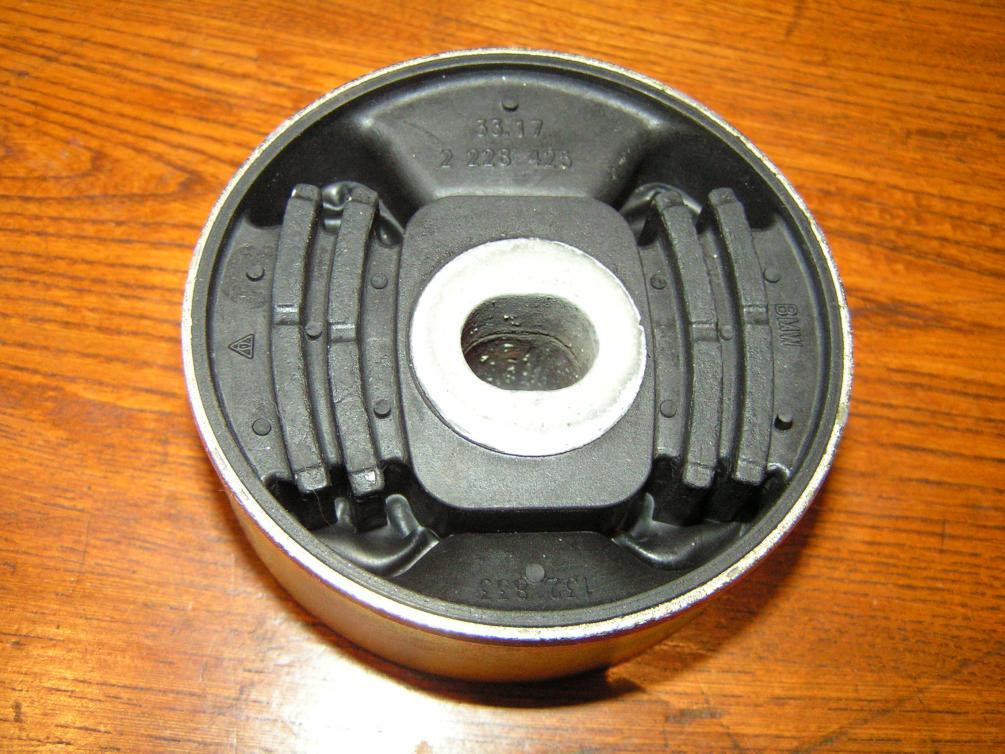

    The bushing? The z3 one has the two metal plates inset on each side of the bolt hole.

            the MZ3 or later model (m54 engine, 01 and 02) Z3 bushing is the one with the metal plates.

                  • TrentW
                    • 2815
                    Just in case anyone wanted to see the difference...
