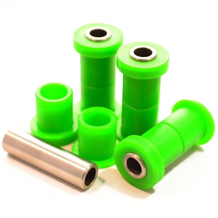

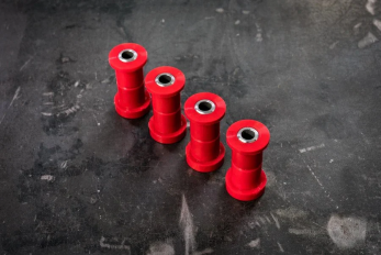

                  i have a set of poly TA bushings from Superpro and they are one (1) piece design. The bushing is several mm shorter shorter than the metal sleeve. So the TA will be able to have some end float a few mm (3-4mm iirc)
                  With other brands (they all seem to appear to be two (2) piece designs) when you push the two bushes into the TA and then push the metal sleeve afterwards does the sleeve stick out further than the end of the poly the bush? I am wondering if the end face of the bush is supposed to bear against the TA lugs internal face with these designs? or do they all have some end float?
                  only the IE seem to be flush

                      i found this photo which appears to be how i would expect the bush to interface with little to no axial free play with the axial compliance provided by the axial compression of the bush hat
