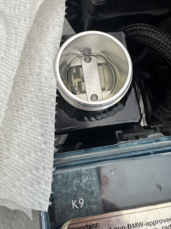

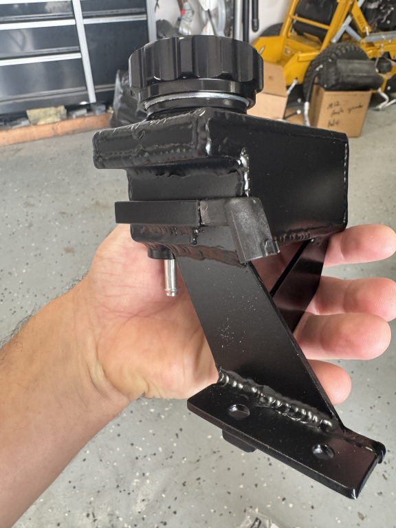

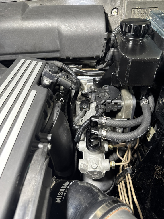

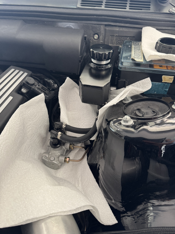

                  Couldn't find a suitable MC reservoir I was happy with so made one of my own.
                  I found a UK company that sells a Tesla booster adapter with AN6 fittings.

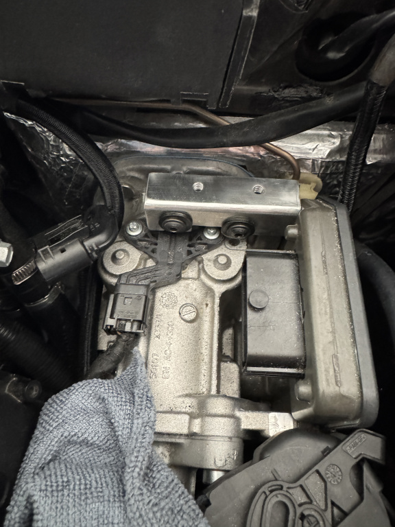

                  Made a mounting bracket out of some aluminum I had laying around. The forward facing bolts are very difficult to get to with everything in place, the threaded bracket made life much easier.

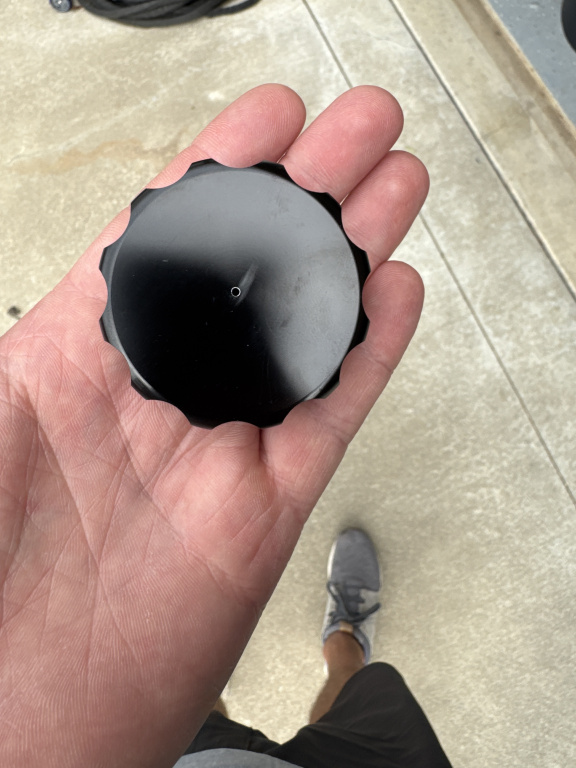

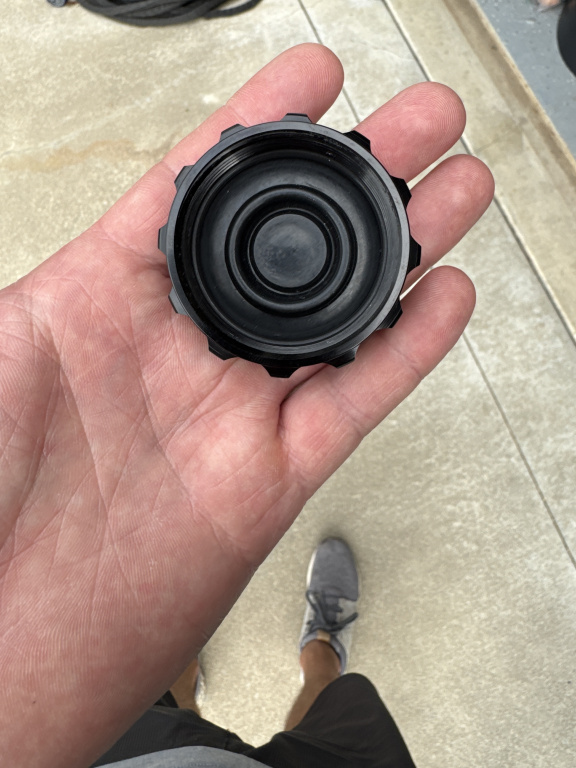

                  I ordered an aluminum weld in cap from Dedicated Motorsports and found a cap gasket on amazon: https://www.amazon.com/dp/B0CJP55D4C...fed_asin_title
                  Drilled a small hole in the cap to allow it to vent.
                  I didn't like any of the Tilton options because they vent direct to atmosphere without a gasket.

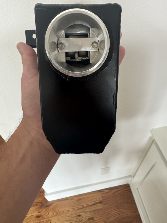

                    I took the floating hall effect switch from one of the reservoirs (it works fine through 1/16" aluminum plate) I tried and mounted it upside down, to make it normally open, like stock E30. The float itself was tricky, had to figure out a way to install it after welding, that's why the cap is so big. The reservoir is baffled to mimic the stock E30 reservoir and I used AN6 bungs for the master cylinder and a 1/4" barb for the clutch.
                    The amazon AN fittings/T7 design adapter leaked, I tried to different brands from amazon so I think it may be the adapter. I ended up ordering some AN seals from summit and they seemed to have solved that issue.
