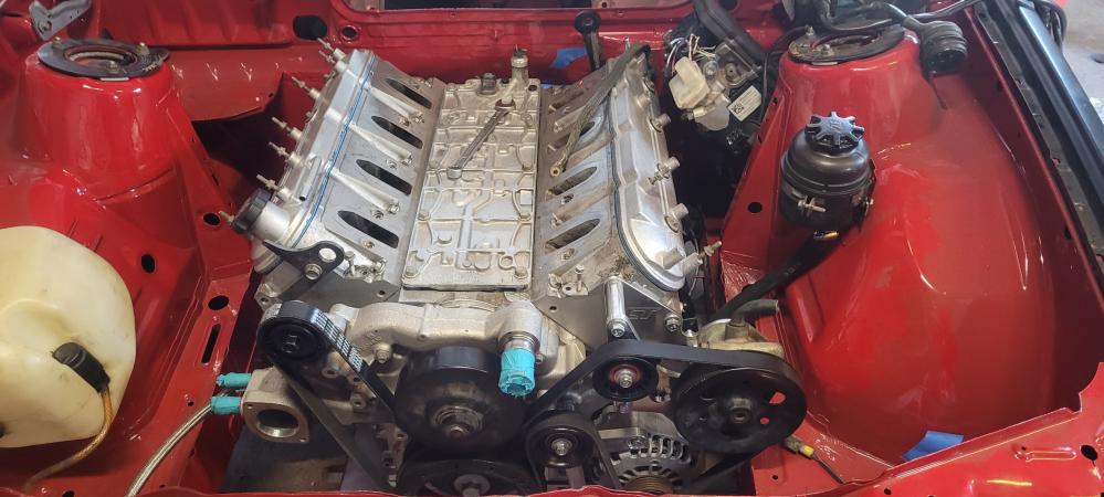

                              I've been running one in my car for a while now, they work great. The pedal sensitivity requires can-bus communication.
