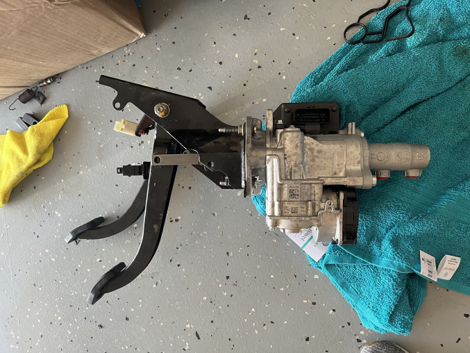

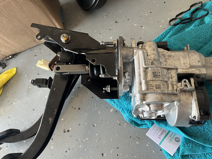

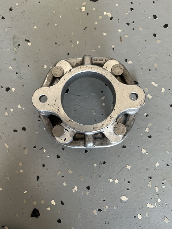

            I bought a unit out of a 22 Chevy bolt for about $130, the Tesla ones are expensive for the same thing and the Bolt master will provide more room unless you can get a RHD Tesla one, I'll just come up with something like warzywko​ did for the reservoir. The firewall pattern is different but the studs and input threads are the same as an e30. I had a local shop fill and drill the flange to match the e30 firewall and pedal box.
            They can CNC a new billet flange but the first one would be about $300, then I'd be right back to Tesla prices. I had them fill and drill but if enough guys are looking for one of these I will have them draw it up and it should get cheaper if enough of us want a pretty one.
            Click image for larger version  Name:	IMG_1032.jpg Views:	0 Size:	151.4 KB ID:	10104677

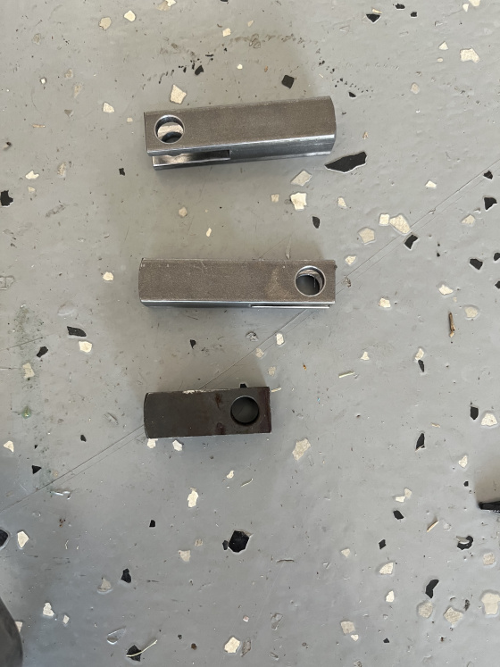

            The input shaft is about an inch shorter than the e30 booster and the threaded portion is shorter as well so I had them make a new clevis. It's about 1/16" too long but on the firewall it should be perfect. It's threaded all the way just like my original so I can shorten it a little if needed.
            Click image for larger version  Name:	IMG_1033.jpg Views:	0 Size:	137.3 KB ID:	10104676
            Click image for larger version  Name:	IMG_1034.jpg Views:	0 Size:	213.7 KB ID:	10104678
            Click image for larger version  Name:	IMG_1035.jpg Views:	0 Size:	201.2 KB ID:	10104680
