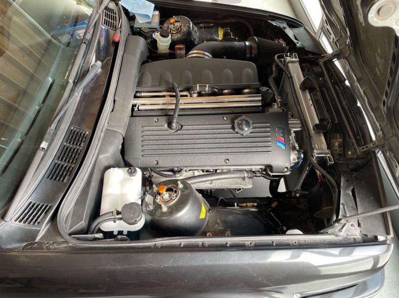

        Finally got the CRV adapter. It does the job perfectly and clears the S54 airbox. My only gripe is that you can’t buy these things new/used very easily. I’m working with a buddy right now to see if we can offer a remote reservoir solution for anyone wanting to pursue this.

            A couple of pictures from a friend locally who's been driving on the tesla booster for a while!

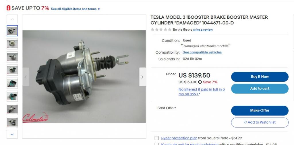

                Hey um, has anyone considered using the second generation iBooster?
                This fella:
                Used the second generation iBooster from the Model 3.
                On the plus side it looks like the MC outputs are on the left, so we can theoretically use the space better.
                However the reservoir is tilted, so one would have to swap that.
                He also recommends to get the Honda Accord iBooster for 2018 and up cuz it has a remote reservoir. But the MC outputs are on the right, so airbox space might be an issue.
                side note: I like his humor, also good info for noobs like me.
                Also I can't be sure to confirm the bolt pattern on the firewall.
                I found pictures on ebay, just not sure about the size and spacing between bolts.

                  2nd Gen bolt pattern is different and not a direct bolt in to the e30
