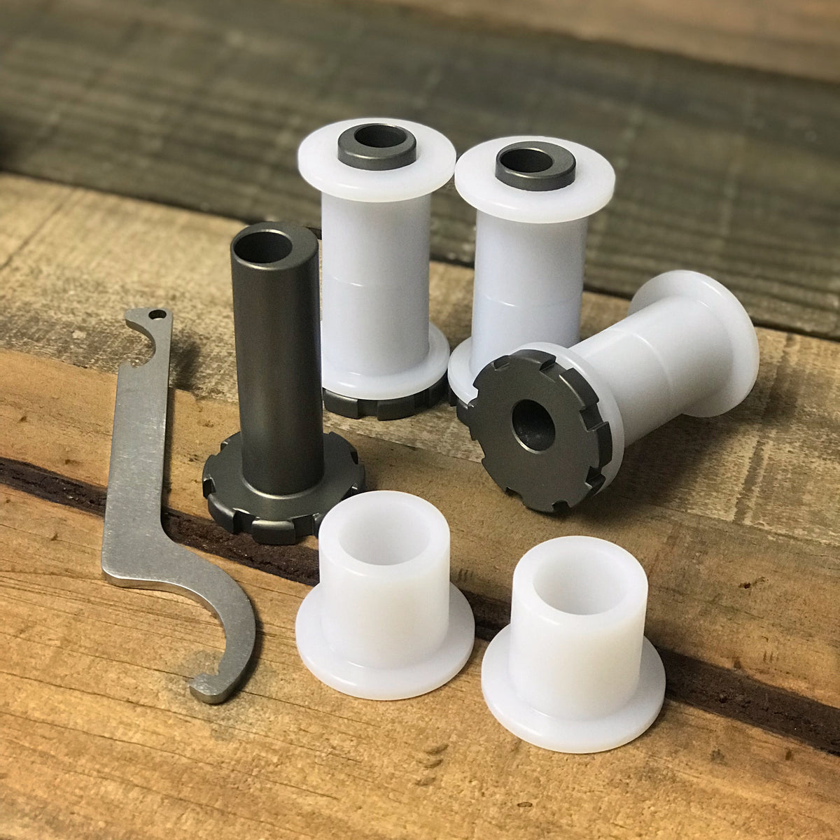

        CondorSpeedShop sales an affordable rear toe and camber adjustment bushing that does not require cutting or welding. So if you go low and you need to adjust toe and camber you can.
        Condor Speed Shop designed an Adjustable Rear Trailing Arm Bushing Kit made specifically for the E30, E21, 2002 & 318ti chassis. Easy Installation for those who prefer not to weld in toe and camber adjustment plates.

                  Before welding in camber / Toe adjusters get and alignment with your ride height that you want and see where you are. A lot of people just weld these things in and cant get into the range the need to. If you're going to run 4" spring in the rear, I'd consider shorten front strut housings.
                  I like the machined ones, if you go aftermarket RTAB, make sure the sleeve is steel and you have a good Genuine lock nut.
                  https://www.bimmerworld.com/Suspensi...-Z3-318ti.html
                  Check your front strut size before thinking they'll work. Early early cars had small front strut diameters.
