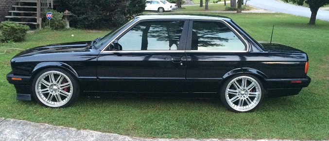

          Well, I must say, yours are only supposed to drop your car 1.6" in the front and 1.5' in the rear. If you change your tires, it should put your ride height where it's supposed to be.
          http://www.turnermotorsport.com/p-37...g-set-e30.aspx
          I'm using the sport cup kit which does 2.1" in the front and 1.7" in the rear
          http://www.ecstuning.com/BMW-E30-325...its/ES1303447/
          The only other thing that I'm using is the Condor Riser bushing kit and I think 10mm spring pads in the rear. No camber plates or offset RTAB.
          Also, 215/35R18 wheels. And my lip is lower than the s52 oil pan :)
          And it looks like this:
