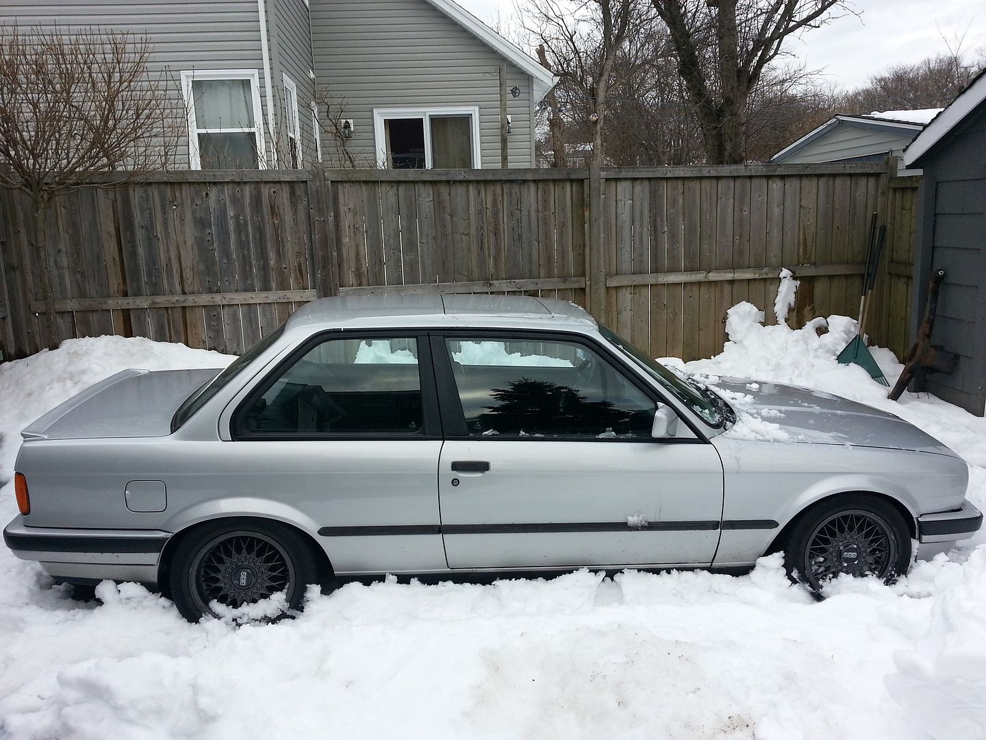

                Everyone says 205/55, but that severely limits your tire selection. 205/50 is close enough and opens up a lot more options, and is even what Spec e30 runs.

                  #38
                  OP wants to kill wheel gap.
                  Though I agree, 205/50-15 has much better options and is a better performer than the taller 55 sidewall

                    #39
                    Well, seeing he has wheels very common to Spec e30, and Spec e30 suspension, with a 205/50 his car will look very much the same height (and wheel gap) as a Spec e30 ;)

                        #41
                        ^ This.
                        Follow this list in order for teh lowz:
                        Buy proper tires
                        Remove spring pads
                        Drop hats OR Camber plates
                        Spacers
                        With all of that (+205/50R15), I should be around this height:
                        Just know that you'll run into suspension travel issues, especially with bilsteins.
