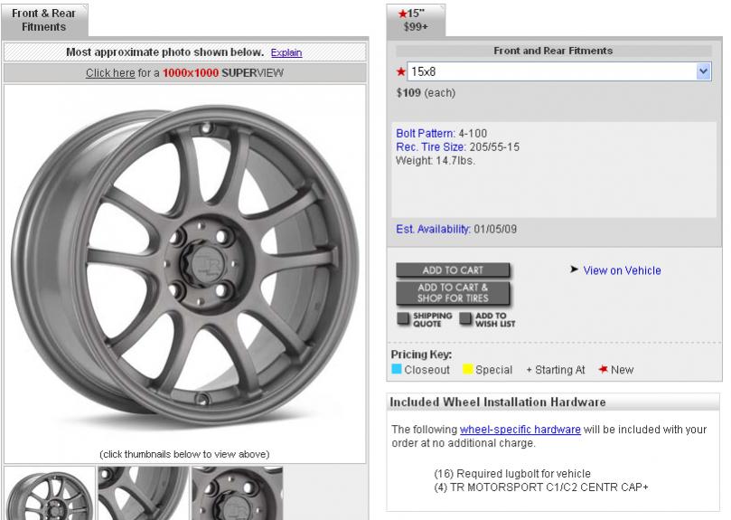

    What size tire for 15x8 TRMotorsport C1?
    Not sure of the offset since they're still not available AFAIK.
    Track only car with H&R Race and Bilstein sports.
    Tire rack system recommends 205/55-15 tire size...sounds a little narrow to me. But what do I know. What do the experts say?
    a 205/55 on an 8 inch wide wheel? sounds really narrow to me...
    Heres a 205-45-17 on an 8 inch wheel... Granted its not the same but still
    And if i'm off, please correct me
        Yea, not into the stretched look.
                  Basically, Tirerack will never list a tire size that will require fender rolling to fit. You can imagine the amount of angry, clueless customers they would have if they did.
                  225/50/15 is close to square on a 15x8. But it will DEFINITELY need to be accompanied by an aggressive fender roll.
