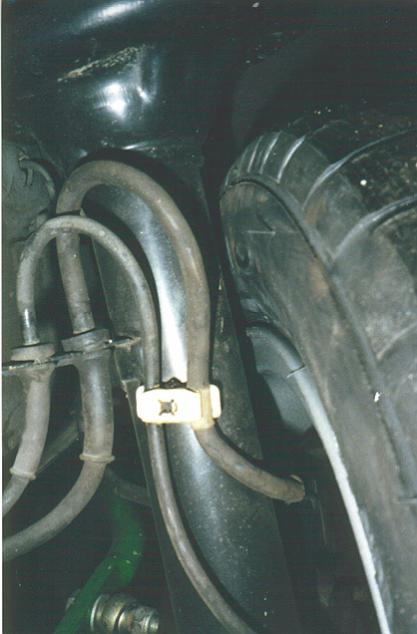

                  Originally posted by Stanley Rockafella
                  Taken from a thread I started.
                  Can I run 205/60/15's on a set of 15x7's with an offset of 27?
                  Suspension is totally stock. Car is 88 325is. I'm a little concerned with the tires clearing the front strut housings.
                  I'm looking to run them with no spacers (if possible) with no rubbing when turning, etc.
                  I used to have a set of 16x7.5 Borbet type C's that would scrape against the strut housings when cranking the steering wheel to the ends.
                  Those Borbets weren't scraping on the strut housing when cranked to the ends as the sidewall-to-strut tube doesn't change when turning as they both turn together. What was scraping was the inner rim on the end of the swaybar at full lock. BTDT.
                  If those 15x7 wheels are truly ET27 they will not rub the strut housings since the tube angles further and further away from the sidewall the higher up you go, but that tire is taller than stock and might be tall enough to rub the underside of the front spring perch so you might want to check into that further.
                  Here's a pic of the strut clearance of my Kosei K1 15x7 ET27 with 225/50-15 Kumho V700 R-compound tires. Note where the spring perch starts angling away from the strut tube above the tread - this is the dimension i'd be concerned about with a taller 205/60 tire.
                          thanks in advance.
                          They will clear the suspension fine. At full steering lock, it's likely they will scrub the inner chassis a bit. Nothing dramatic.
