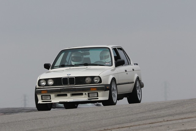

                            Originally posted by pandaboo911 View Post
                            Looking to change up my tires for more grip. Early model, 5 lug conversion. Front spindle adds 12mm per side. e30 m3 rear hubs are stock offset.
                            Rolled front and rear fenders.
                            Old setup:
                            F: 17x8.5 et 20 215/45 Hankook RS3 (fit with 2.5 degrees camber)
                            R: 17x9 et 30 225/45 Hankook RS3 + 3mm spacer (fit easily, no rubbing)
                            New:
                            F: 17x8.5 et20 235/40 Federal FZ-201S (adding 1 degree of camber for 3.5 total)
                            R: 17x9 et30 235/40 Federl FZ-201S (no spacer)
                            I've read that 235/40 will fit. Has anyone run this size square? How much fender gap?
                            I run both BFG Rival S slicks and Yokohama S Drives sized 235/40/17 on APEX ARC8 flat face wheels which have an et of 10. I run them square on a 1987 early with the liners pulled and the fenders rolled. With no sway in the rear it rubs a touch on the fender with the square edged BFG slicks, with the factory sway and oem sway bushings it has not rubbed yet. The S Drives have not rubbed at all. Fronts look like they should but do not.
                            Pictured with no sway in rear.
                            edit for suspension details; H&R race spings, Bilstein B36-2027 24-020275 shocks, camber plates
                            Click image for larger version  Name:	49741200706_b498258530_z.jpg Views:	0 Size:	38.9 KB ID:	9925611
