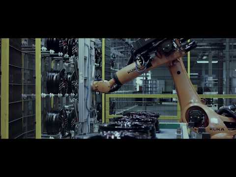

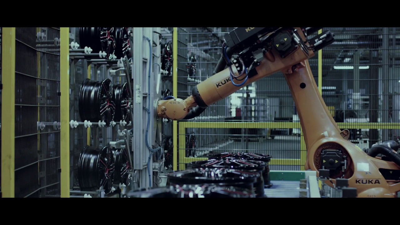

                Ronal is still in business, isn't it?
                Yes, it has factories in Poland, Mexico, and Taiwan.
                That's how it can supply relatively cheap wheels.
