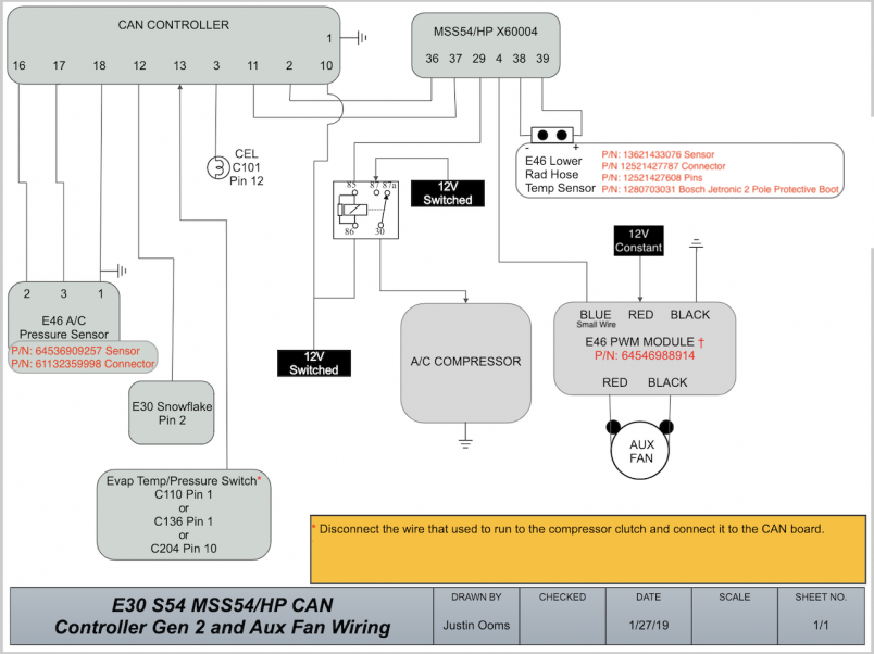

        I wrote up wiring for both: You have Gen 1 in your OP
        Gen 2:

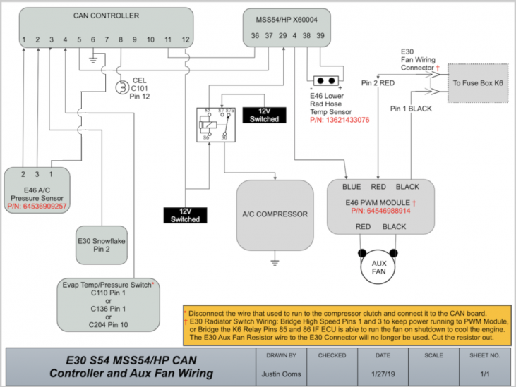

              I forgot I could just ask you lol. I had the Gen one then I had Gary send me a Gen 2 with the programming the same as the Gen one. The first picture with the white plug is my Gen 1 wiring, the second picture with the black is the gen 2 plug correct. So I should follow your Gen 2 wiring.
              • R3Z3N
                • Jan 2011
                • 3056
                ^Yuppers! Good luck. I have helped with ~40? of these installs now, so far the Gen 2 has been the LEAST reliable oddly. I hope your experience differs. I believe you have my number as well if you need to call, otherwise PM me. I rarely jump back here, but alas I still have a passion for the S54 project stuff. Maybe someday a 240z with S54 supercharger swap.....
