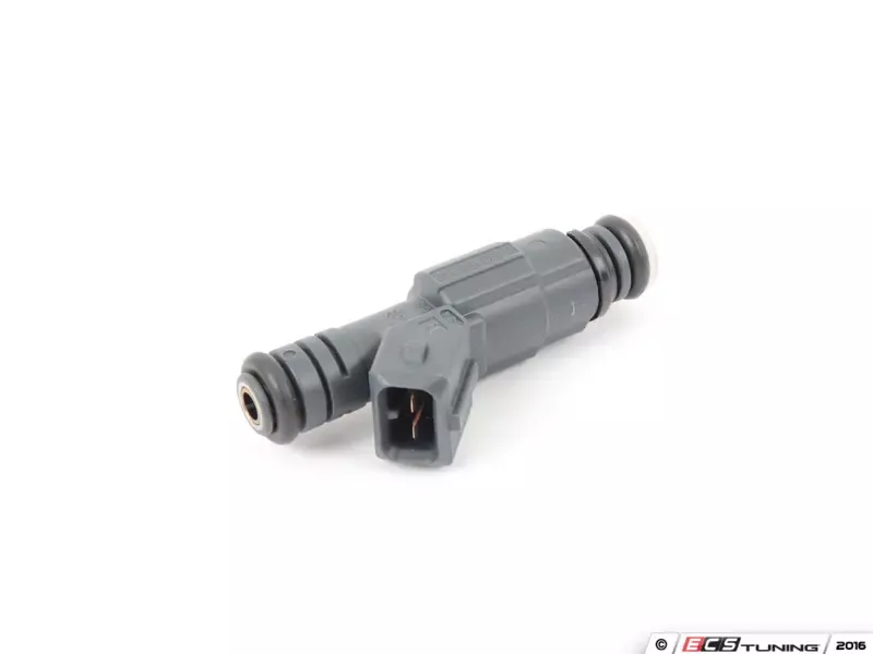

          Ecstuning has new Bosch fuel injectors, part number 13641731357​ (supersedes 13641466394). These have worked perfectly for my M20B25 motor. They were about $40 each but have increased now to over $60. Click image for larger version  Name:	IMG_0300.webp Views:	29 Size:	6.1 KB ID:	10097360
          https://www.ecstuning.com/b-bosch-pa...641731357~bos/
