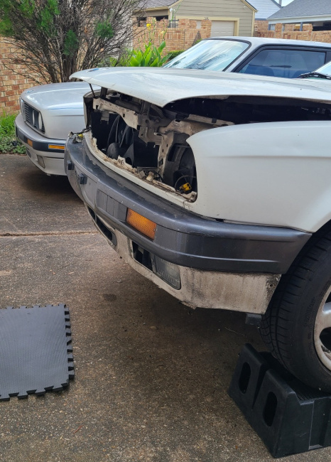

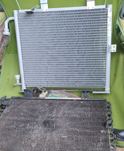

            Purchased a new Nissens parallel flow condenser. Where the old Nissens I bought years ago was just bare aluminum, new one has what looks like an e-coating. Inlet/outlet connections are still floating and not braced. Fan mounting brackets are revised. The base bracket of the condenser that sits on the rubber bushings is still bare metal. I'll give it a coat of black paint. Will see how well the stock fan fits sometime next week when I pull my old condenser.
            • uturn
              • Dec 2010
              • 1001
              Had the car up on ramps and was able to slide everything out the bottom front. New Parallel condenser in with stock fan and everything blows cold.
