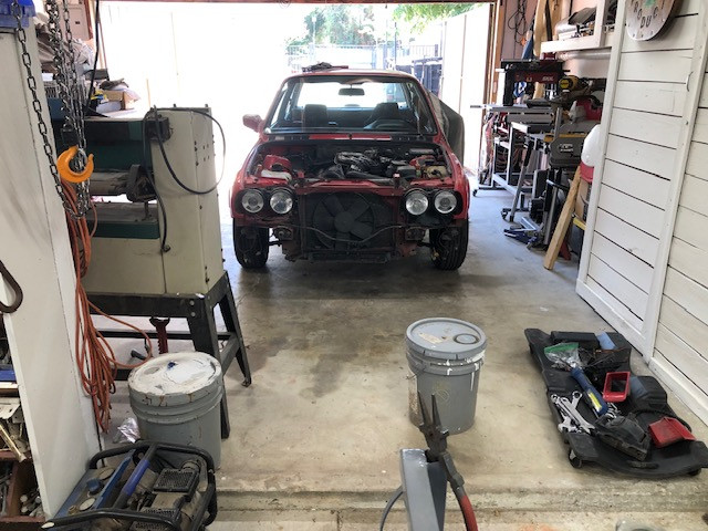

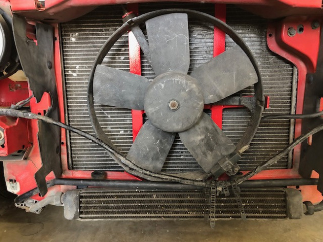

                • OSAH racing
                  • Apr 2022
                  • 244
                  I used steel strap, OEM bushings and the top holes in the frame.
