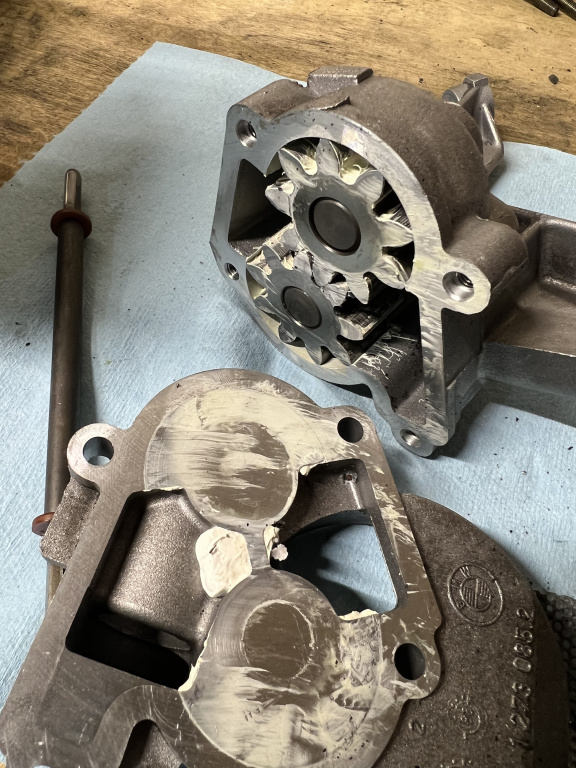

    Hi there!
    recently had my engine rebuilt by someone I’ve lost all faith in. Been going back and double checking his work.
    Pulled off the oil pan and saw how dirty the oil pump still was, so I took it apart and found the gears caked in grease.
    I couldn’t find any posts/documentation recommending this as part of an M20 oil pump rebuild procedure.
    just wanted to verify: grease or no grease on the oil pump gears?
    thanks!

        Looks like some marine grease. This is first time I see anything like this. Engine oil should to the lubrication.

                  That looks like a lithium grease which does not breaks down with oil well. Now one can use a lithium grease mixed with ATF as an assembly lube in a pitch. However good and sticky assembly grease is the way to do it. In any event, good manual priming of the engine is all that's needed to lubricate the pump as well get the oil gallery and everything full of oil for that first start.

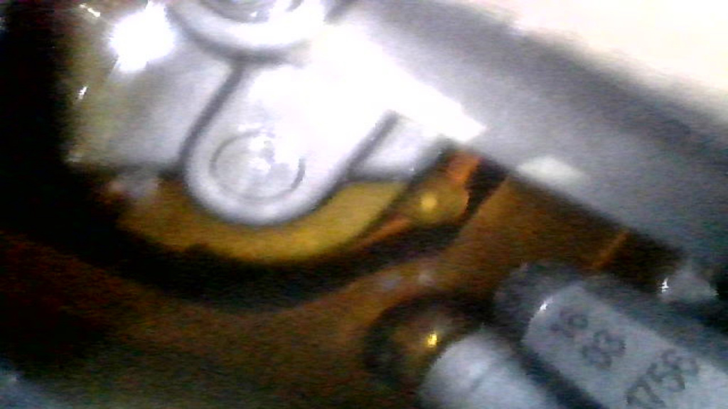

                        Here is a picture of the pump with oil at 1/2 dipstick. As you can see, pump gears are well submerged in oil. was priming new motor so figured I'd snap a pic with my borescope cam for you all.
                        Click image for larger version  Name:	IMG_8312.jpg Views:	0 Size:	157.6 KB ID:	10129621
