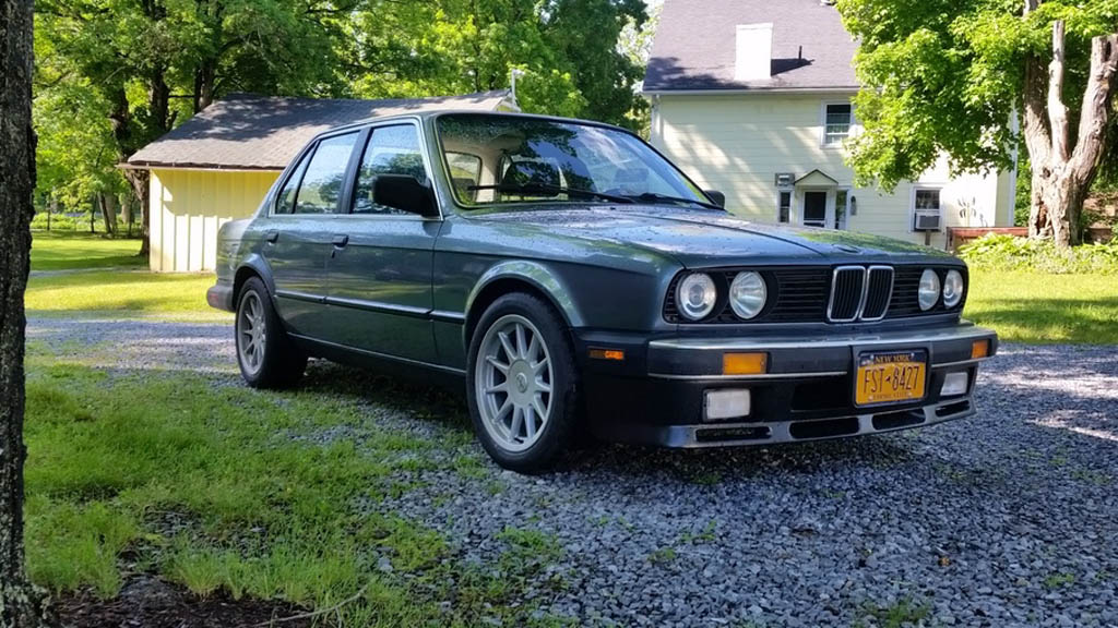

            On my 87 325i daily, I've run Sports and Koni SAs (not a Bilstein guy) for over a decade in the Northeast. It's a great setup. Not uncomfortable, not too low to drive around and worry, never needed a skid plate, etc. I'll post a photo of the car here.

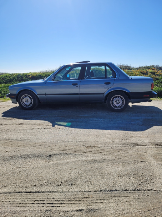

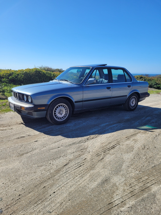

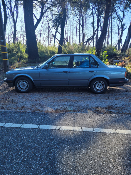

              These are OE sports in the front of my car, haven't got around to the rears yet. Koni SA's, GC touring plates. For myself I was actually surprised how much lower it made my car than stock, at least 1". However the weight of a skidplate, steering cooler, subframe reinforcement and a strut brace were all added at the same time. I wouldn't want the car any lower, first drive I scraped the skidplate leaving my driveway.

                  As far as I know the rear spring/pad setup is stock with bilstein dampers, the springs are just way sagged.
                  In the front I am using stock lower spring pad and upper spring pad but I remember the upper one seemed slightly thinner than the old one I removed, but not much. I expected the front to sit about .5" higher but I probably lost that due to the weight I mentioned. I would be working on the rear but stupid CA smog test failed me on the evap test (passed inspection and sniffer).
