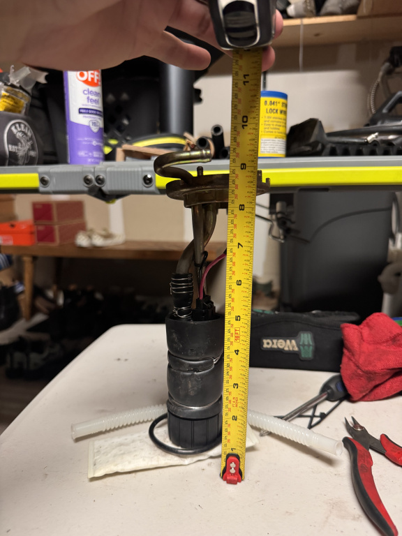

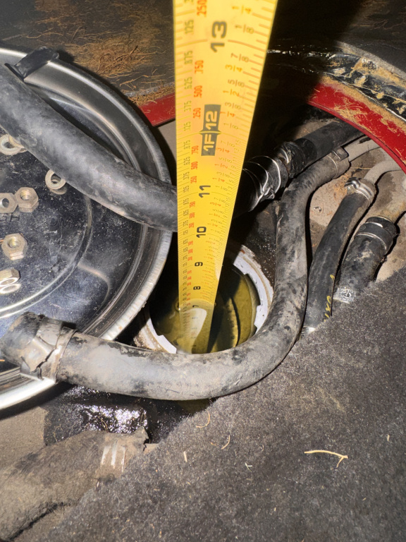

                          Finally got around to doing this, noticing on my car I’m having trouble getting the pump to sit high enough on the hanger to not fit the bottom of the tank. Anyone have pictures of how they did this on an early model? Seems like I might have to cut the hanger pipe off above the weld to the return just to get it to fit.
