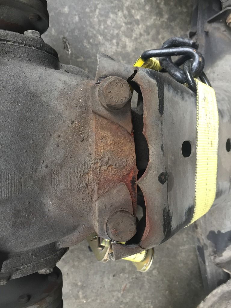

    We did fracture analysis in uni (engineering) and what i took away from it is that basically any metal under load (especially fatigue load) is susceptible to cracking, but the crack needs somewhere to start. The start is usually a microscopic defect buried deep in the grain structure and over time it gets bigger and bigger. You can minimize the likely hood of the defects using various post processing techniques (heat treatment), but for a subframe i highly doudt this is done. The part is just stamped out, welded up and sent on its way.
    Gotta remember we are coming up on 30+ years of these steel items being in use, potentially millions if not billions of load cycles. Its no wonder cracks are starting to show, but similarly its no wonder there doesn't seem to be any method to whether it will crack or not, luck of the draw really. not to mention possible "high load incidents" (ie crashes) over the life of the car potentially causing cracks.
    I must admit i've never had any of my cars subframes cracked, but then again i've never really looked to hard either. Mate with a JZA70 supra found a few cracks in his front subframe, simliar to the photos above showing cracks around mounting holes etc.

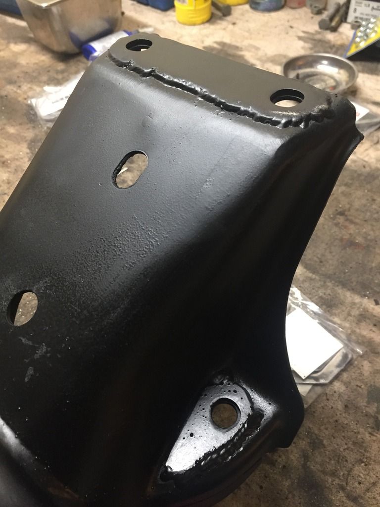

      Well I'm still alive guys.
      The car is in the garage. I'll start the work on it tomorrow. Got the subframe from MR2peak and my order of stuff from Gargastic should be here tomorrow so I can start welding and putting new bushings in. Sadly my coil overs from Catuned won't be here for a few more weeks so I'll have to get two alignements. Oh well.

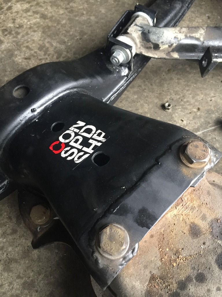

              Fork it over guys! Im still alive and the car is fixed... Well ok it still has completely blown shocks on all four corners, but I just need my coils to show up in the mail.

                Looking good! SO glad you made it alive
