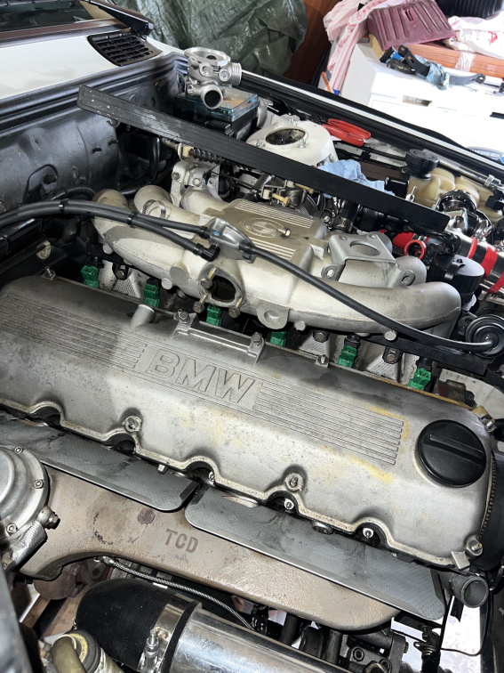

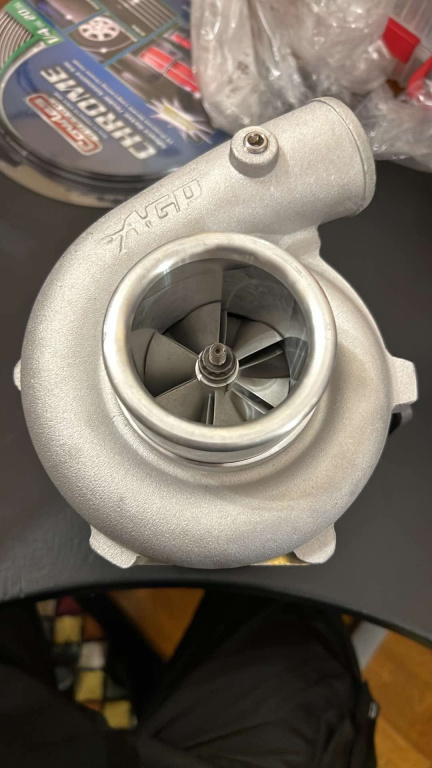

    Hey everyone,
    It's been 2 years.

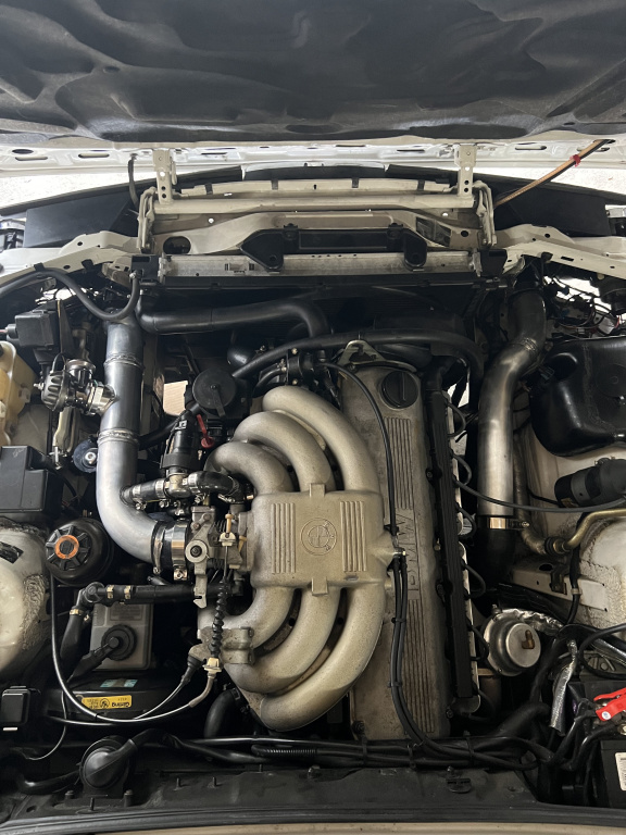

    I go back and forth between the US and Canada so I brought my turbo to AGP Turbochargers in Phoenix, AZ and had them build me a new turbo using the same on-center exhaust housing. I brought it back up to Montreal, installed it, and the smoking issue has been solved!
    I've also replaced the 30lb red Bosch injectors with 42lb green Bosch injectors and put in an 8.7psi wastegate spring to replace the 7.3psi wastegate spring. No clutch slippage and no issues with the Permatex holding my ICV bung onto the cold side charge pipe, so I think I'll be keeping it at this boost level.

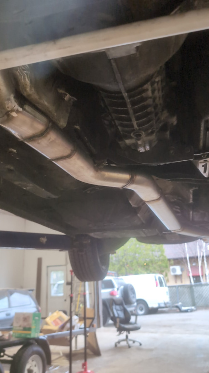

    I had ground clearance issues so I had a friend weld up 3" oval pipe from front to back with a Borla Pro XS muffler.

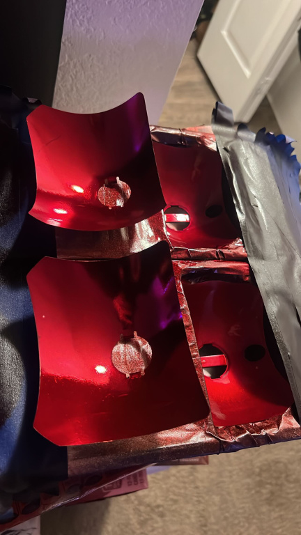

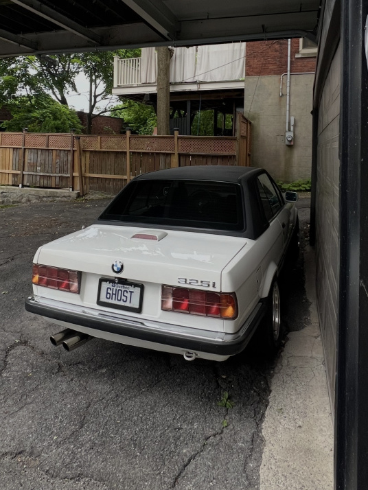

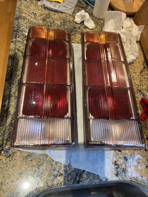

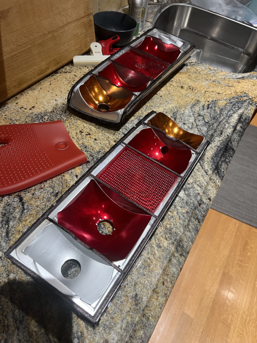

      Last year I decided the rear looks too stock, but I didn't want anything looking era-incorrect, so I took it upon myself to make some custom Startec taillights for myself. Definitely a labour of love. A friend of mine gave me his old broken-lens taillights, I tore the lenses off, disassembled the housing, painted the reflectors, ordered coloured bulbs, sharpied the edges, sanded the edges of the ebay champagne lenses to fit the housings better, and used black Permatex Ultra Black to seal the lenses to the housings.

              Glad you got the oiling issue sorted. Did the rebuild shop tell you what was wrong with the old setup?
              Nice attention to detail roughing up the charge pipes. They look good.
                    Appearance mods are adding up too. Going to need sunglasses with all that chrome shining.
                    Failing seal on the turbo! Also thanks on the charge pipes. I’m debating on doing them in flat or wrinkle black. I’m happy with the look now and think I’ll be keeping the exterior as is from now on.
