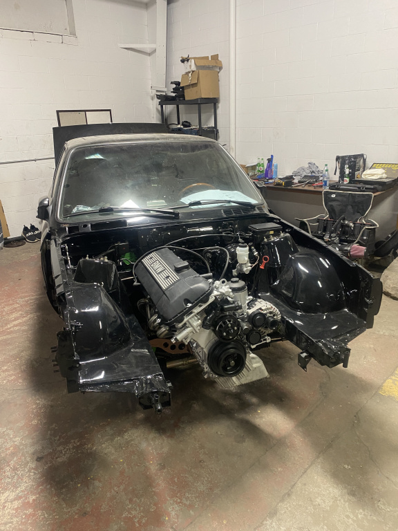

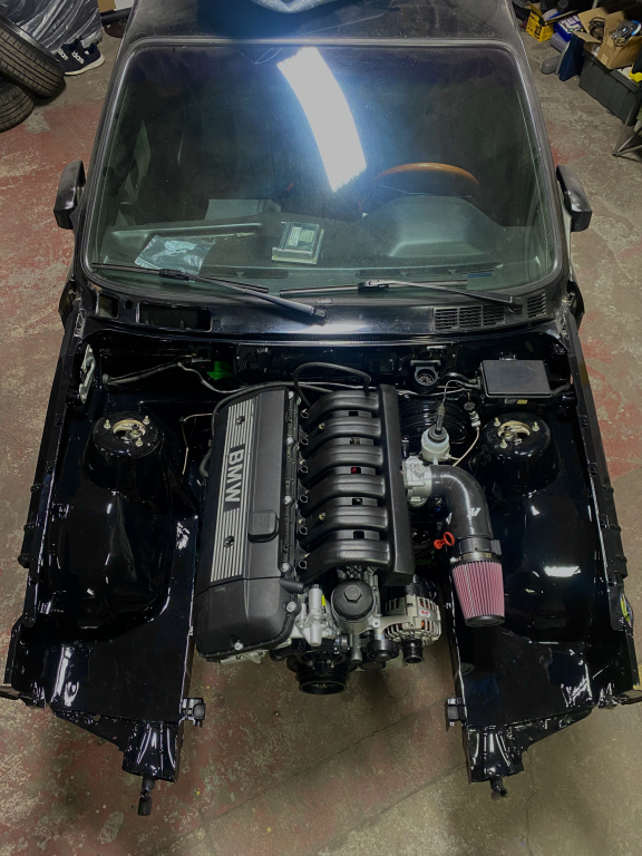

    SHE'S IN!!! this was such an exciting moment! Crazy to see how far it's come since November!

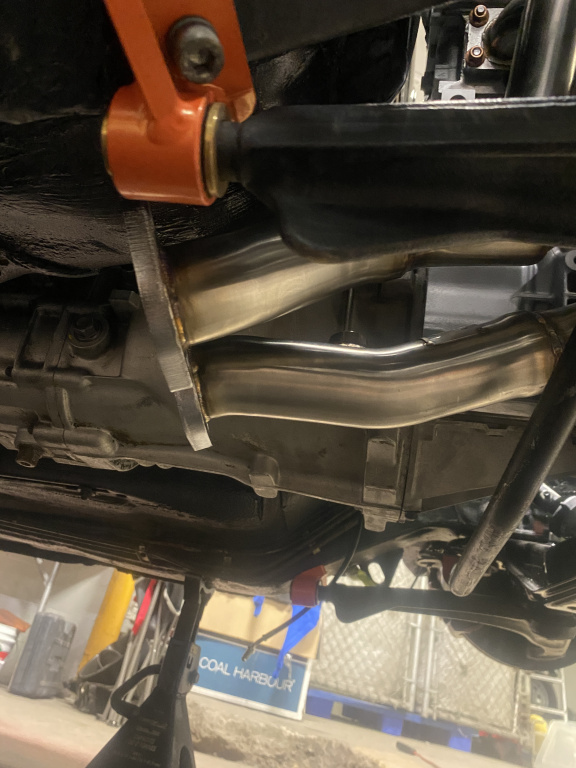

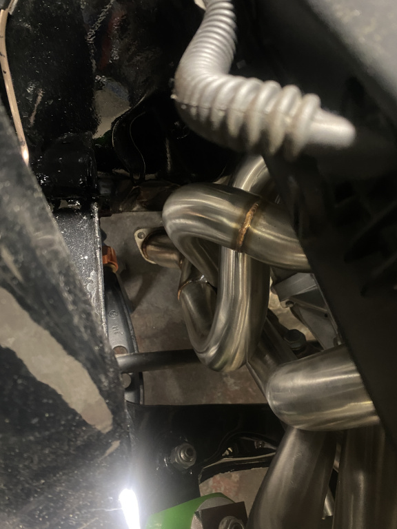

    Pretty surprised how good the headers lined up, clears everything
    Besides being pointed downwards a little, they are perfectly positioned, although we're not keeping these flanges

    Enough clearance everywhere and to my surprise, more than enough room to remove them in the car!

    Couldn't stop staring at this !

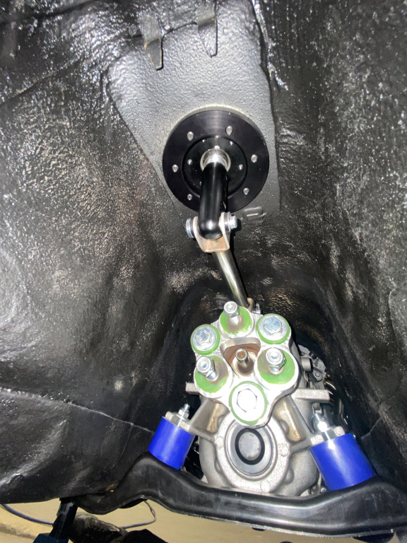

      Garagistic chassis mount shifter installed with DSSR. super simple setup!

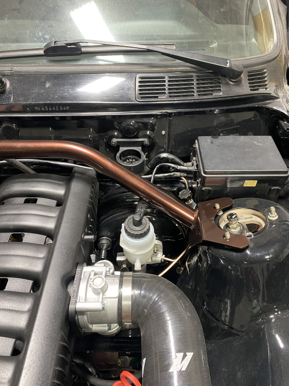

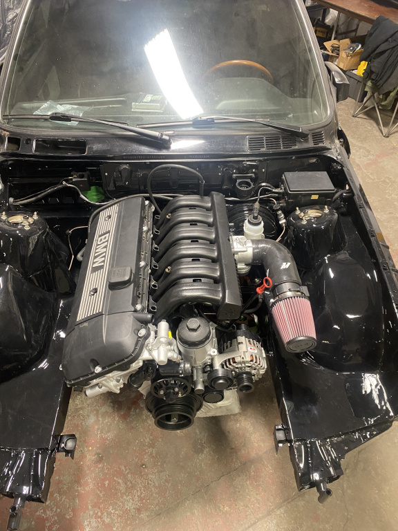

      M50 Intake on. small issue with clearancing the booster. didn't think this would be an issue with the X3 booster

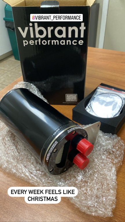

      Vibrant catch can acquired. Didn't realize how big this thing was

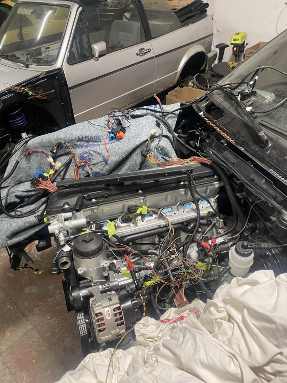

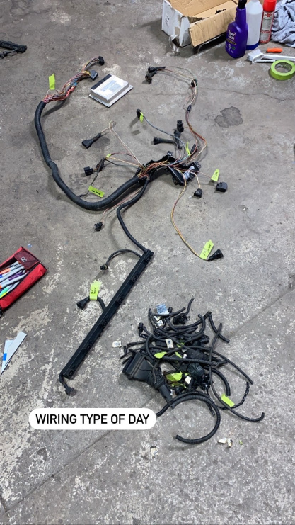

      Got started on wiring. stripped all the old sleeving off to verify all the wires and clean it all up and replace the sleeving

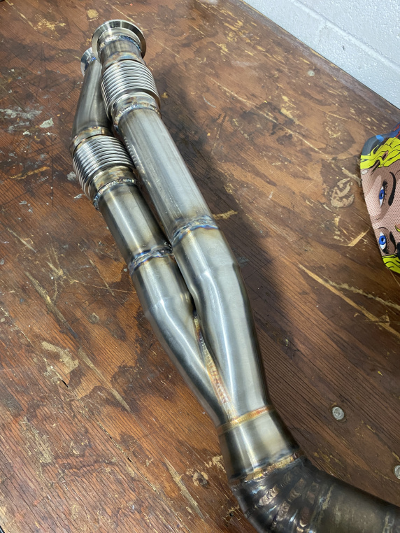

        Exhaust pieces picked up! going to look insane

        Powdercoated my strut bar to match other accents on the car! love how it turned out

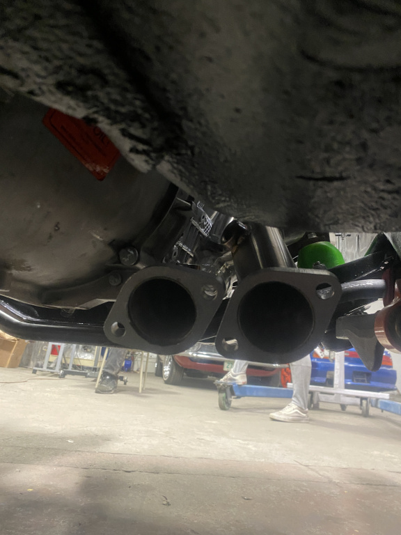

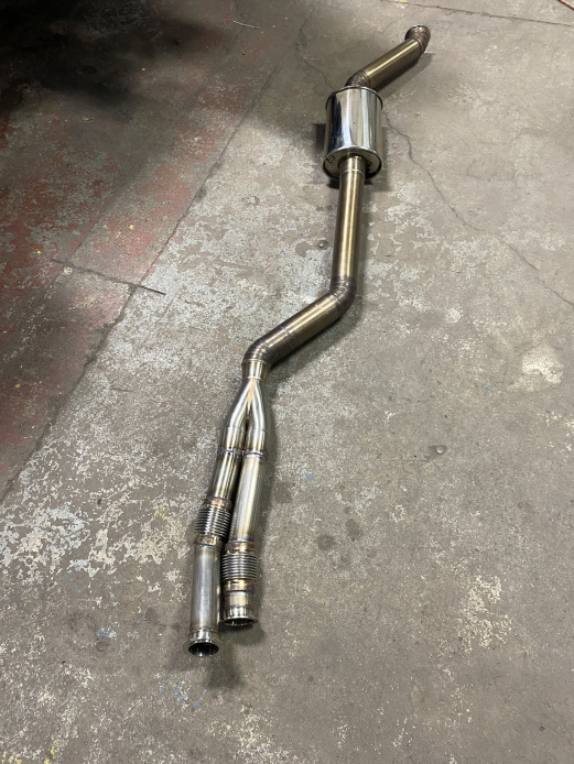

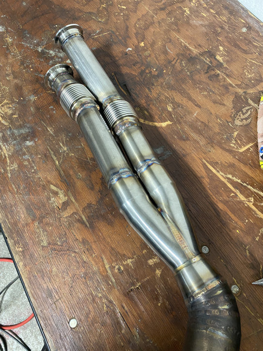

        Got my welder to come weld up the pieces to my existing stainless line to match the headers
        He did an amazing job with the tig welds

        This is going to finish up the underside of the car so well

        Full midpipe section all done up

                    Got super lucky that my welder buddy wanted to practice making a custom exhaust🙏🏻 definitely wouldn't have been able to get such a nice job without that

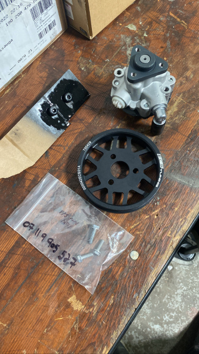

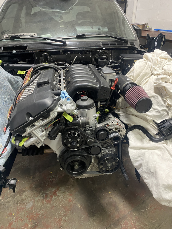

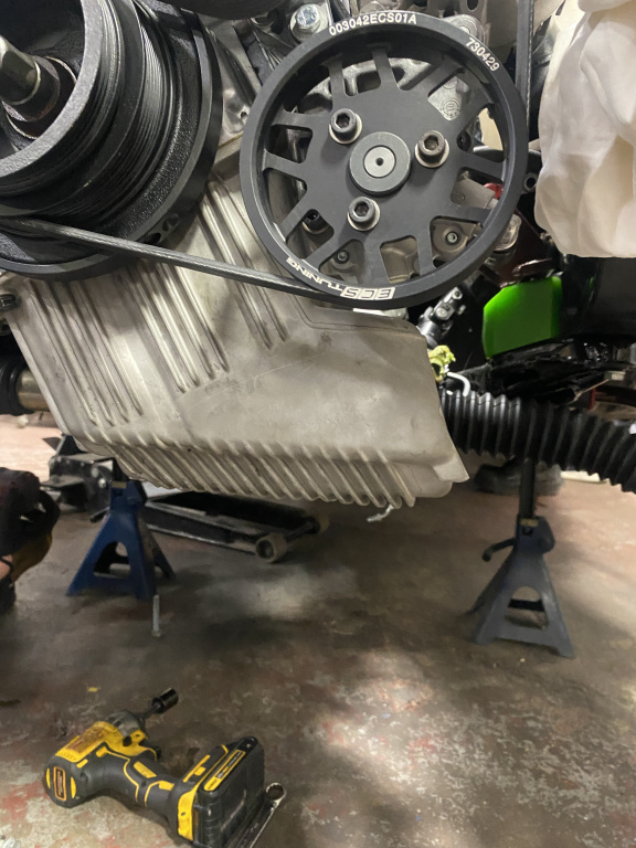

                      Finally found a bracket for the P/S pump so next was to install my new pump and aluminum pulley
                      Pump, pulley and belt installed!

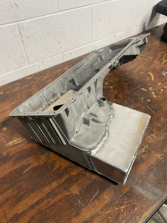

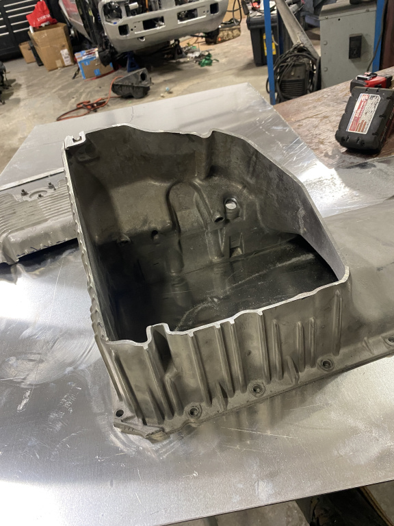

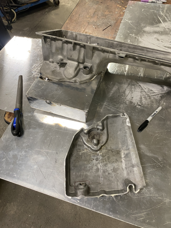

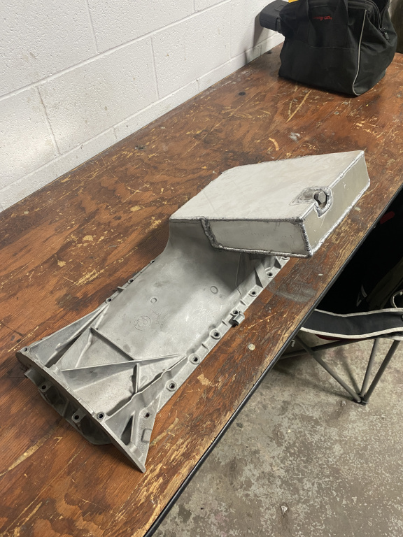

                      The internet was right and the pan hangs wayyy too low...
                      Click image for larger version  Name:	713.jpg Views:	0 Size:	199.3 KB ID:	10094704
                      Chop Chop! no going back
                      Didn't waste any time

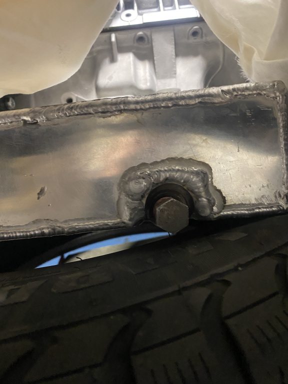

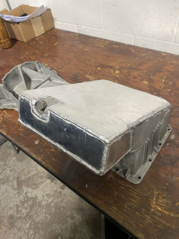

                        Boxed section to retain oil capacity
                        OEM drain plug retained and rewelded
                        Pickup tube shortened as well
                        All welded up by the same guy that did my exhaust! Welding pure aluminum to the cast pan was definitely a challenge
                        1989 BMW ​325i - M54B30 Swap in Progress

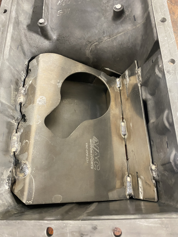

                          VacMotorsports baffle shortened and welded in it's original position
                          Closer look

                                Pretty happy to see that after all the modifications to the oil pan, the capacity remains exactly as OEM from dry! So I can still rely on my dipstick

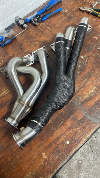

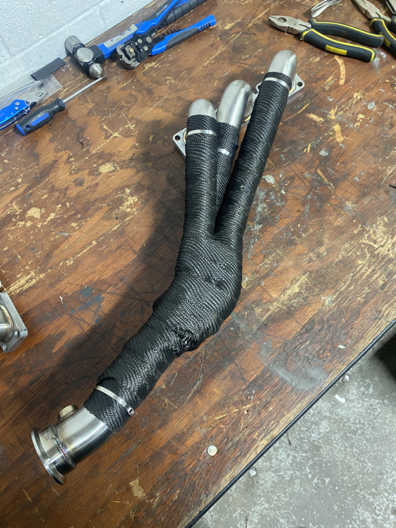

                                Got some heat wrap for the headers since they pass very close to the engine mount arm, subframe and swaybar
                                Did this to help with heat transfer but still wanted to leave the top expose since they're beautiful headers
                                I know I know, would be more beneficial to wrap them all the way but oh well!

                                Ran out of wrap for the second one, but happy with my choice of the black wrap!

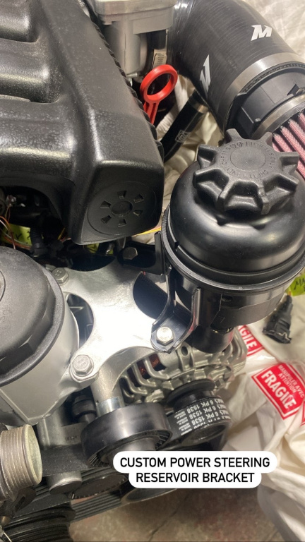

                                P/S reservoir no longer fits in its place with the M50 manifold so had to make a custom bracket to hold it
