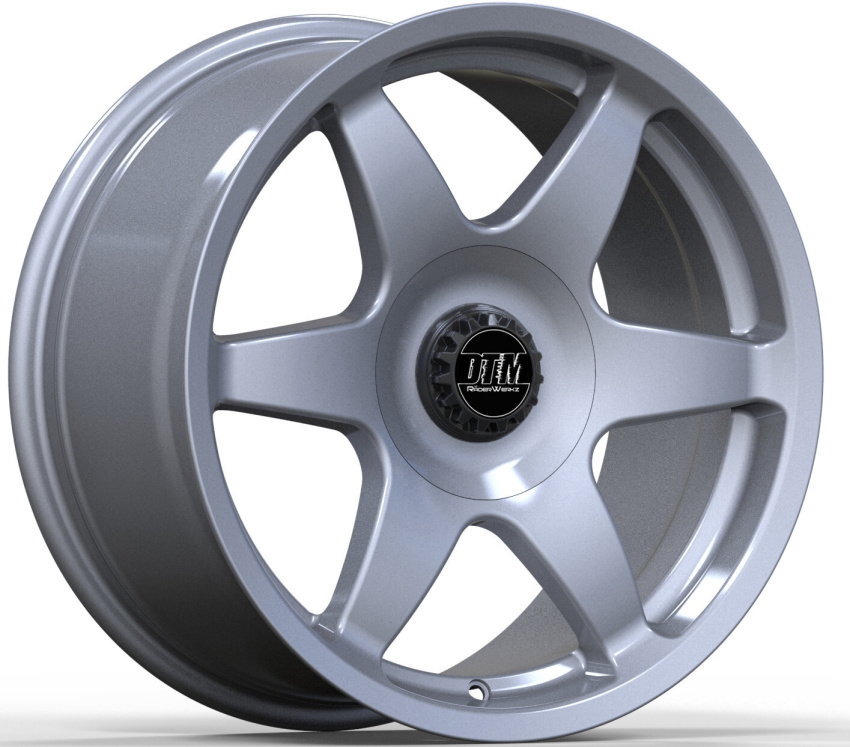

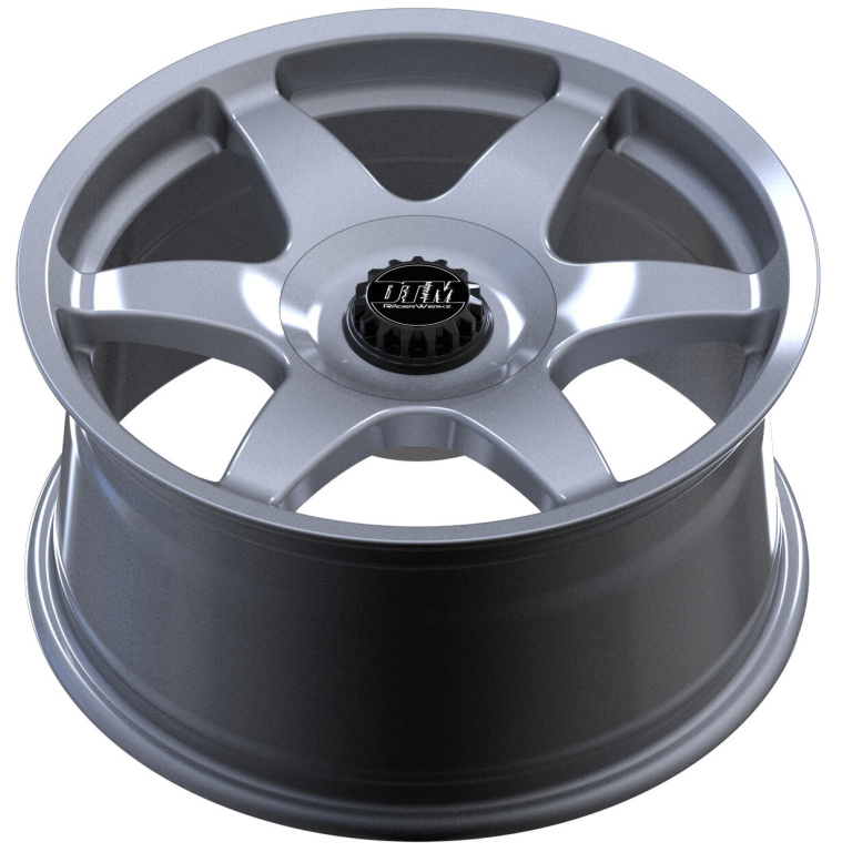

          Let me show you what I came up with.... drum roll, please - tum tum tum -
          DTM Raderwerkz DTM RW-03 in silver - 17x8.5, 4x100, 57.1 cb in stock and will be mounted on Yoko's 235/40/17 on all 4 corners.

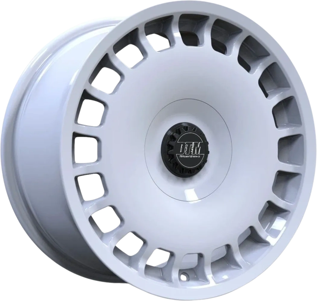

          DTM BMW rally wheels Porsche VW MBZ 4x100 4x108 5x100 5x112 5x114.3 5x130 in 16x8 17x8.5 17x9.0 17x9.5 18x9.5 18x11 Widebody fitment Forged Flow Formed Alloys
          Click image for larger version  Name:	s-l1600-17.jpg Views:	0 Size:	175.9 KB ID:	10150695 Click image for larger version  Name:	s-l1600-18.jpg Views:	0 Size:	160.7 KB ID:	10150696
          I almost always use a staggered set of wheels/tires - even on my 1981 MB station wagon... but - after seeing a video of a turbo e30 bottoming out with 3 guys in it - I opted for 17's which are not unusual, but also for this 'safe' size tire vs. 245/255. It is important for me that if my son's first car (we'll see about that in a couple of years, won't we!?!) is an old European car which may not be all that practical, that it still can be used/abused/enjoyed and bottoming out or having mechanical problems are not issues I want him to start with!

            I like the wheel style, it will look just right on a white m3 body. 235 will be a little wide for the front. It's possible to fit, but you will battle some clearance issues and may need a travel limiter kit. What offset did you get?

              I like the wheel choice, I had envisioned these wheels when I was dream-building it...

                Originally posted by kronus
                welcome! I was watching this auction and it looked like a well-built body. Glad that we get to follow along with your journey.
                You know? The owner of DTM Raderwerkz - Ary - who is a very likable individual - told me that the purpose behind this line of wheels ( several of the offerings at DTM Raderwerkz) was primarily designed to capture the spirit of BMW DTM-era M3's... Although they sell them in white also and sure white ones would look good on a white car - most times, colors/shades do not match. With them in silver, I can always apply some type of removal finish color if I want a change - but, they ought to look great in this color (have not been able locate a single image of an e30 M3 with them)!
                Until your post, it never dawned on me to consider getting a narrower set of front wheels such as a 17x7.5 or 17x8. When I looked into tire sizes for the 17x8.5 wheels, there was a mention that a 225 sized tire was right on the border of not big enough for the wheel - so, I opted for a 'safe' square setup that all 4 corners have the same sized tires at 235/40/17's. But, last night after your post, I went back to the DTM website and saw that 17x8.5 is actually the smallest (and ONLY) sized wheel they sell for this series! So, I am hopeful and optimistic this wheel and tire combo doesn't present any clearance issues, as it would be quite a step back to have purchased them and then later find out that they are not compatible or a straightforward swap/install... When I bought an S123 MB wagon with 16inch AMG Pentas last year, it came with 225's on all 4 corners but didn't look right. I made the fronts go down to 205 tires so they wouldn't stick out as much and then got 245's for the rear conservatively - as there is even more room there. However, your post got me thinking that I hope its no big deal installing the only sized 17x8.5's up front (on the 235 tires on a small car) as I am unable to return the tires once mounted... We'll see what happens. The et is 20 - which again, is the only choice offered for the 4x100 bolt pattern and 57.1 bore that my car came with from the factory.

                    people definitely fit 235s and 8.5s up front, it just takes some attention. you will likely want to roll or clearance your fenders and check for interference elsewhere.

                      Did Ary split ESM and DTM wheels based on rep/non rep stuff or something else? Didn't even know of DTM wheels, but the ESM site is still up so I assume they're both live.
                      I had some old ESM-007 (fake CCW classics) and they were good, just heavy and 16s so tire options dried up. I like those "RW02" basketweaves a lot.
                      I think a square setup is the way to go, both wheels and tires. Then you never have to worry about finding a tire in e30 diameter that's available in front and rear widths. Probably less of an issue with 17s, but I still don't think it's worth is.
                      With the non-M suspension, you're probably going to need a front spacer for those wheels. 17x8 ET20 is a gamble for strut clearance (Depending on how 20 that "20" actually is) so I'm pretty sure a 17x8.5 is going to need something.
                      I don't think there's any issue fitting 225-255 on an 8.5. Maybe even wider if the tires run narrow.
