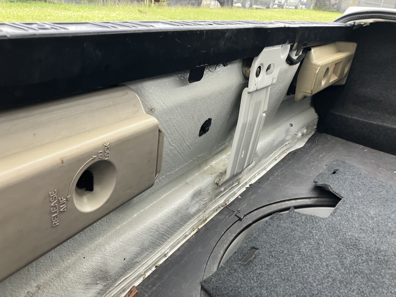

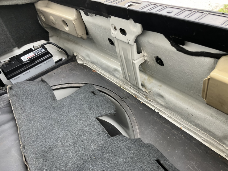

      Originally posted by OttoB
      This is the gas cap area and I don’t see anything?
      Disregard my other post, you likely don't have central locking.
      You would be looking for the black plastic part in the bottom left that has a rod that can come out to lock the fuel door by sliding into a little protrusion in the fuel door.

        it's a grafted on widebody, it's likely the cap lock wouldn't have been carried over.

            Although my 85 323i had central locking, I don't think it was standard on Euro cars. Sucks if this is the case here. Good point about the widebody. I guess the sure way to tell would be to look for the trunk and gas cap actuators inside the trunk behind the carpet panels.
              No ABS either… so this was a basic e30, which is to be expected when they used a donor car to build this one up around 2020.
              So, are either of the links off eBay that I posted earlier today good for the car to take car of the locking system on the car? Which one - door no. 1, door no. 2, or mystery on who knows what in door no. 3, Bob? A package like the ones offered is great, since the key is there as are the tumblers, door locks, trunk, etc.

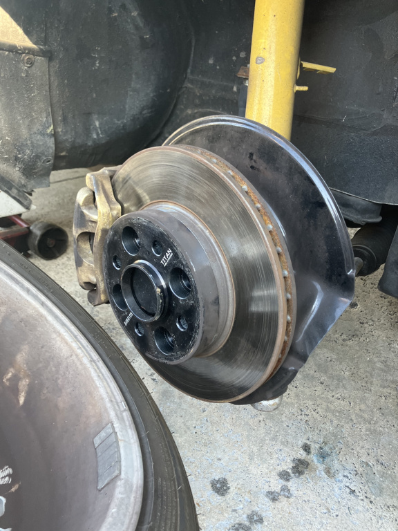

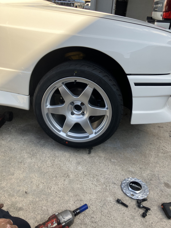

              On another note, they could not install the wheels. The car came with what seems to be 1 inch spacers which I had no way of knowing before taking it there to them. So, the existing bolts are too long and I have to get regular, standard sized ones instead!

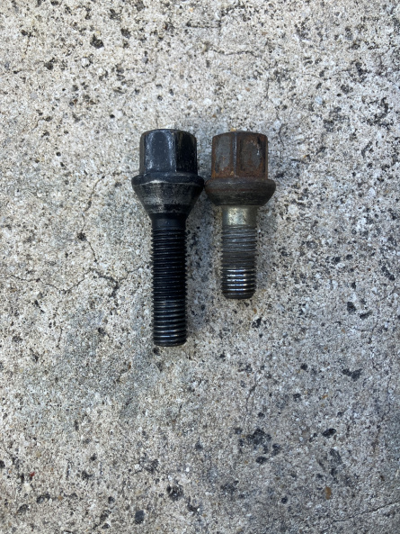

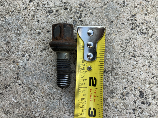

                As I tell my wife on a daily basis - Google is Your Friend! Found this snippet on what new bolts to get in order to replace the long ones that are on the car due to the 3/4 spacer:
                • Older Compacts: E30 bolts (M12x1.5) can fit other older BMWs like the E21, E36 (non-M), E46 (non-M) if they share the same 4x100 pattern and are used with appropriate wheels.
                So, I then quickly souurced them off eBay brand-new when I typed up e36 instead of e30, and presto - found 20 of them brand new for less than $30 shipped. The car will sit at the warehouse until the new regular-sized bolts arrived. Here are pics of the interior after it got some lovin' yesterday - cosmetically, the car is in surprisingly in very good shape and it definitely has been stored indoors for the past few years!

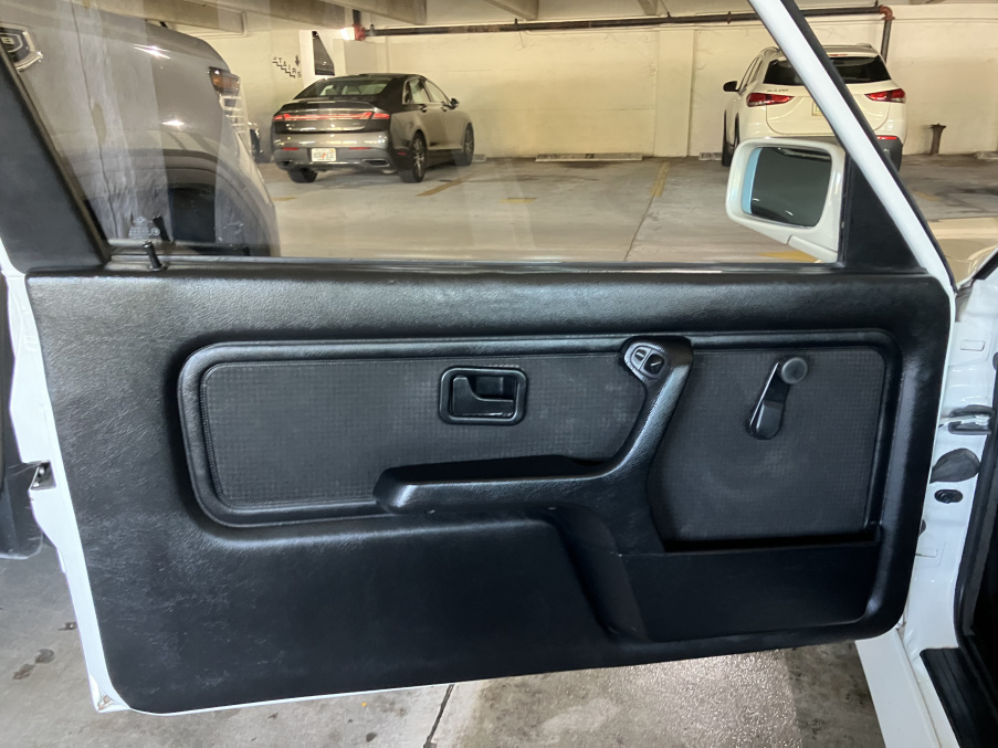

                Please help a brutha out - the car does not have power locks, steering, windows, ABS, etc. The door locks do not work with the ignition key which is what the transportation company delivered the car a 2nd time with. The rear trunk lock is completely busted when they attempted to remove the broken piece of key. So, am I looking at this one then from eBay or what?

                    we can't really tell you conclusively, because we don't know how this car was equipped.
                    it's hard to tell if the central locking isn't working or straight up doesn't exist, without doing some inspection. as mentioned, the easiest thing to do would be to pull the trunk panel that's under the taillights, and see if there is an actuator (red/tan plastic thing about the size of half a pack of cigarettes with a rod coming out of it going to the lock). If there is, you have central locking. If not, you don't.
