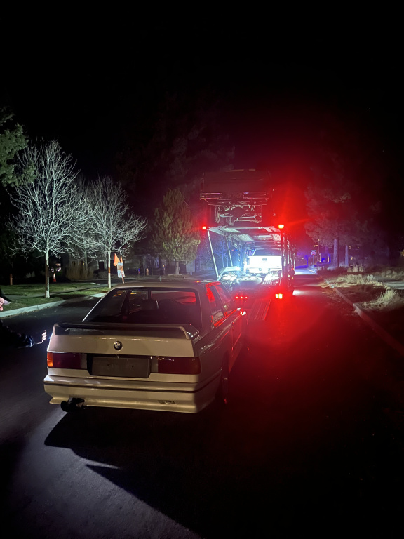

ID:	10151171 The car was finally picked up last night, so it should arrive next week and I can take a closer look at everything. As it is, however, I’m never truly happy leaving any car I get ‘as-is’ from the previous owner. So, whereas the builder back in 2021 installed these smoked lenses, they’re just not for me (nor more importantly - the wheels)… Mind you, elsewhere in this thread I posted pics of me having tinted the lenses front and back of my 850 - but, not into same on this e30.
              I appreciate everyone’s feedback and support, since you all know infinitely these cars in + out!

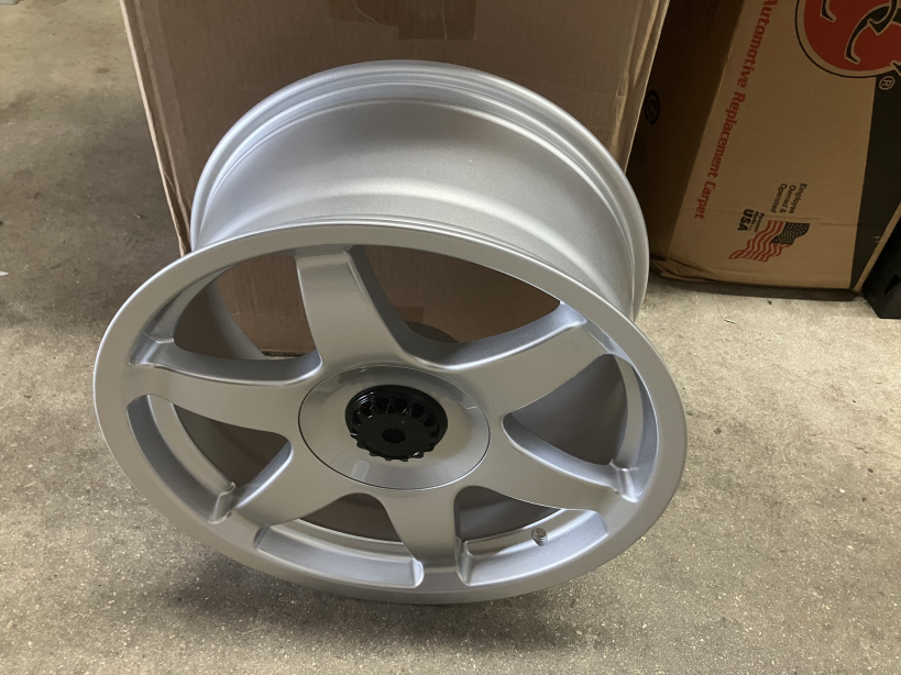

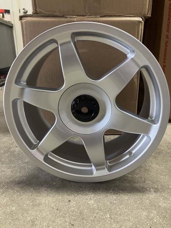

                                Wheels arrived 2 weeks ago, but got tires the other day and I needed to check both out at the tire/alignment place. I ended up buying the set of 4 Yoko 235/40/17’s from eBay vs. Tire Rack after buying the same exact size for the rears (along with new, smaller fronts for the GTV-6) 3 months ago from Tire Rack, but each tire had gone up like $45 for no reason since then. On eBay, it’s luck of the draw but saved more than $175 for same new tires and date codes are from 2023 onward.
                                e30 arrives this week. I called Run Buggy first thing Monday morning for an ETA and was told to wait until later in the day. Car was picked up last Wednesday and I was told it would arrive 6-7 days later (tomorrow). Called Run Buggy 7 hours later (this evening) and still no info available. Not expecting to arrive tomorrow but such bs where there is zero justification for the driver not getting back to dispatch. Had something similar happen expecting delivery over this past 4th of July - it sours the experience because these aholes think it’s funny to keep things to themselves and then surprise you last minute.
