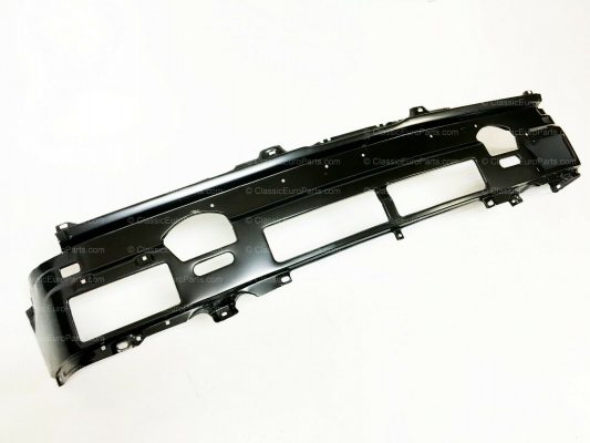

                Austin - they DO tickle me. I don't know that his budget has that amount of tickle in it...one more year of school....
                Also, I think the '86 steel valance is a different shape from the very early car, isn't it?
                I was looking at this one vs shipping a rusty one from Europe....
                Has the front air vents, fog light holes lined up with the turn signals, and the right holes for euro bumps. We have the plastic lip with the oil cooler vents. The steel valance has been pushed and tweaked out of shape - prolly when someone in the 80s mashed the cowcatcher and replaced it with the IS version (which we sold).

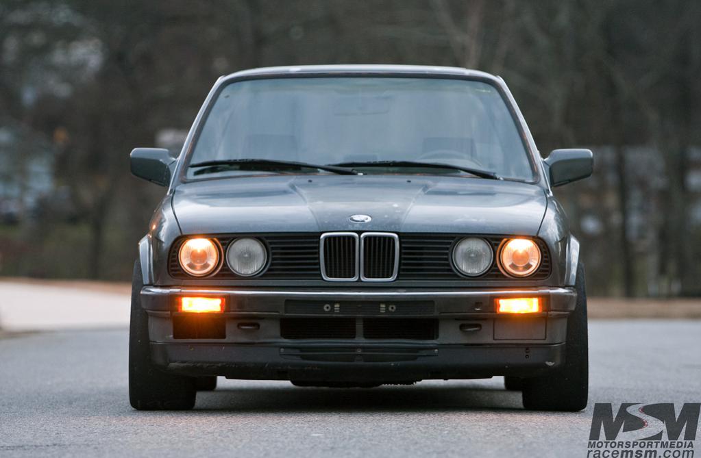

                      Like so.....

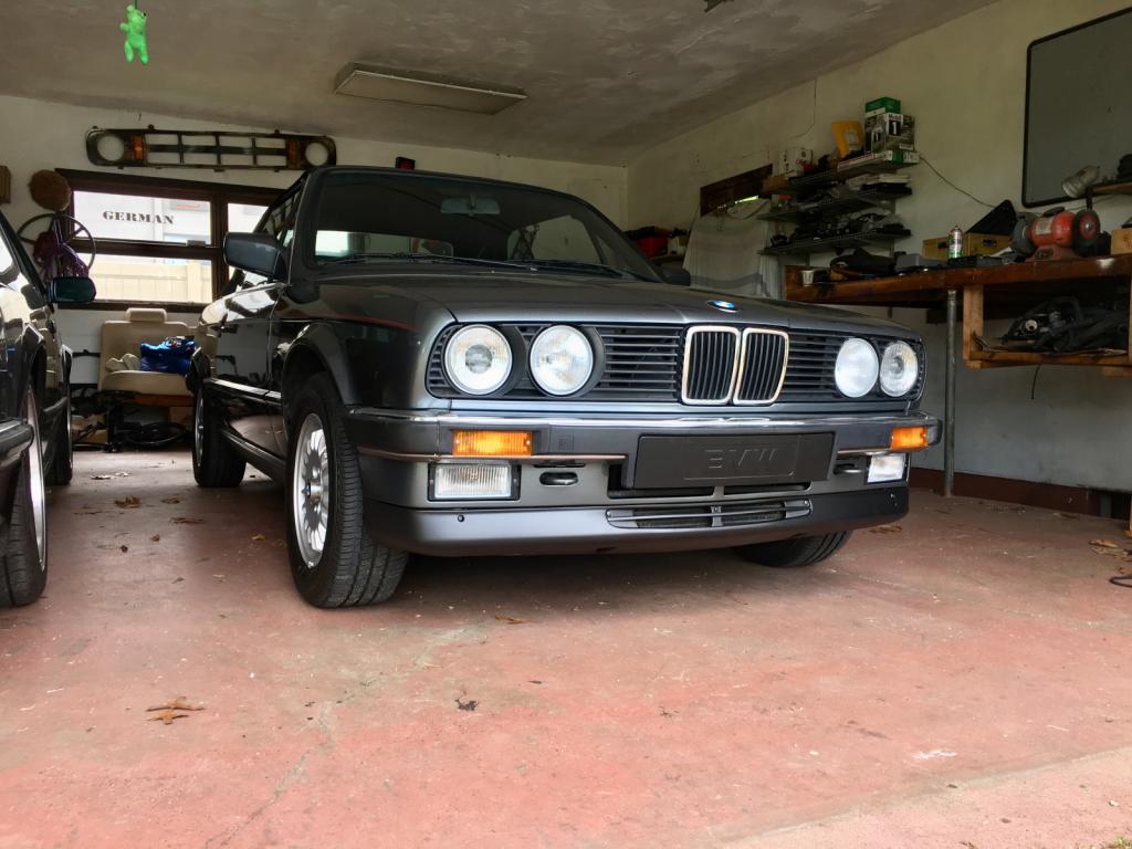

Name:	E30 Euro front.jpg
Name:	87 euro bumps & valance.jpg
                      So you need to find old style fogs / M3 fogs, or the smooth filler plates, right?

                          The black plastic lip? Yeah, parking blocks are a bummer - all of my cars catch on those, except the tall Volvo wagon!
                          We touched ours up with SEM trim black just for scuffs. That old fiberglass cowcatcher would have been long gone at this height on these roads. But his steel valance barely fits the screw holes, and some are just missing.
                          I notice on pics of original Alpina cars, that they're not sitting down over the front tires - they have some space for real world driving. Lower, yes, stiffer, certainly, but not catching the tire on the wheel arch like we're doing, and we have essentially the same wheel and offset as real Alpinas.

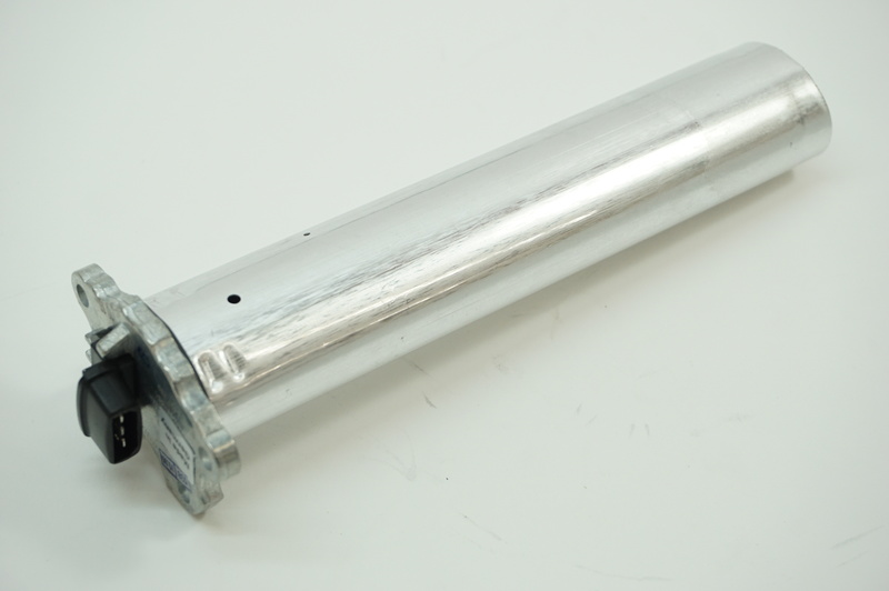

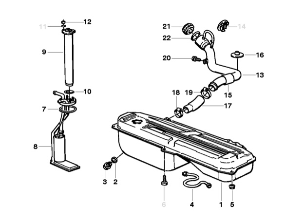

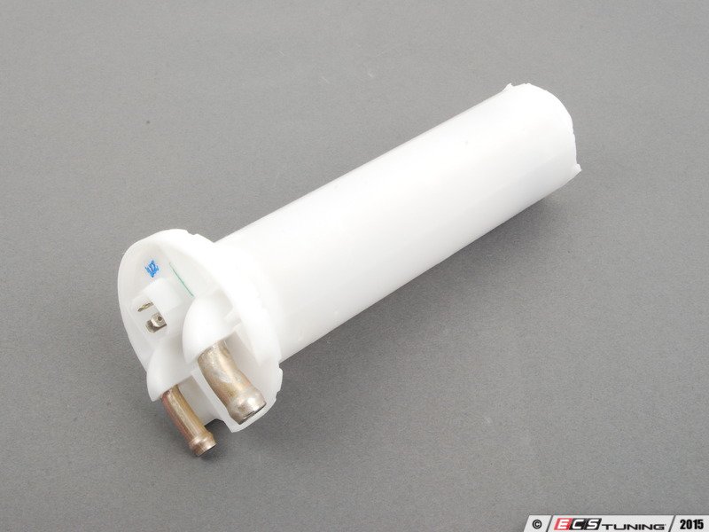

                              Oh, y'know...we never changed out the sender when we did the Vega fuel pump swap.
                              Some "i" motors have two senders? According to realoem, our e shows just the one in the pump hanger assembly.
Name:	E30 e fuel.jpeg
                              So these aren't cheap for a simple device. I see this hit pops up in a search - from our reliable friends at ECS...for only $98, but the applications says not for an eta.
                              This is the dood...well over $200, wow. But seems like this is the likely culprit.
