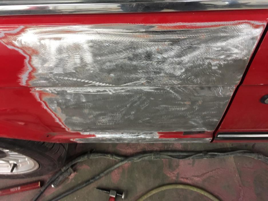

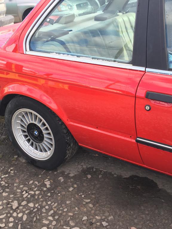

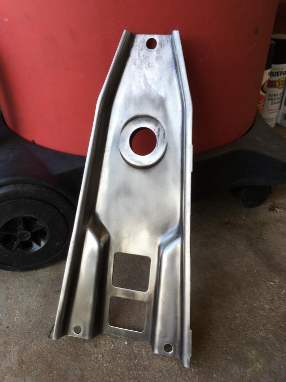

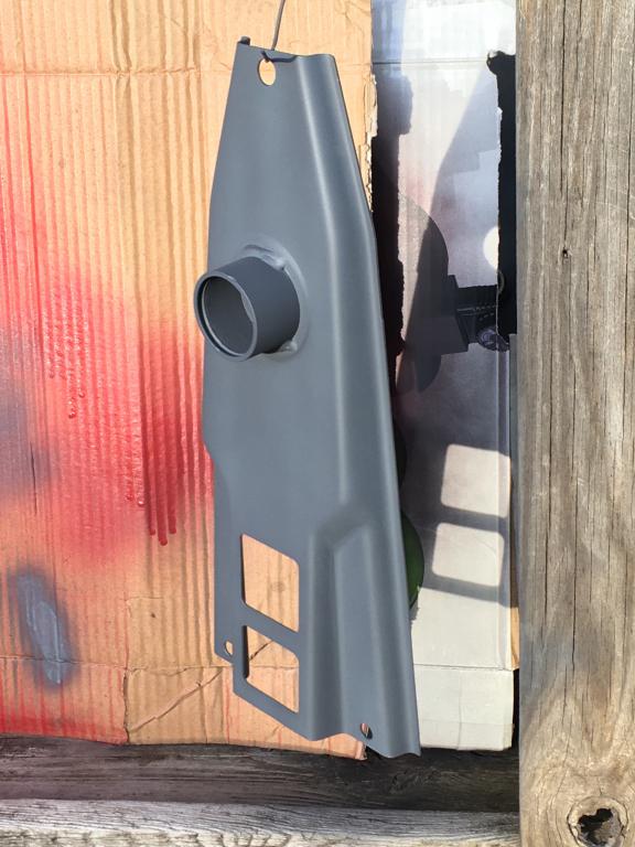

    Very pleased with the metal work and paint.

      Wow, that turned out nicely!
      • rturbo 930
        • Dec 2005
        • 2627
        #153
        Looks great! Glad to see you went that route. Too much replacement these days, not enough repair.
        • LateFan
          • May 2013
          • 4431
          #154
          Fun to find a good metal guy that does it right.

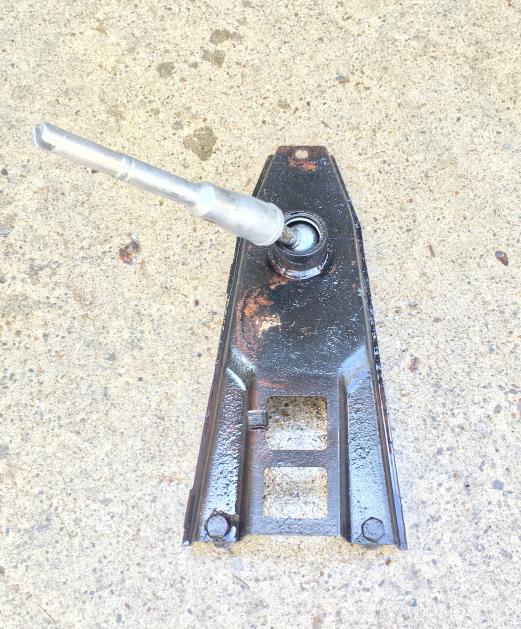

              We have the early shift plate type. There was a small engine fire under the donor car - got the rubber and plastic hot enough to melt, so we're replacing a lot of pieces.
              Click image for larger version  Name:	IMG_5978.JPG Views:	0 Size:	81.8 KB ID:	9935752

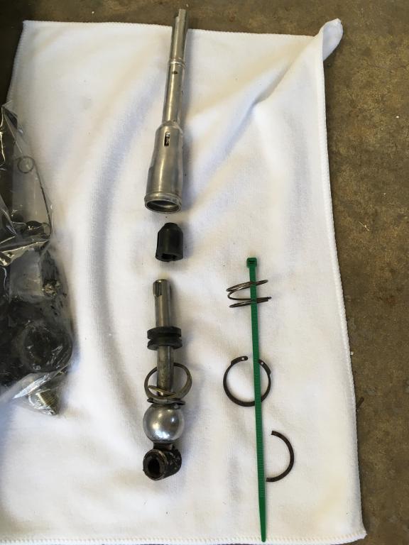

              That bushing is shot, so you have to buy the lower shaft lever, which now looks to have a Delrin ball instead of this dimpled aluminum one.
              Click image for larger version  Name:	IMG_5985.JPG Views:	0 Size:	72.2 KB ID:	9935753
              So I ground it all off with the wire wheel.
              Click image for larger version  Name:	IMG_5992.JPG Views:	0 Size:	50.3 KB ID:	9935754
              Click image for larger version  Name:	IMG_5997.JPG Views:	0 Size:	65.4 KB ID:	9935755
              So many bits to keep track of!

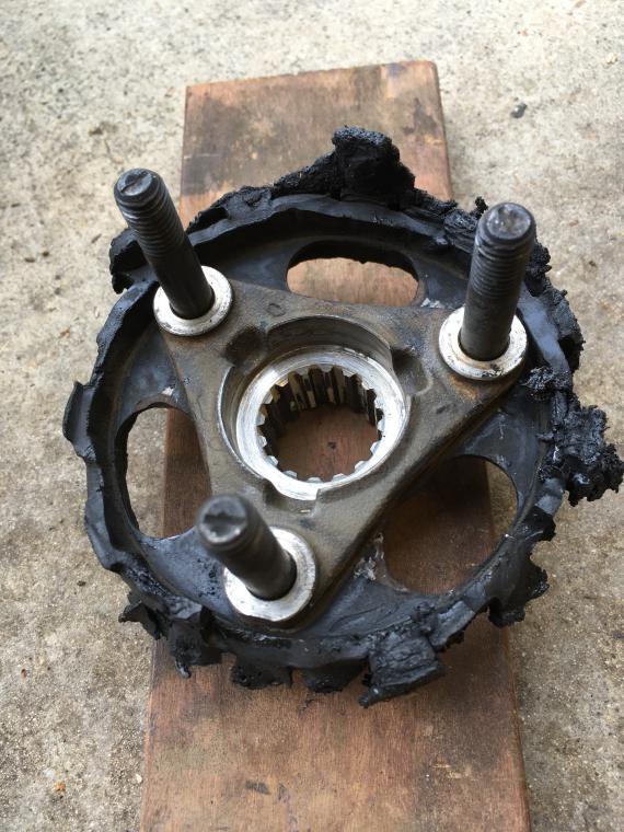

                    Yeah, neither of those little L brackets came with it and I don't see any out there just yet. The NW guys out here might have parts stashes to help out. Funny I was just doing a spreadsheet parts list! Thanks. Right now I'm trying to cross reference early eta case with 6 1/2" depth with part numbers for TO bearing and clutch. I think I'll get the standard SACHS kit.
                    I'm just taking out this melted harmonic balancer on the output flange. Is that OK? I'm under the impression most people leave it out, and it was discontinued on later cars? Trying to get it to pop loose from the yoke. Do those studs press fit in? I've tried PB, two boards, and a careful 2 lb hammer.

                      A search found this post by iwantspeed in 2018: His pics are long gone on his DIY.
                      "But this presents another opportunity to fix a mistake you made.
                      You should remove the harmonic balancer ring on your driveshaft.
                      It will hit your shift linkage since you did the z3 shifter.
                      You can bend your shift linkage to clear the harmonic balancer, but if you ever change shift levers in the future or upgrade to a dssr (highly recommend) then you can't install it until the that ring is removed.
                      "You will need a few new bolts.
                      From what I remember that ring uses pressed in studs.
                      You can hammer out the studs, remove the ring and install regular bolts.
                      "Also make sure you orientate the guibo in the correct direction.
                      The tip of the arrow needs to point to a flange.
                      "Most e30 do not have a harmonic balancer on the driveshaft.
                      A diy I made I while ago:"
                      http://garagistic.com/index.php?page...arrier-bushing
                      "Now heat up the studs and hit them with a Big fucking hammer (BFH).
                      Once the studs come off and fly across the room, rotate the harmonic balancer and slide it forward.
                      Success!"

                            Regarding the harmonic balancer remnants, mine was in similar shape, and I tried getting it off but couldn't. I didn't really want to hammer out the studs. I installed a UUC DSSR as well as the Z3 short shifter, and just reinstalled the flange with the balancer bracket still attached after re-sealing the output shaft. I've had no issues with the shifter hitting whats left of the harmonic balancer. Since the big rubber donut aspect of the balancer isn't there, there's not much to really get caught on:
                            The remants of the balancer are light enough (essentially just the steel mount plate at this point) that is doesn't have any effect on driveline vibration either that I've noticed. If I were you I'd leave it alone honestly.

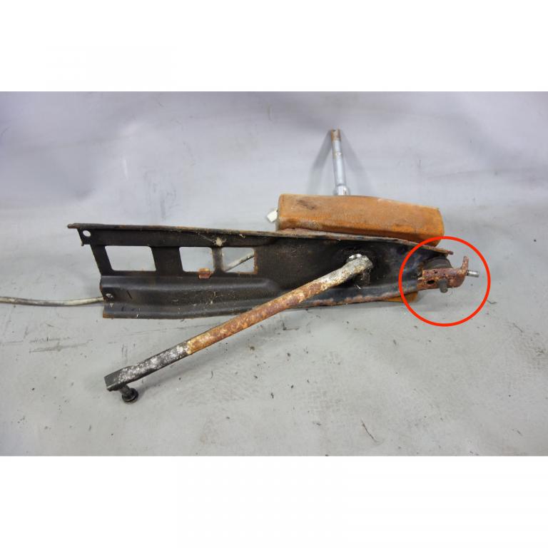

                              I see your nicely painted "bow" bracket hanging off the plate! They are not out there so far. I found one in a shifter assembly and the seller won't separate it. If I had one I could measure carefully, I bet a fab shop could bend or weld up a thick steel plate with the holes and stud. It's not carrying much weight, it just braces the shift linkage assembly.
