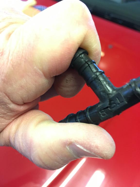

                    Quick trip to near Seattle, 900 mi round trip. Drove straight as an arrow he says. We found two bad fuel leaks and fixed them the other day - one was a completely split plastic T over by the cold start valve (above the exhaust, YIKE). Replaced with a brass one. The other was my half-assed T to hold a fuel pressure gauge for testing - I had plugged it with a bolt and a clamp... So this trip, one leg he got 27mpg. Think those leaks might have helped? Haha, no wonder it was bad!

                      Don't put one of these in your high pressure fuel lines.......

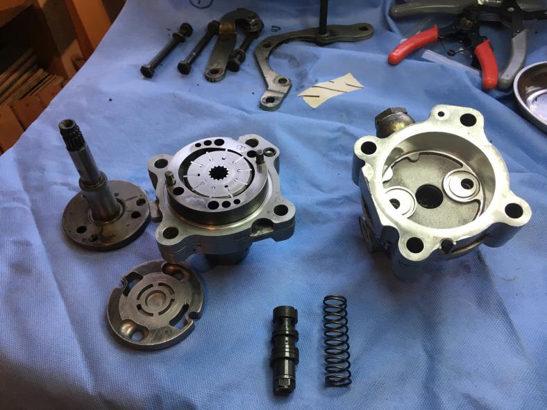

                        Rebuilding a Vickers power steering pump.

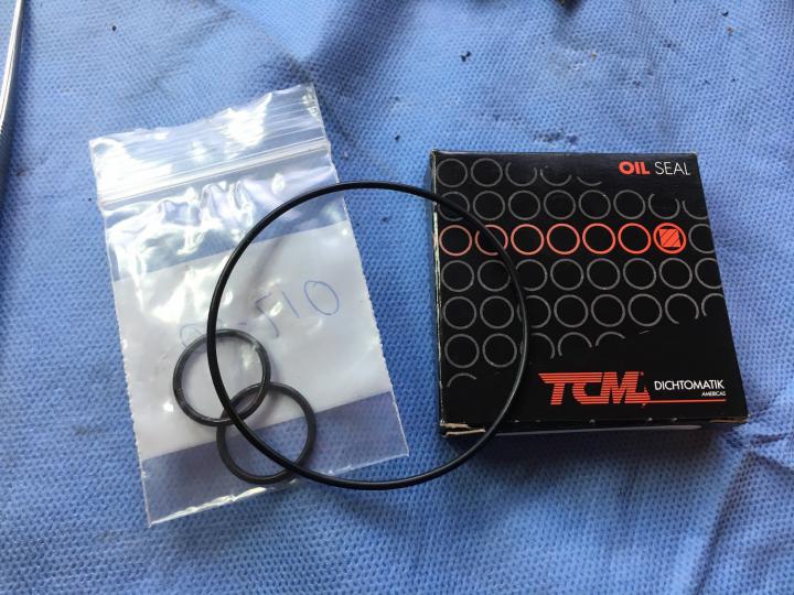

                        If you take yours apart, you may find that you have one of the few pumps that aren't a ZF. They look very similar on the outside. I found a rebuild kit at my local parts store and was quite pleased with myself. But not one seal or o-ring in the kit fit anywhere. Wrote to Blunttech and none of their suppliers could get a Vickers kit. So I went to my local industrial supply shops and ordered a shaft seal and all the o-rings (they're metric of course, but if you dig through a good suppliers boxes, you'll find rings that are very close) Don't measure the old o-rings - they are smashed and stretched and hard. Measure the actual machined grooves they sit in for diameter and thickness.
                        Here are the guts.
                        Mark your halves carefully and where the brackets sit on the case. Note that ATF eats paint, and therefore it eats permanent marker as well. I lucked out and enough of the marks, and the pictures, saved me. Shaft is on the left, pump vane assembly in the main body next, cover below that, back half of the case to the right, then the plastic "plunger" and spring that come out of the center hole on the case back.
                        Click image for larger version  Name:	pump1.JPG Views:	0 Size:	73.8 KB ID:	9865837
                        Go get the correct diameter and thickness of o-rings. Your shaft seal will likely have some tiny numbers molded in - these are the inner and outer diameters, and the thickness. And maybe some letter defining the seal lip profile. Mine was an NAK brand and looked pretty good for 30 years old. I just ordered the size, and when I picked up the new one it was also an NAK....still around.

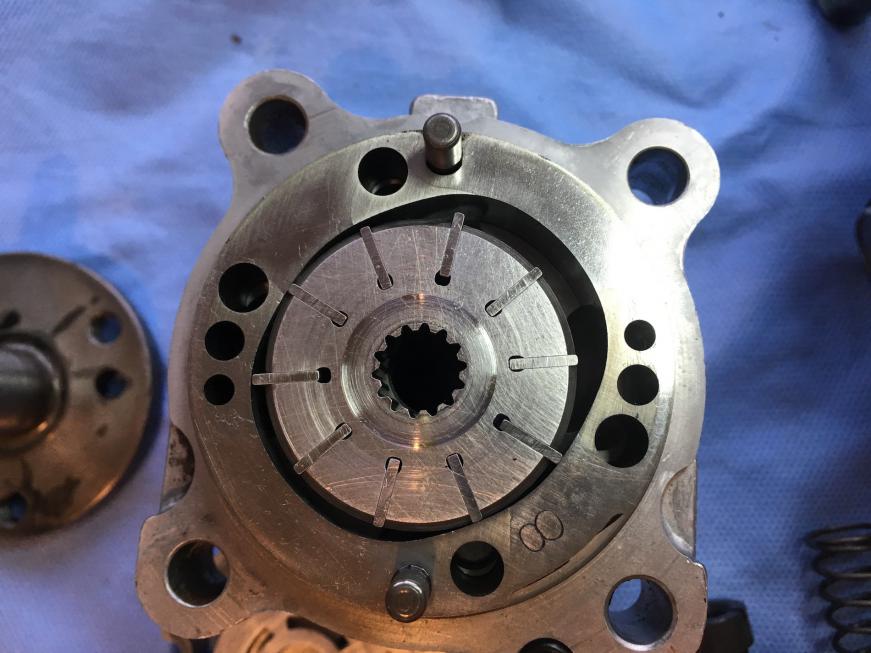

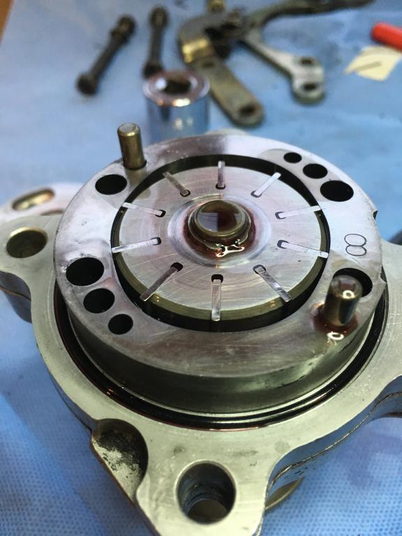

                        The pump vanes are cool. They ride in and out of the precision slots as this hub turns and move fluid at high pressure. I would recommend NOT taking these out, or dropping it. I assume they've all seated into their original slots, and the plates may or may not be symmetrical, so I wouldn't mess with it. I rinsed all the parts and passages in clean ATF.
                        Click image for larger version  Name:	pump4.JPG Views:	0 Size:	70.8 KB ID:	9865839

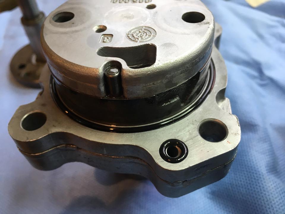

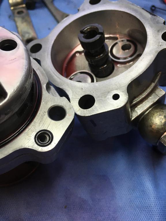

                        There is a tiny o-ring in the body here between halves. Tricky size to measure. Fit all new rings. Note big ring around central pump body. The ring I ordered was a hair tight and didn't want to sit flat in that squarish cut groove. I stretched it just a hair by hand, and with some ATF it stuck pretty well. Be careful putting the halves together again. Align your marks - or look for this oil passage at one corner only.

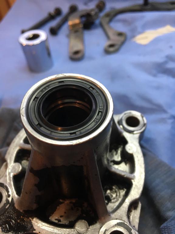

                        New shaft seal. I wiped everything really clean with brake clean, tapped it in dry, then put some assembly grease on the seal opening. I carefully tapped it flush with a socket that fit, and maybe a hair down past flush as there's a chamfer / bevel you can see here at the top of the bore.
                        Click image for larger version  Name:	pump7.JPG Views:	0 Size:	47.6 KB ID:	9865842

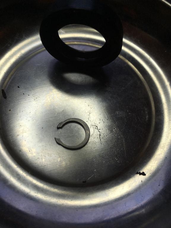

                          This is the tiny c clip on the pump shaft. I reused it. I had to fiddle with plier tips to get something that tight to work. Not bad, it's just tiny and very slippery. I gave it a good squeeze with a needle nose to make sure it was snug in the groove.

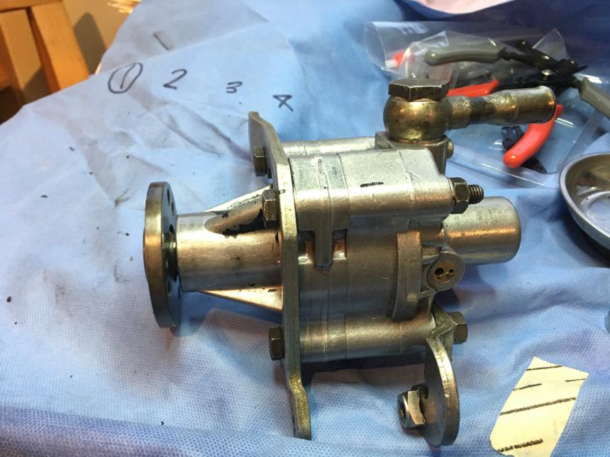

                          Back together with mounting brackets. I didn't find a torque for the case bolts, so Good n Tight is what I used. They're 13mm. I numbered the bolts as well, so they'd go back in the right holes in the right direction for the nuts.
