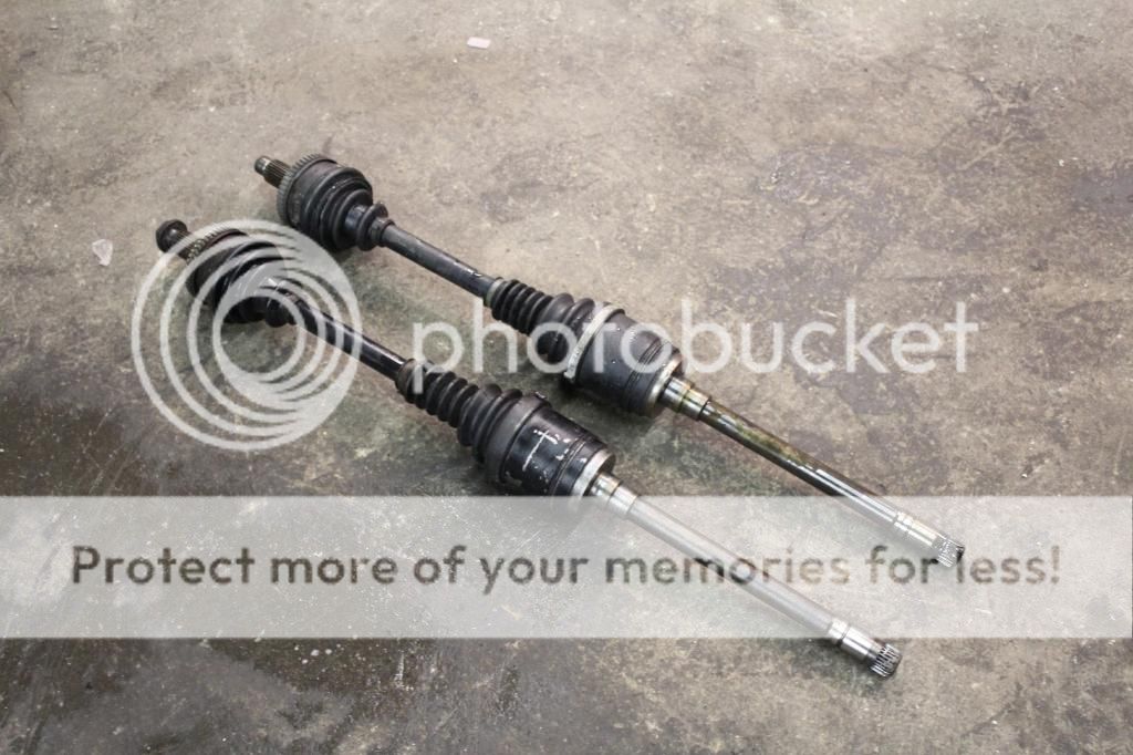

      Out with the old, in with the new. Yes, that is electrical tape, and yes, it held up for far too long.
      Also, stole the front end from the 4dr!
