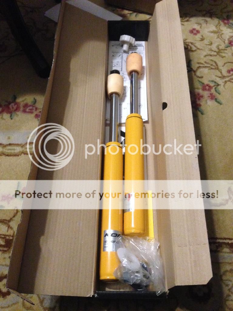

                    Front struts ordered! Ended up finding them for $203 a piece with free shipping. Amazon FTW.
                    Koni P/N: 8610-1436RACE
                    2.1" shorter than standard iX front Koni strut for use with shortened strut housings.

                      They're so pretty!

                          Originally posted by audiquattrot
                          nice!~ leaving the stock springs? That sucks about the tc....btdt =/
                          These are the shortened race Konis! 2.1" shorter while having otherwise the same dimensions as the normal length iX Koni struts (PN: 8610 1436RACE). Thus, for my Ground Control setup, I have to shorten the strut housing 2.1". This way I can go low while still retaining stock suspension travel! Plus these guys are 5 way adj and are valved better than the Bilsteins for running a stiff spring.
                          My housings are at JMFab at the moment, so hopefully Monday or so I'll get to throw them on!

                                Originally posted by AWDBOB
                                They're so pretty!
                                those look great. at $203 a piece I might follow suit if my billies are indeed broken. my housings are shortened 2" so I'd have to make a spacer but that's not a big deal.
