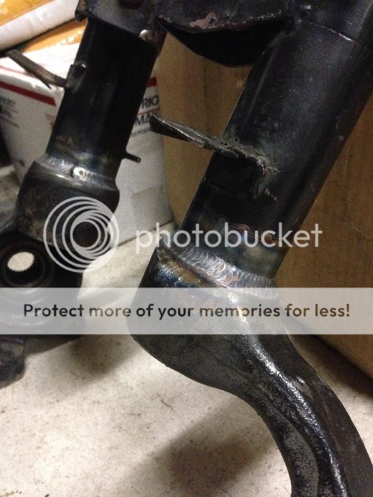

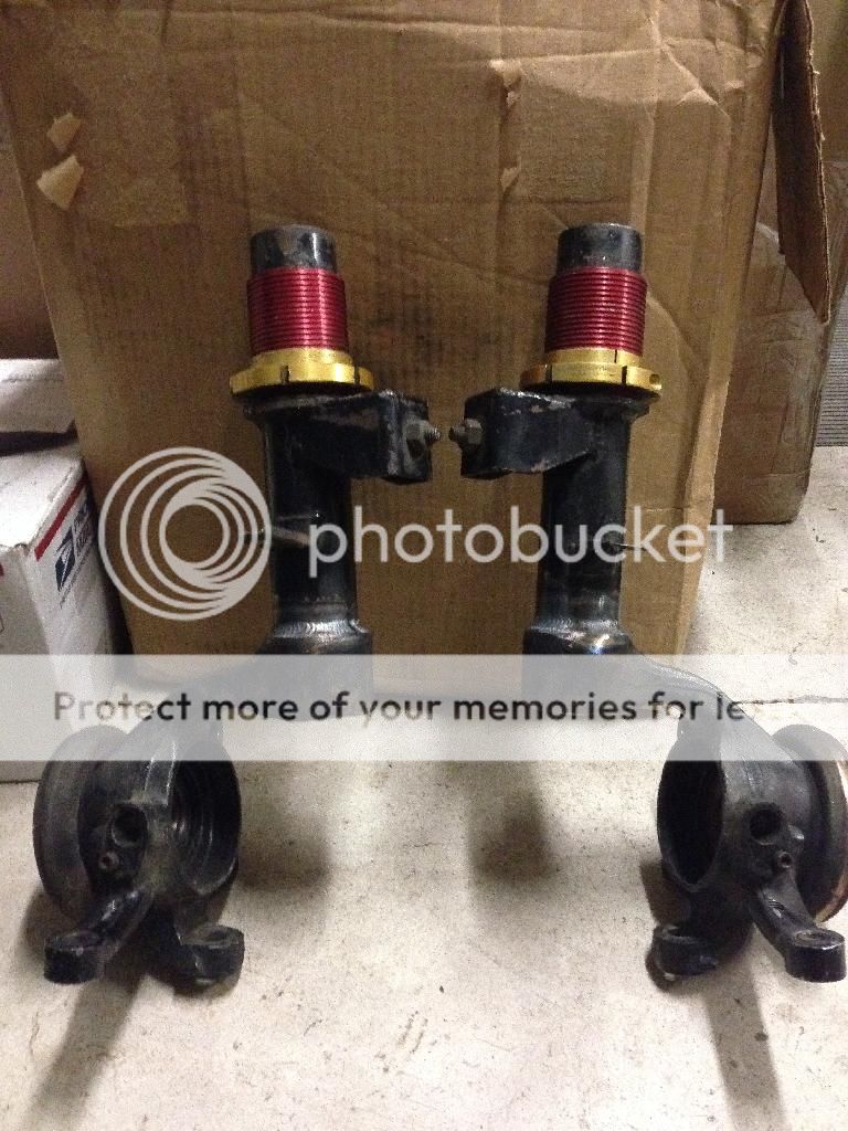

      Shortened housings! Done by JMFab, and like always, the work is great.

        Looks great!

          gorgeous. set of these in my future for sure.

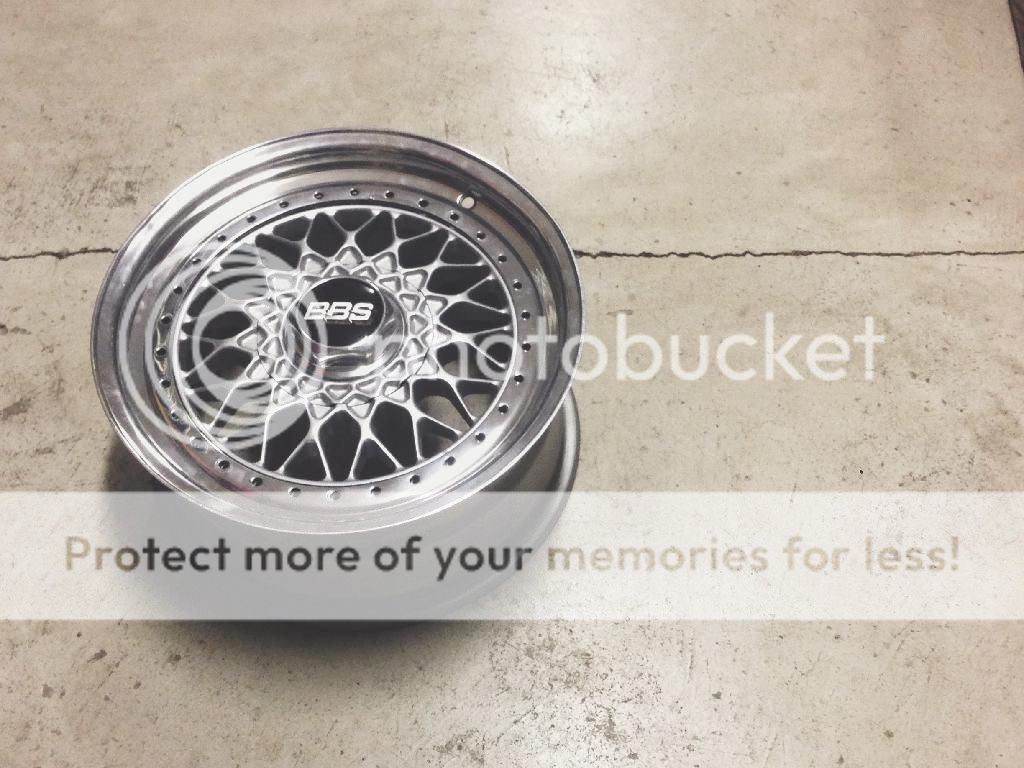

              I'm extremely excited! Got a lead on some RS001s here in Philly that I think I'm going to be picking up tonight or tomorrow too, so that's equally as exciting!

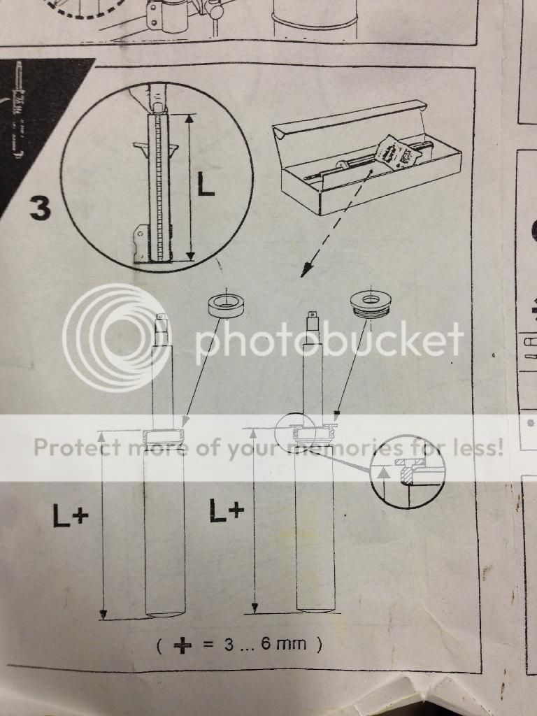

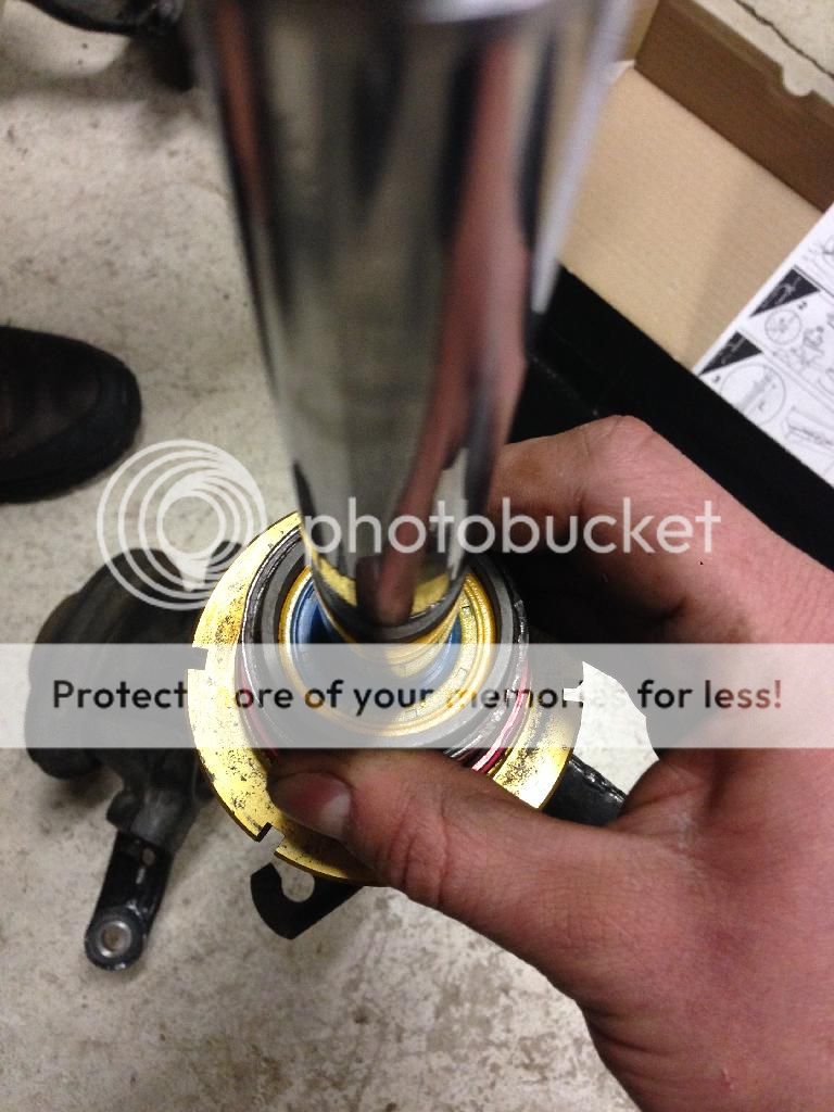

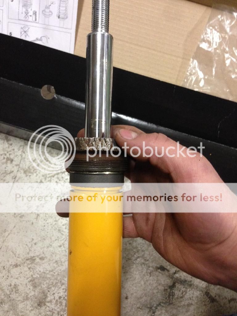

                  Went outside to throw them on, only to find that of the "good" wheel bearings that came on my housings, one was totally shot. Coincidentally, on that side (from beating the hell out of it), the PO couldn't get his rotor off so he beat it senselessly until it broke, leaving the allen bolt and a piece of his rotor stuck to the mating surface as an obvious sign of what happened.
                  Also, there IS a special gland nut for the Koni struts. Now I need to find out where to get them. These race Konis use a spacer, around which the special Koni gland nut falls and secures nicely. You can use the OEM gland nut without the spacer, but it is NOT a snug fit, so I wouldn't recommend it.

                    Heres a link with glad nut numbers from KONI :)
                    KONI is the world leader in adjustable shock absorber technology with over 50 years of worldwide racing success.
                    This one, right? M48 x 1.50 Part nr. 73.25.01.003.1
                      That was a HUGE help. I've been looking everywhere. Thanks, man.

                            love the RS's!! this is gonna be good.

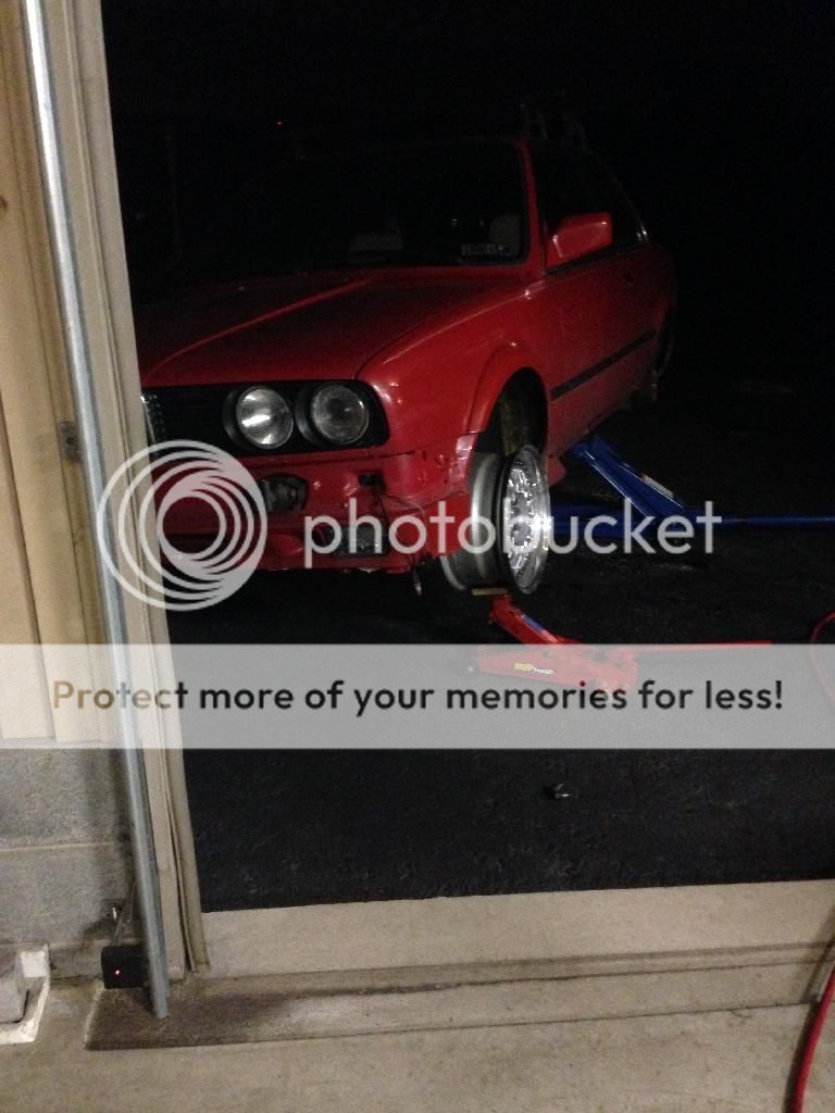

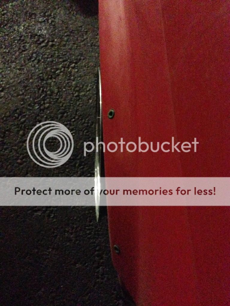

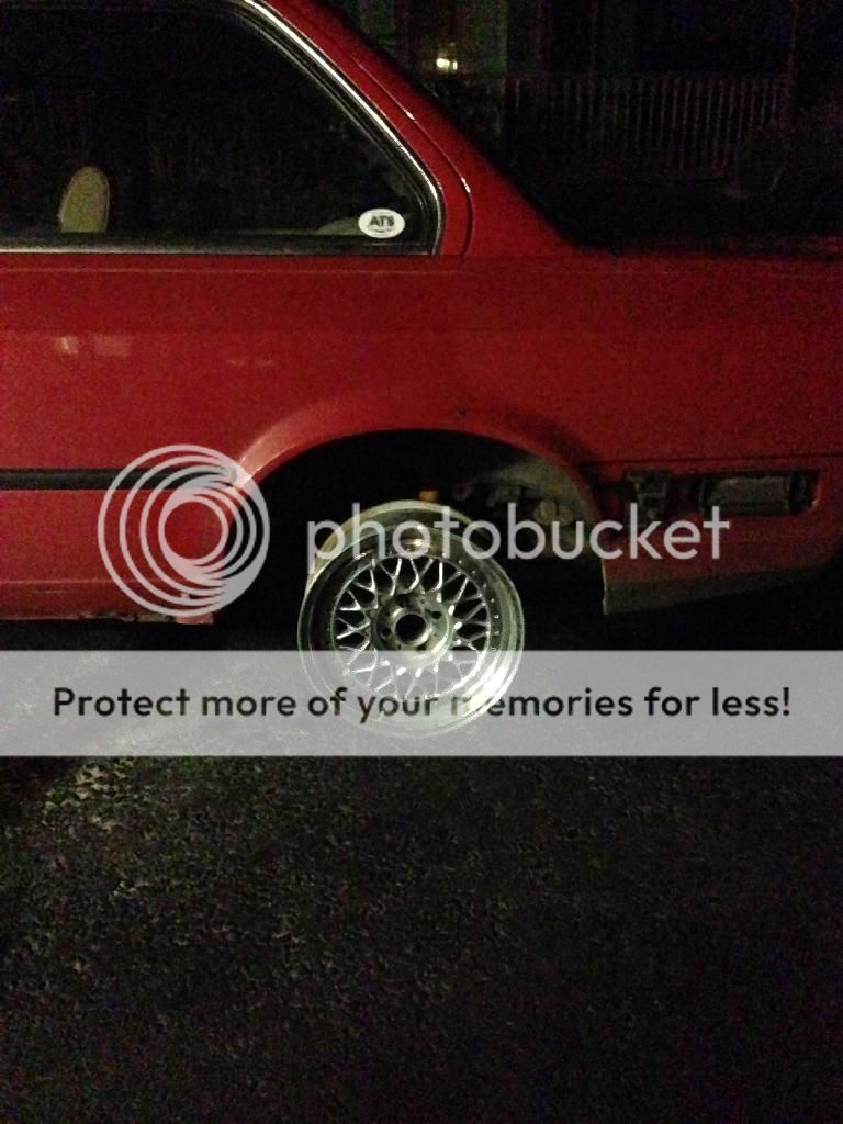

                              I'm super stoked! It's not going to be an overnight project, but the coils and wheels will be done first, and then I'll be taking care of the necessary body work around spring when I can drive the Evo again.
                              Some fitment angles. It's gonna get a hefty roll/pull so I can still fit a phat tire.
                              Got the Evo wrapped back up tonight too!

                                what are the specs of the wheels, size/width/offset?
