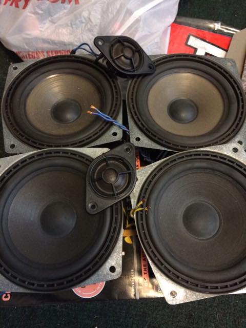

          Got all my components for the speaker upgrade!
          From e34. I'll be swapping the silk dome tweeters into the front and the e30 premium tweeters into the rear.

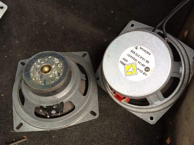

            #95
            New member, my first E30, from the Bay Area. NEW QUESTIONS EVERY DAY!

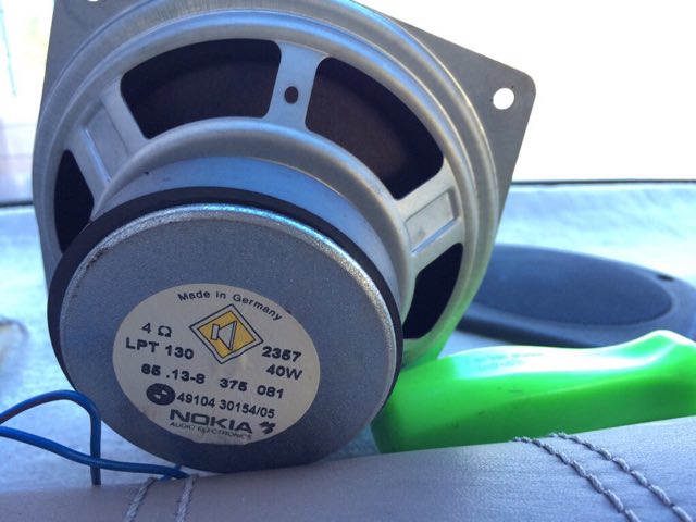

            So the old speakers in the rear are one e34 and one e34 DVC.
            I got one from the junk yard, so now I have two. These are supposed to be better than the regular e34 right?

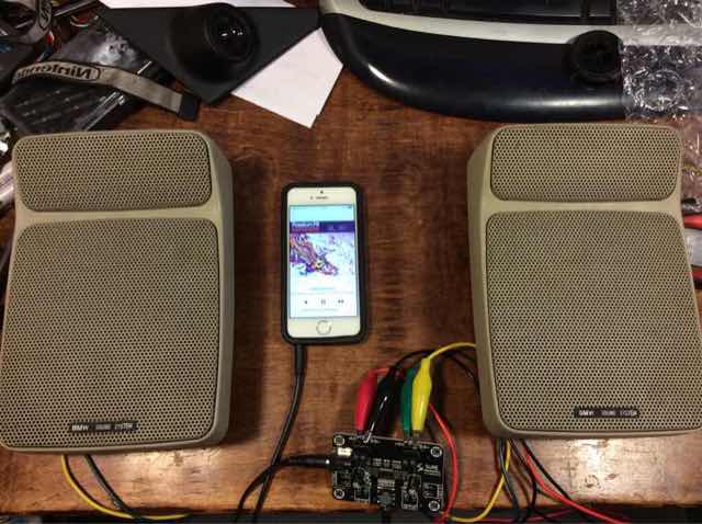

                #97
                Built the rears, E34 components and Parts Express crossover parts based on GAS PCN, boy do they sound great!
                Can't wait to install them.
                Have to wait for a new front tweeter to install them. Blergh :(

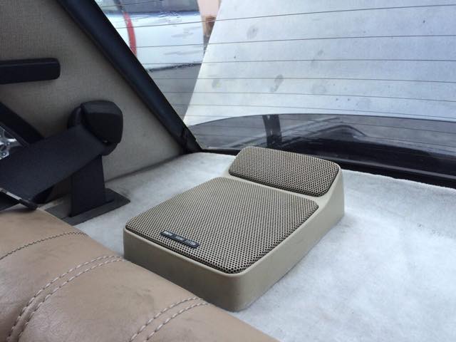

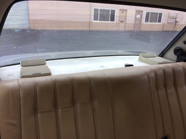

                    Holy wow. Premium speakers sound about 382% better than stock. Such a worthwhile upgrade!
                    I have them aiming forward because I don't have front tweeters. Separation is really good sitting in the rear, sitting in front is still good but obviously biased right. Can't wait to get tweeters for the front!

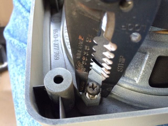

                    I popped the nuts out of the rear of the mid bass.
                    And used #8x2" sheet metal screws to mount them to the same holes the old ones used. Cranked em down just enough to suck down into the carpet.

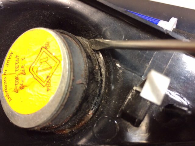

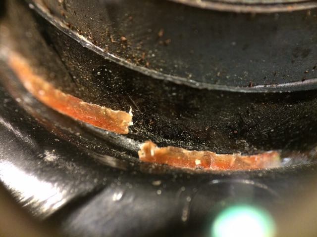

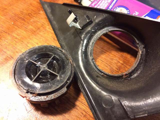

                            Heya, thanks for reading!

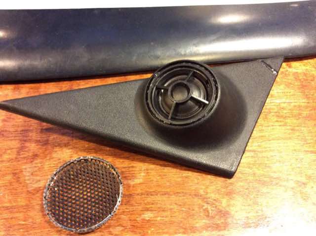

                            So here's more speaker trouble. I've popped out one of the tweeters. Chip the glue out.
                            Pry it out with a flat blade.
                            Took out the old tweeter. Mylar cone, fluid cooled.
                            E34 silk dome front tweeter. Make sure you take all the glue out of the channel.
                            Use a razor and pry it out by twisting.

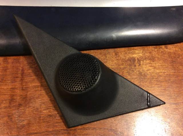

                                #105

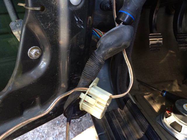

                                Built the crossovers and installed the front tweeters.
                                Even pulled the wire through the rubber boot.
                                I have a silk dome on the left and a Mylar on the right, the Mylar is way brighter and crisper, but I like the silk dome better. Neither have foam in front.
