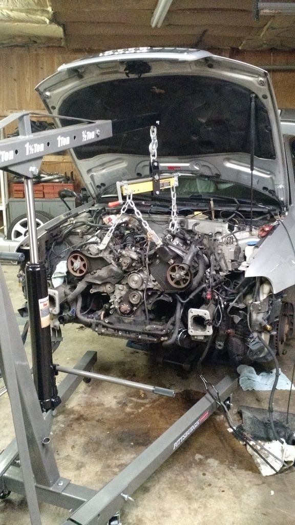

          Not much to update right now, I was messing with it a little bit tonight just pulling parts off.
          Looks like I'll have clearance on the back while keeping the secondary firewall, I'll have to redo the wiring harness and reroute but that's ok. In the photo it wouldn't fit down in there due to the current boost control hoses and egt control units.
          Since both of those things will be gone, I removed them and it fight right down in there with a little room to spare. Also will have to relocated the vacuum ports away from the rear of the manifold.

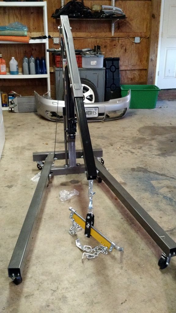

          Gotta buy an engine hoist and press from harbor freight here soon so i can get rolling. Probably won't order the rest of the parts until tax time.

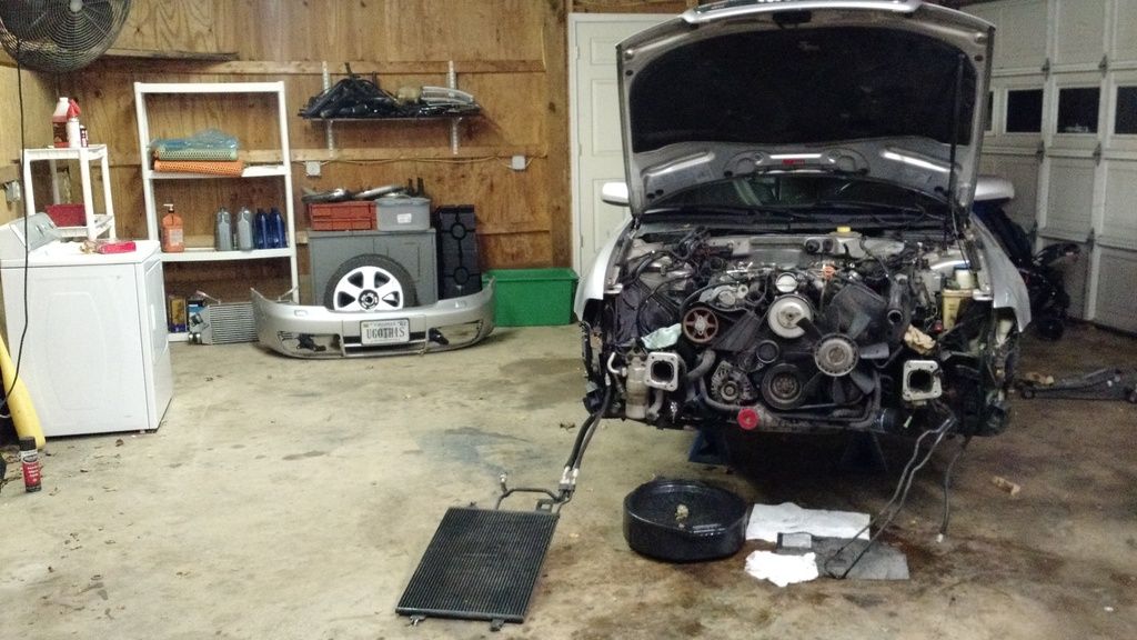

            All positioned. Lots of room, tools are behind me. Let's put the garage to use!
            Spent about an hour on it tonight. My 3 year old has turned out to be an excellent helper. She made sure to keep my work light on point the entire time.
            Rough positioning. It will sit a bit lower.

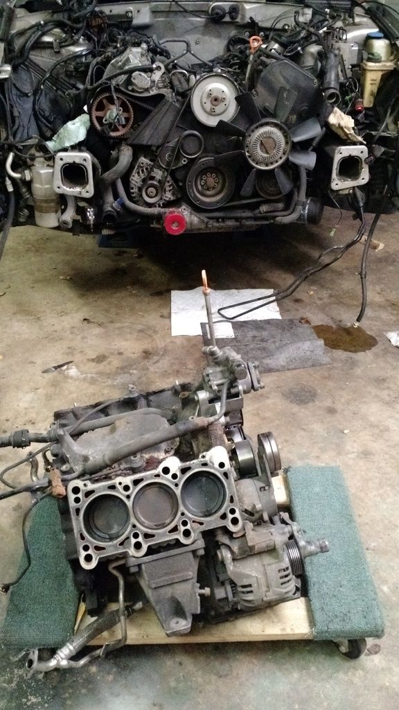

              Bad news, decided to perform a compression test before I pulled the engine out.
              All cylinders are low, around 120psi. Cylinder 5 rings are completely shot. 75psi repeated for multiple attempts. Added oil and it shot up to 160.
              I wasn't planning on touching the rings, but I guess plans change. Hell, I wasn't even sure if I wanted to take apart the engine or just risk the stock block and run it.
              So, now a engine tear down is inevitable. Hopefully the bores check out and I can just do a hone/re-ring.
              If the bore is bad, then I need to take a step back and consider my options. I'm not getting into boring and aftermarket pistons with the 2.7, even with rods we are reaching the point of diminishing returns. (Stock block = 500whp. Drop in rods = 600whp, and you are already risking a cracked block if your torque is up there as well. )

                Picking up a short block on Saturday. Less mileage, ran when pulled, and it's the later style BF block which is supposed to be a bit stronger than the one I have.
                I didn't post about it, but the last few times I started my car I had a low oil pressure warning pop up once it got warm. It was intermittent though, which leads me to think it wasn't a bad sensor. My power level is supposed to be safe, but that combined with the shit compression numbers is making me want to just take the heads and build another block.

                    New block looks and feels great.
                    Bought a new toy as well. Now I can actually pull everything.

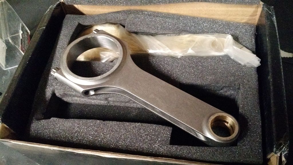

                        Order placed for rods. I also bought a dry erase board to put in the garage so I can give myself a visual "to-do" list. Should help to prioritize and brainstorm plans. It works wonders for us at work on big jobs, so I figure it should help me cement things at home as well.

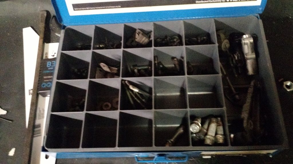

                                Been meaning to snap a photo of this. We switched hardware suppliers at work, so I got to snag a couple bins from the old vendor that were being trashed. They make perfect organizers, should make reassembly a bit easier.
