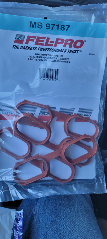

    Parts showed up today, therefore, its go time.
    Click image for larger version  Name:	20260602_140339.jpg Views:	0 Size:	123.7 KB ID:	10161954

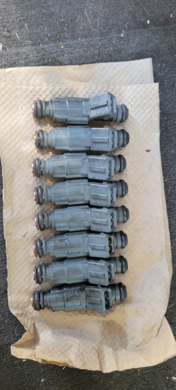

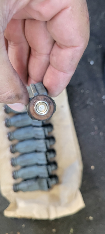

    decided to go to Pick N Pull and see what injectors the E39 that I pulled the crossover from had in it. It had 8 of the new style bosch 0280156347 injectors, that looked new. Needless to say, for $100 for the set, I jumped on them.
    Click image for larger version  Name:	20260602_144941.jpg Views:	0 Size:	135.2 KB ID:	10161955
    Click image for larger version  Name:	20260602_144948.jpg Views:	0 Size:	78.5 KB ID:	10161956
    Got everything Slammed back together, and gave it a crank. Took a second to reprime the fuel system, but we got life again, and no coolant leaks that I can see!

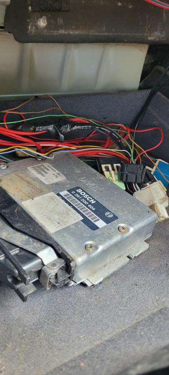

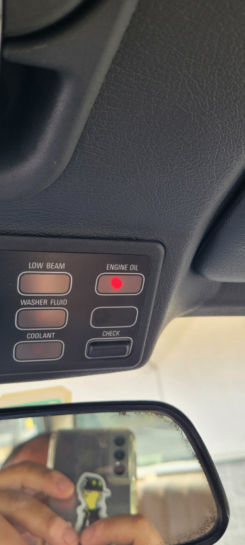

                Okay for those of you that know more about BMW sensors and wiring, I've got a question. Recently the oil level sensor in my M60 took a shit. I was having a hard time finding a sensor that was not hundreds of dollars. I had read somewhere that the m62 oil level sensor was a acceptable replacement. So I went back to the 540i that I scavenged parts from earlier at my local Pick-n-Pull, and snagged the sensor from that motor. While I was at it I also snagged the wiring all the way up to the junction boxes on top of the motor. I grabbed the wiring for two reasons. One being that the m62 sensor uses a different plug than the M60 sensor, the other reason is, when I first did the swap that was one of the connections that have been cut in several places by somebody else, and just spliced the wires back together, to make it work. And it worked fine for years. I did Keep the old sensor, and the old hacked up wiring and plug. That way if I needed to go back to a original style sensor I could.
                I installed the new sensor when I did the oil change recently on it, and ran the new wires and plug. Unfortunately I got some bad information because that did not fix the issue. I still have my engine oil level light on. So I guess I have two questions overall.
                The motor came out of a '94 540i originally, does anybody know where I can get an oil level sensor that's not going to cost me $200+, or does anyone know what the 404 dmu is looking for in the way of signal to shut that light off. If it's something simple like installing a resistor or grounding a wire I think I will do that and just not worry about having an oil level sensor. I mean I manually check the oil on this thing every time I drive it, and currently I do not have any oil leaks at all from the motor, so the oil level sensor is kind of moot.

                  I think the oil level sensor stuff is through the Check panel module in the left side of the trunk, and is basically entirely e30 chassis side besides the sensor/wiring - no interface with the DME at all.
                  I think you can deal with it at the C101 connector.
                  I have a few notes on this but you should double check against the ETM because of the colour conflicts below...
                  "Oil static switch wire is Blue/Violet for Early E30, Green/Yellow for Late E30. Verify with ETM and connect to Ground."
                  "Connect Static to Ground per (dead e30tech link)"
                  Early Model C101:
                  Pin 2: Blu/Yel - Oil Level Sensor (I assume Static)
                  Pin 10: Violet/Green - Oil Level sensor (I assume Dynamic)
                  Late Model C101 (verified on my old '88 Eta):
                  Pin 2: GRN/WHT(Engine Harness) or BLU/BLK(Body Harness) - Oil Level Static (Full)
                  Pin 10: BLU(Engine Harness) - VIOLET/GRN(Chassis side) Oil Level Dynamic (Low)
                  I'd doublecheck vs the ETM and if it doesn't seem glaringly wrong, ground pin 2 on the engine harness side and see if that resolves it.
                    Early Model C101:
                    Thank you bro, I'll mess with it today, and post the results later.

                      Well, it took me longer than I anticipated to get the time to do it, but I got it done.
                      Grounded the wire in the wiring box on the engine its self. Found that Blue/ white, White, and brown go from that box to the sensor. Grounded white to brown, light shut off.
                      So, this will do the job, until I can find a 94mm sensor that isnt $250+. Im sorry, I dont want to spend that much on a sensor that basically just turns off a light. Add to that I check my oil frequently, its seems like a waste of money.
