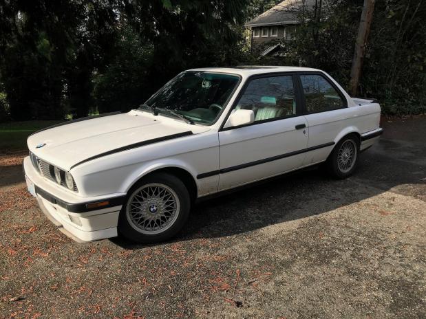

    This is a good time to stop and take stock of the project. Here's a picture, and the latest spec sheet:

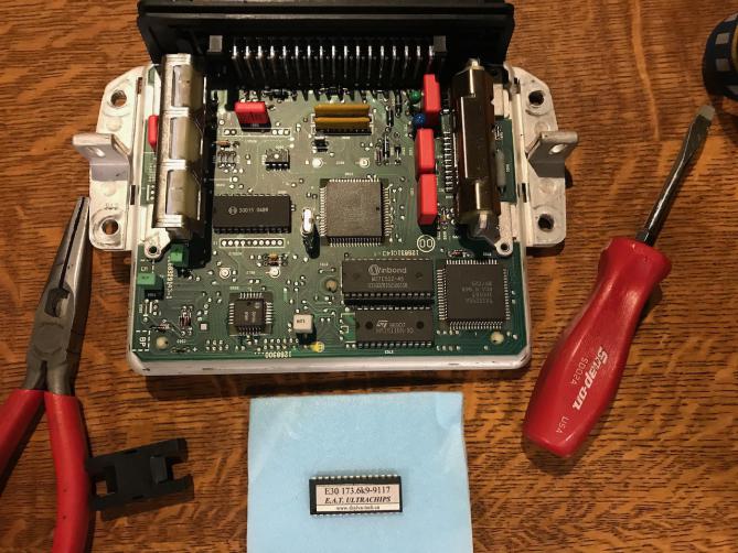

                  I got the stock chip from Moldova. It's an small Eastern European country between Romania and Ukraine.
                  A Moldovian there sells BMW ECU programs and chips on eBay. So I got a stock chip from him for about $20. A few weeks later, I received it. Just installed it, and dayum!, it fixed the pinging. That MarkD/E.A.T. chip that I was using must have pushed the ignition timing beyond what the compression ratio could handle. So now with the stock program, the car is running well. I don't know if the stock chip cares that there is a bigger cam, bigger pistons, and bigger injectors. I'm surely leaving power on the table without formal tuning. Here is a pic of the Moldovian chip swapped in.

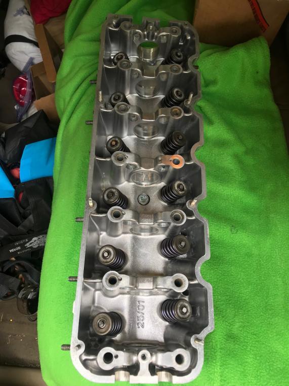

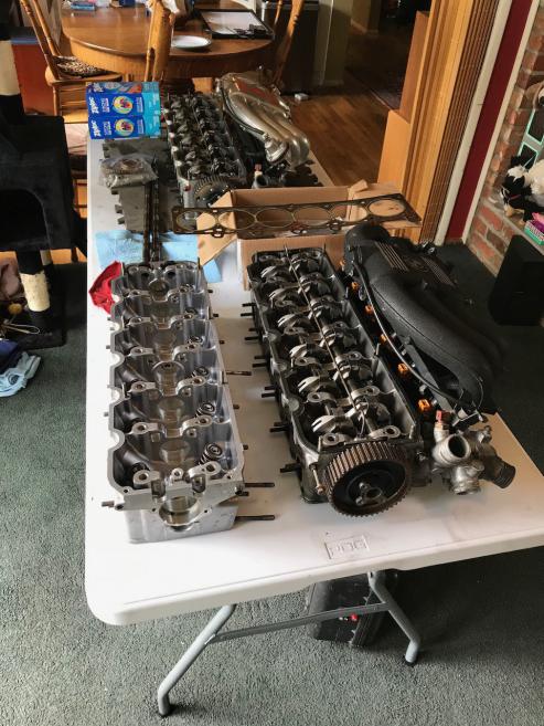

                  While waiting on the Moldovian chip, I took a spare head from my basement back to the machine shop. This head was the one that came on the car's original engine (faux Metric Mechanic 2.9 that turned out to be a poorly assembled stock engine). I was impressed with how this machine shop did the bottom end boring and assembly, and am now a returning customer. Figured I've gone this far and should just go all the way and have an excellent engine from top to bottom. Which now means that I've spent another $600 or so on new Schrick valve springs and Supertech valves. After all this, I might as well go with a Megasquirt PnP for live dyno tuning. That might be a Spring/Summer project. I have to turn my attention to my vintage motorcycle and car racing projects before race season begins.

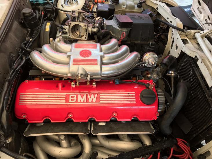

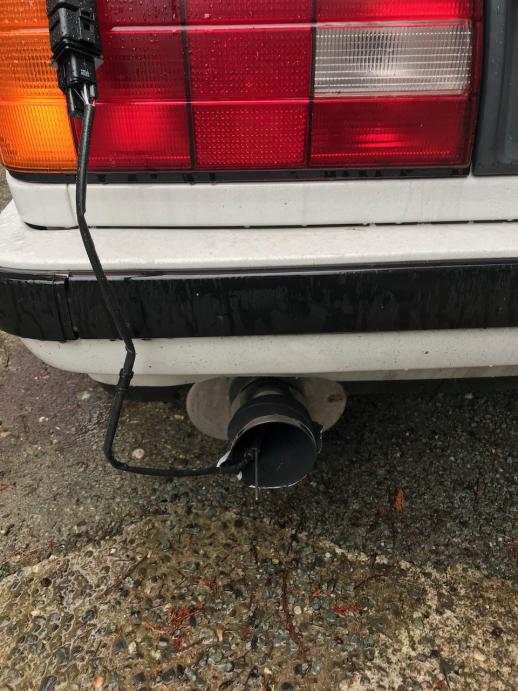

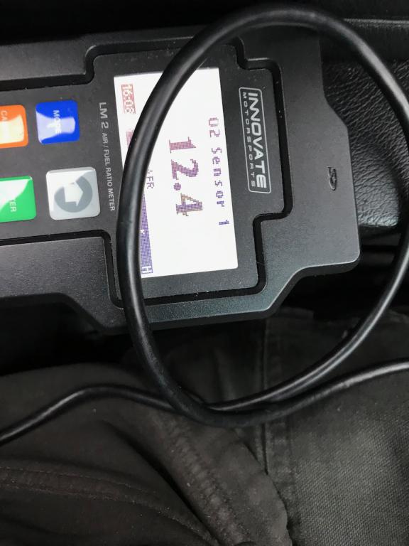

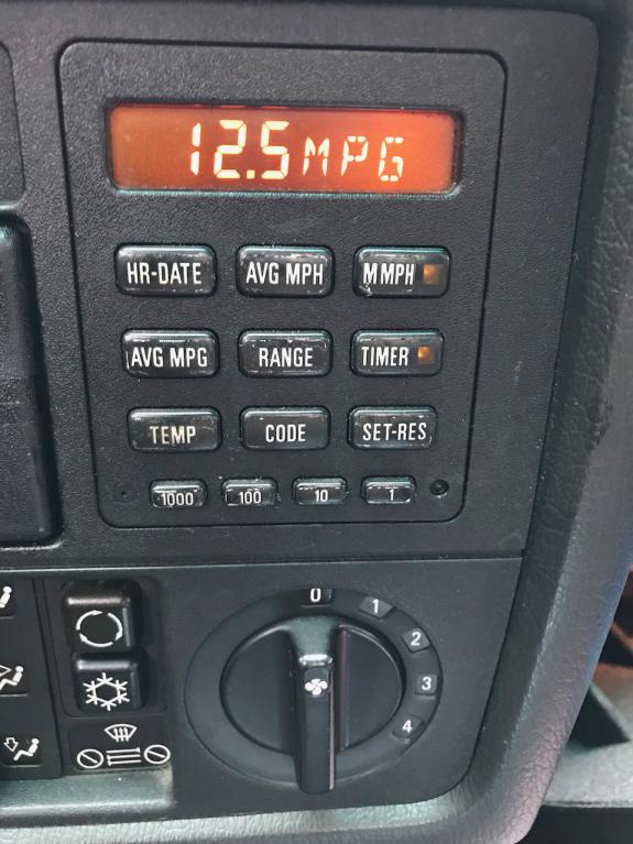

                        I do, in fact, have an Innovate LM-2 wideband AFR meter. Since I dialed in copious fuel on the adjustable fuel pressure regulator, the engine is running pig-rich. Usually getting between 10.5 (low RPM cruising) to 12.5 (higher RPM, under load).
                        Fuel economy? Bwahahahahah!!!!
                        Anyway, the car is continuing to run well well, thanks to the stock chip. I'm trying to decide if I want to keep this current 280/274 Bimmerhead cam when I get the new head done, or put the Schrick 284 cam in it from the other 2.7 SETA stroker sitting in my shed. OTOH, this current shaved head with the high compression might put the Schrick 284 to better use on whatever engine uses it. The Schrick didn't have great low and midrange power on that other relatively underdeveloped SETA stroker. I'm feeling a combination of "option paralysis" and "paralysis by analysis."

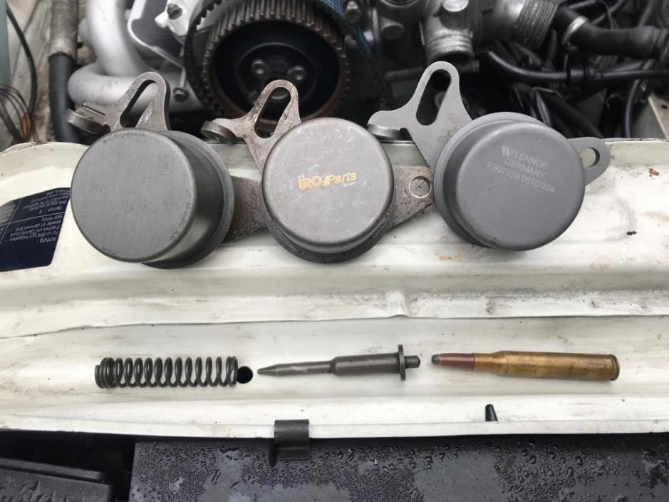

                          It's been a minute. I finally decided to start the hassle of swapping out the excessively shaved head that was giving me too much compression (to the point of detonation). Last winter, I had a stock head rebuilt and ported by a reliable machine shop, using fresh Supertech valves and Schrick performance springs. Big delay in getting the valves because of supply chain problems during the pandemic.

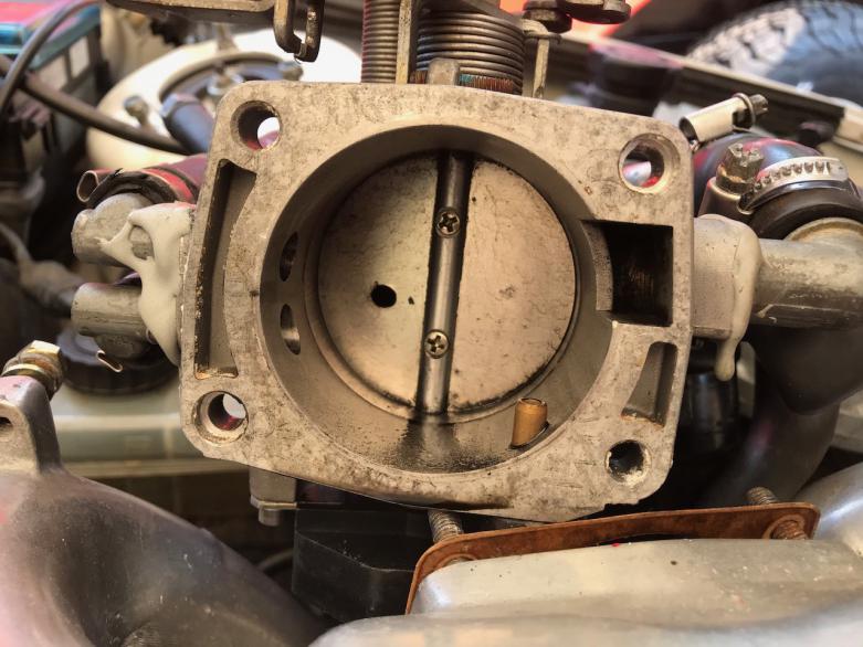

                          While disassembling the top end, I pulled the disconnected the throttle body and discovered this. Anyone see the problem?
                          Anyone?
                          Closer look:
                          WTF is wrong with people? Who would do this? I now have enough spare parts, that I can't track down where this throttle body came from. Three potential sources. Disappointing. Adding insult to injury, the hole is shittily drilled unround. Morons. And why didn't I notice this when I reassembled the new engine? Who knows WTF this did with my idle and tuning issues? Maybe I'm totally off-base, and just exposed a tuning secret that unleashes 20 more HP at idle. Never mind that there are already set screws to adjust throttle the plate opening for the same effect...
