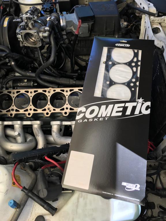

    Going with a MLS gasket from Cometic. Cylinders are bored to 85 mm, so gasket is a hair over 86 mm. Standard thickness.

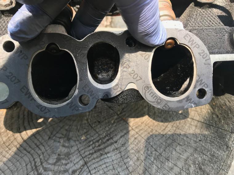

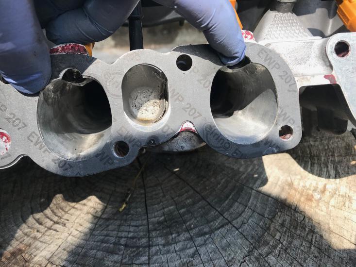

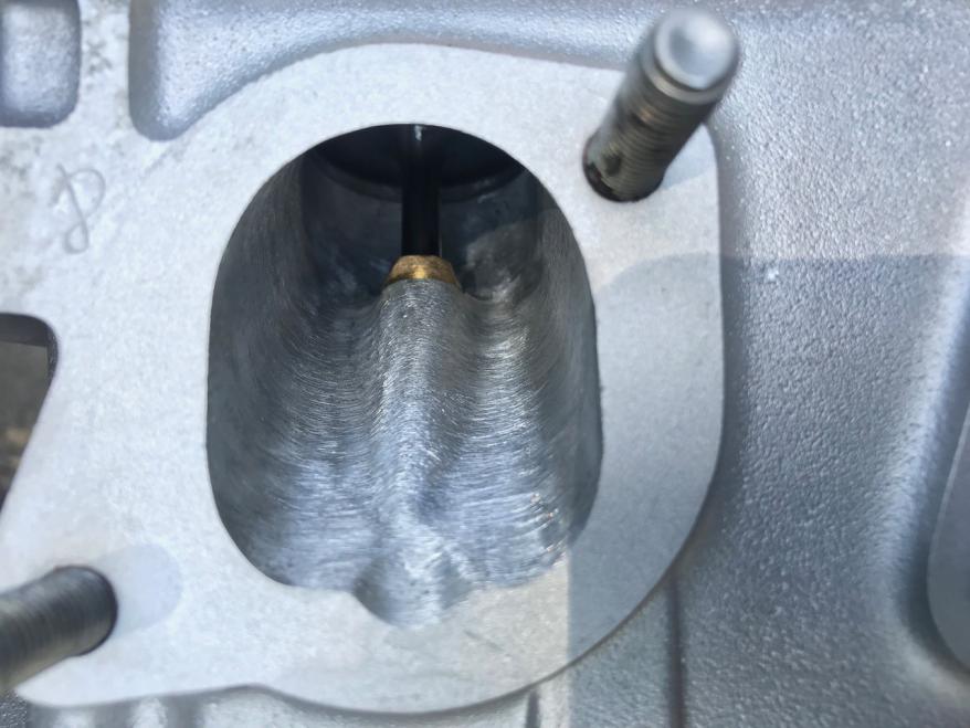

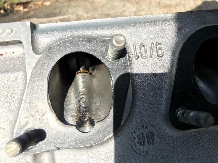

    Here's the difference in porting between stock, mild job from Myster-E, and the latest from a local machine shop that does a lot of M20 engines.

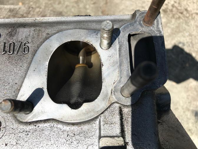

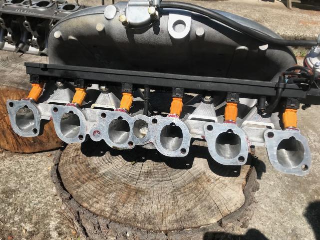

      Speaking of porting, here's the difference in the intake manifolds. I've used this picture before, but since I'm buttoning things up, it's applicable again.
      Click image for larger version  Name:	IMG_8606.jpeg Views:	0 Size:	69.3 KB ID:	10028701
      Click image for larger version  Name:	IMG_8607.jpeg Views:	0 Size:	72.6 KB ID:	10028702
      The gasket fitment is more telling:
      Click image for larger version  Name:	IMG_8624.jpeg Views:	0 Size:	74.0 KB ID:	10028700
      '91 325i

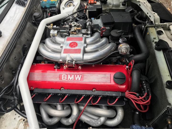

        And here it is all buttoned up, again. This time, with the fresh, full thickness head using new Supertech valves and Schrick performance springs, Cometic MLS gasket, and reusing the 280/272 cam and HD rockers, mounted on a 2.9L block with Mahle Powerpak 10:1 pistons, but this time without the prior fenestrated throttle body. I'll get back to that in a second.
        So, it's pretty damn great. Sounds a little different (I don't know why, maybe I corrected an intake or exhaust leak with this rebuild), and it's definitely faster, significantly, and without the pinging that scared me last time. I gave up some compression, but maybe the headwork improved flow? I dunno, but the car pulls hard especially from 3K and up. Still on a stock chip, will swap in the MarkD chip next. Still considering going to a Megasquirt PnP management system.
        So about that throttle body with the hole in it. I think I understand why it's there. I had trouble dialing in a reasonable idle. Between the lumpy cam and the lightweight aluminum flywheel, the engine was prone to stalling. So I turned the set screw that adjusted the throttle plate to get a faster idle, but then the TPS would shut off, thereby deactivating the idle control valve (ICV), so I got the romping idle. Not enough play in the TPS slotted screw holes to clock in the slightly opened throttle plate. So I think that's why someone drilled into the throttle plate. In this case, I did some grinding on the TPS mounting slots to give more adjustment, but then this prevents the switch from shutting off again at full throttle. I still haven't dialed in the fuel pressure regulator with an air-fuel meter in case the mixture is wrong and affecting idle speed. Once I do that, and if I still have a tuning problem, then I may be forced to go with the Megasquirt to compensate.
