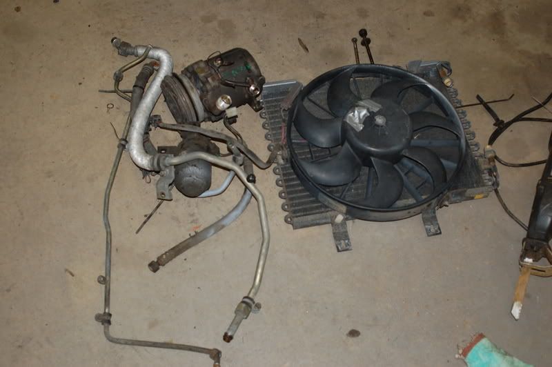

                      UPDATE
                      Not much of an update, but its something. The AC garbage was getting in the way, and causing too much trouble, so it got the boot. Every part of the AC system in the engine bay is gone. I was wowed by the weight of the compressor, Im glad to have it out.

                          Hell yeah buddy, that AC system is heavy. I'm convinced that by removing all of that, my car may have actually lost a few pounds from the M30 swap! 57lbs of extra motor, and 80lbs less AC stuff.
