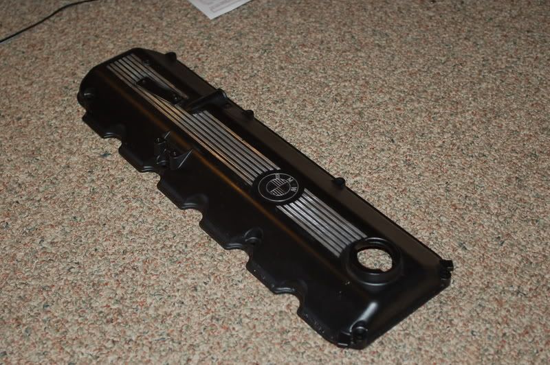

        Quick update, ot really turbo related. Everyone has been hastling me about the valve cover and how shitty it was, so this should shut everyone up. lol
        I sandblasted the original cover, got some high temp paint, then sanded the ribs. I think it looks darn good for a DIY. The intake manifold it next.

          Looks really good. :pimp: Haven't seen that done well on an eta cover before. I think i'll do that at teh next valve adjustment.

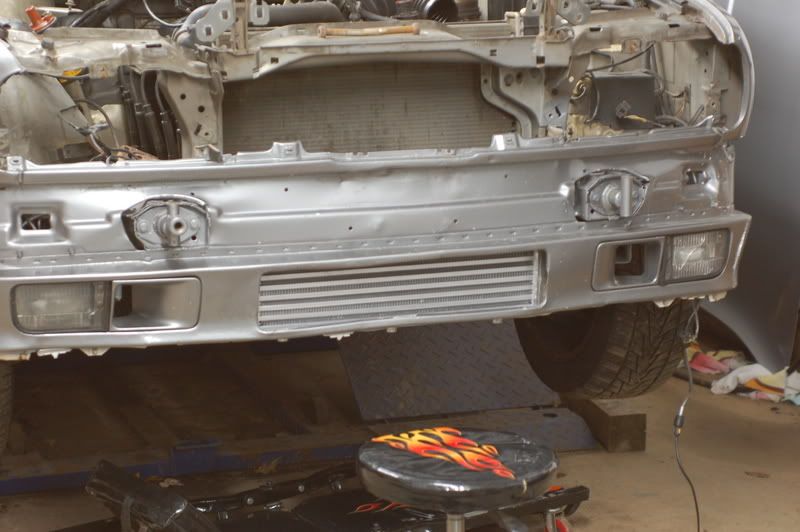

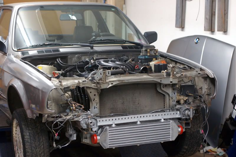

            I'v gotten alot done since my last update. I installed the FMIC, FMU, oil line fittings, and painted the intake manifold. About 5 min. ago I finished cutting out the grills in the valance, I think it looks pretty cool. Some pics of everything below.

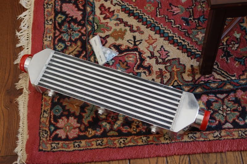

            Intercooler from ebay
            A cheap piece of angle-iron takes care of mounting

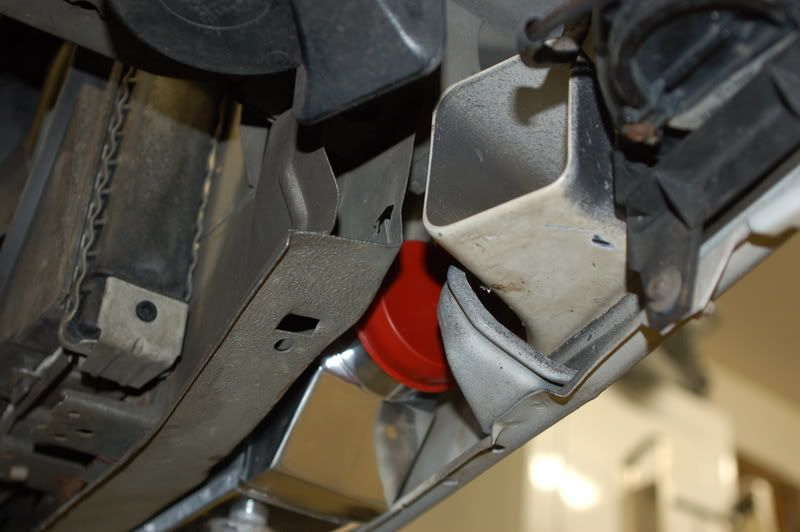

            My first real problem so far is I realized I have to remove the brake ducts with this intercooler. This is why!

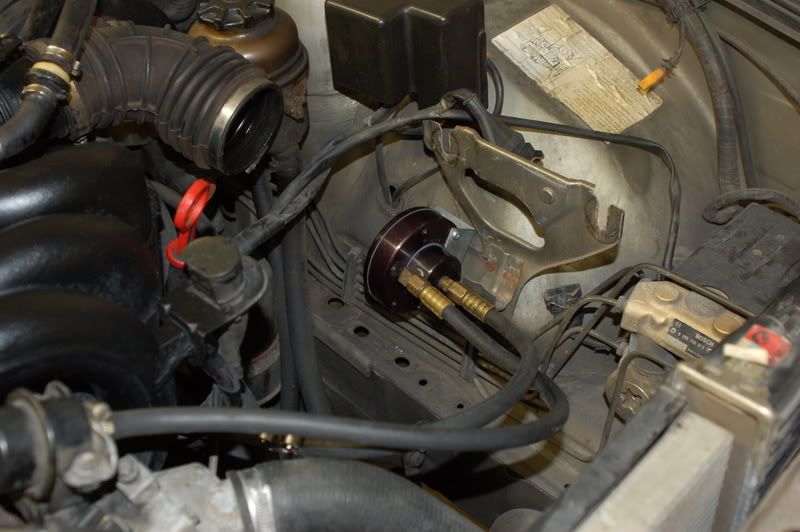

            The FMU installed
            A shot of the fittings. I used a 12mmX1.5 fitting to replace the stock oil pressure switch. From there I installed a tee. One port is for the 90 degree elbo (pictured) and one for the sender for my oil pressure gauge. The actual lines themselves will be going in soon.

            Heres a shot of the valance, with the grills still in place, then a shot of the grills cut out.
            And grills removed

                where did you get the 12x1.5 to 1/8NPT adapter? I need one.

                      Yup, on my old car I couldn't run the brake ducts either. Also couldn't run the fogs [because of not fitting on one side] but that's something I could have fixed with an extra pipe. Oh well.

                        Every local place said they never had them, so I went to fittingsandadapters.com and they had it. A down side of that site is theres a $10 minimum, so I just bought the rest of the stuff I neede too. The site otherwise is great, they have pretty much everything.
