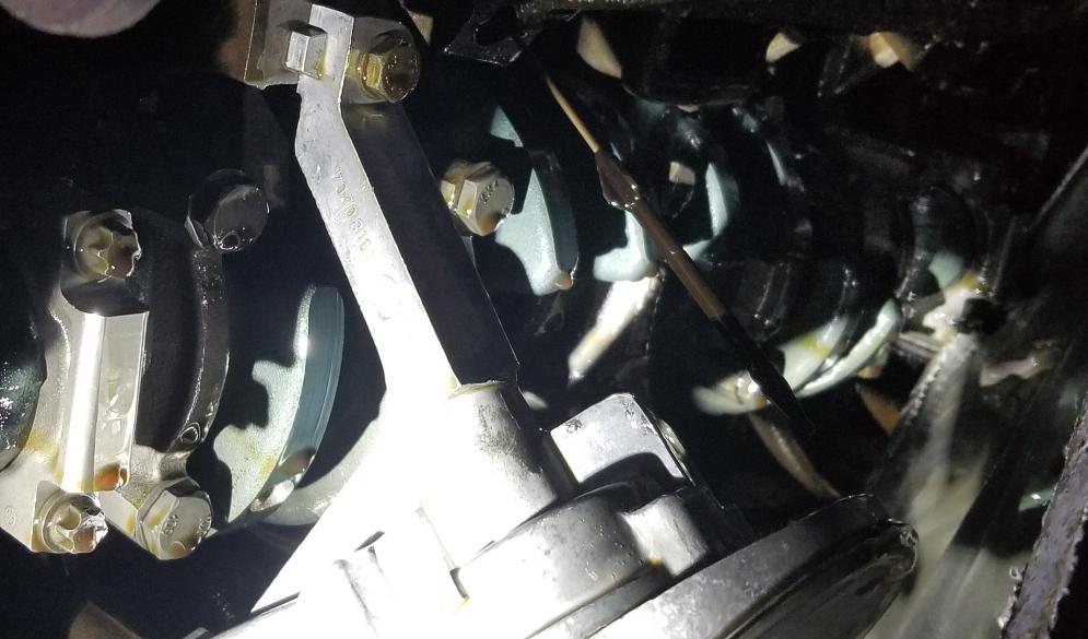

                Had the car on a lift and pulled a bunch of covers on Thursday. Everything looks correct - clearly a forged crank, M52 rods and custom pistons with evidence of the expected balancing. Cam timing was good as well so we're a little stumped. The only thing that makes sense at this point is that the tune is just shite. I'm ordering a Walboro 255 just to make sure I have the proper fuel volume and we've scheduled a date to put the Megasquirt in. We're going to do it in his shop with his resources. ForcedFirebird, what's the best way for me to get in contact with you? I'm willing to pay for the tune and time you can offer so that I'm certain I've got the right set up.

                Agreed, as far as his credibility, at least in terms of the kind of build I'm doing. He was highly recommended by several locals but I'm pretty sure now that they were part of the SPEC e30 racing crowd. He seems to do pretty well in that niche but what I want is a very different thing. Based on some other interactions, I'm about 100% certain he was lied to at this point. This car never made 198 on any dyno. I talked to Bimmerheads myself and they concurred with you - stock ECU and intake on the 2.9l kit = about 180whp. On the other hand, he gave me shocks and strut inserts off of his shelf and he's spent time and lift capacity in his operating business evaluate my car in detail. Apparently he's bought the parts to build a 2.9 for one of his cars. That doesn't sound like a guy who's trying to bamboozle his customers. The bigger thing for me is that I've wanted to go to Megasquirt form the beginning and he didn't want to.

                He has a machinist he works with that does all of his race engines. This machinist has had 885 heads on a flow bench for years with good results and there's also dyno proof on that work. The clubs they race in require dyno results to start the season as well as to validate podium positions in all classes. I understand that it's had a three angle valve job as well as some gasket matching and a few other things. I can't remember where in the head but he talked about increasing velocity and some dimpling done to create some turbulence. I get the theory and it seems to line up with what I read in what ForcedFIrebird posts. I'd have to have John's work and the head off my car next to each other to know any kind of difference though.

                We're trying to get pictures of how the piston tops should look. Bimmerheads insists they're good pistons and they insist they've made well over 200hp on them. Whatever the case, I'm not terribly concerned that they aren't the #1 most perfect option. I'm not trying to squeeze every last horse out of the build. Clearly, what I have should be better than 160, specifically with the stand alone ECU. If it doesn't make 200hp I won't cry, but I do want to understand why it doesn't and what I should expect from it. I think I'm getting there.

                  Look for an "84" stroke mark on the crank. M20's have 75 or 81 on them...I assume the 2.8's have them as well. Someone chime in if they know for sure.

                          84mm and more do not. Easy way to spot a 75/81mm, though. For the larger cranks, you must use the casting numbers for identification:

                                Have we confirmed that it is an 84 mm crank? The balancing pads on those rods look huge compared to the M 42 world from which I come.
