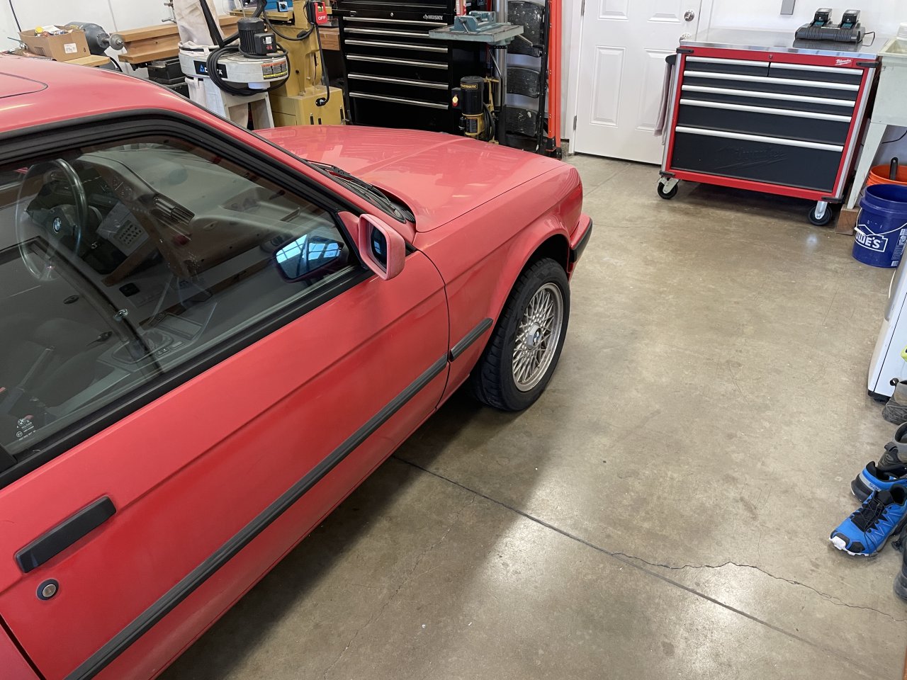

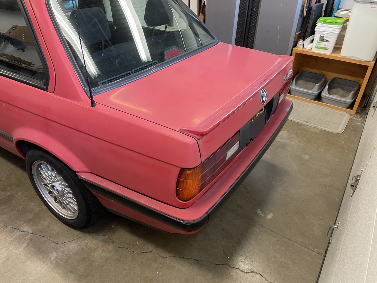

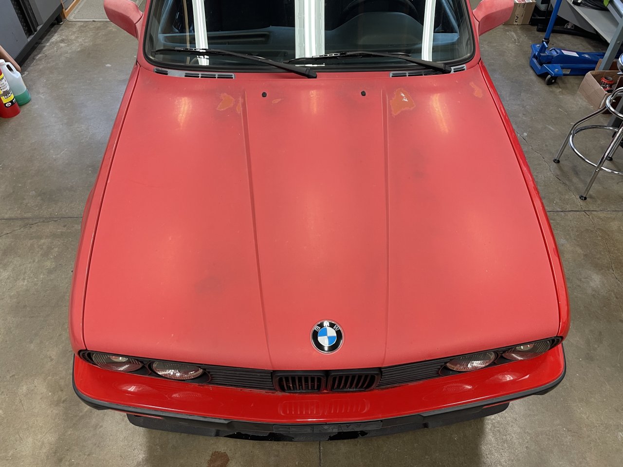

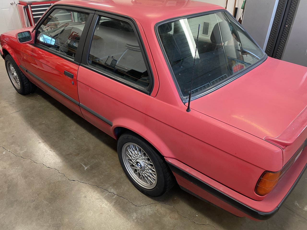

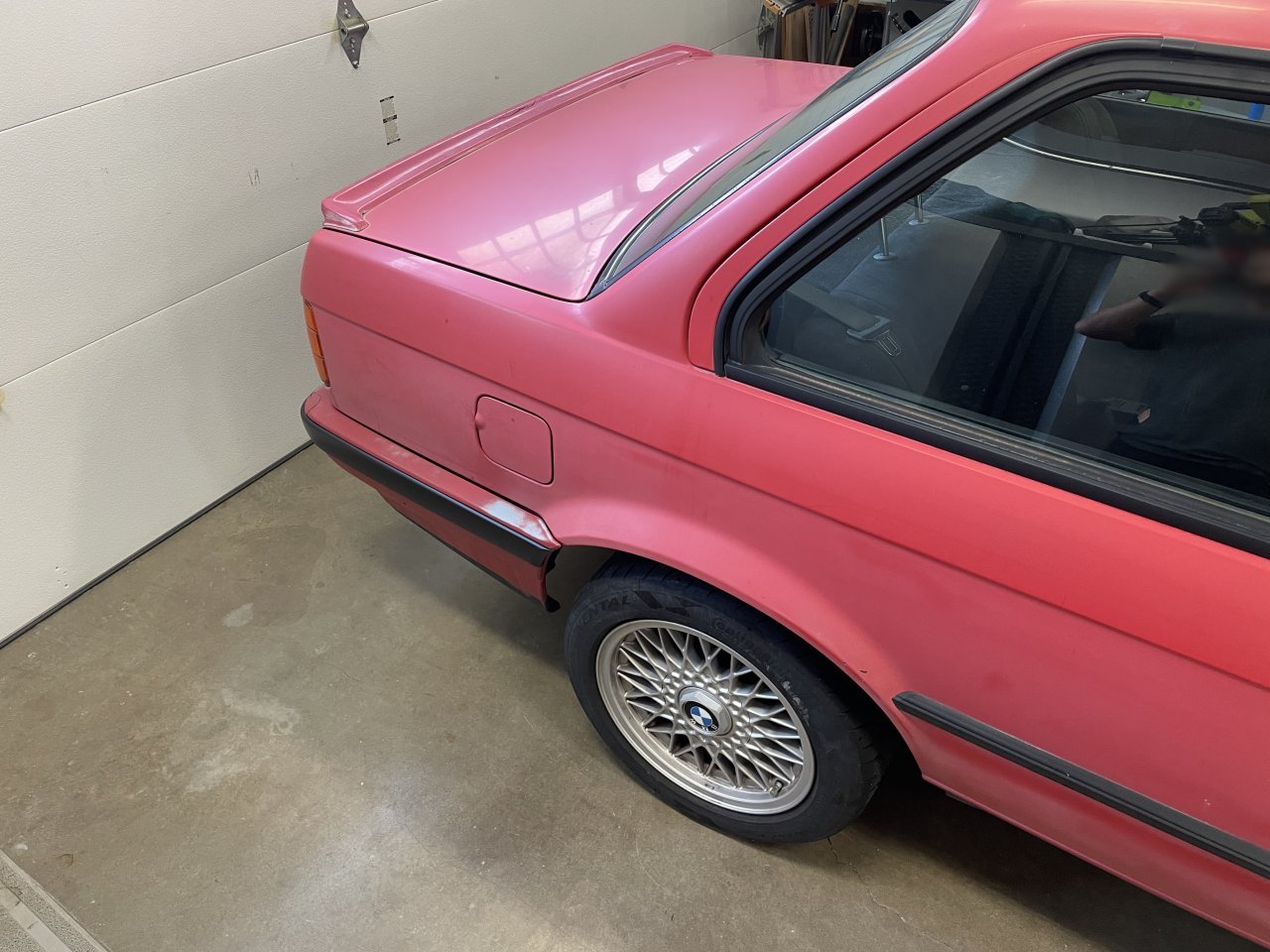

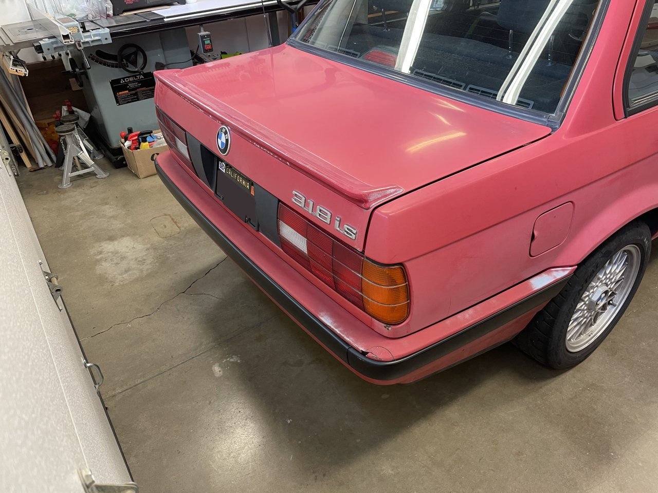

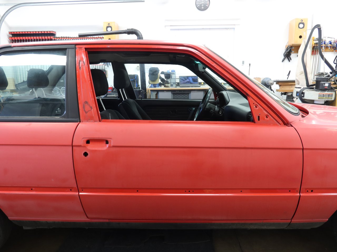

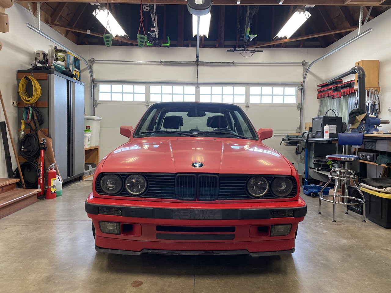

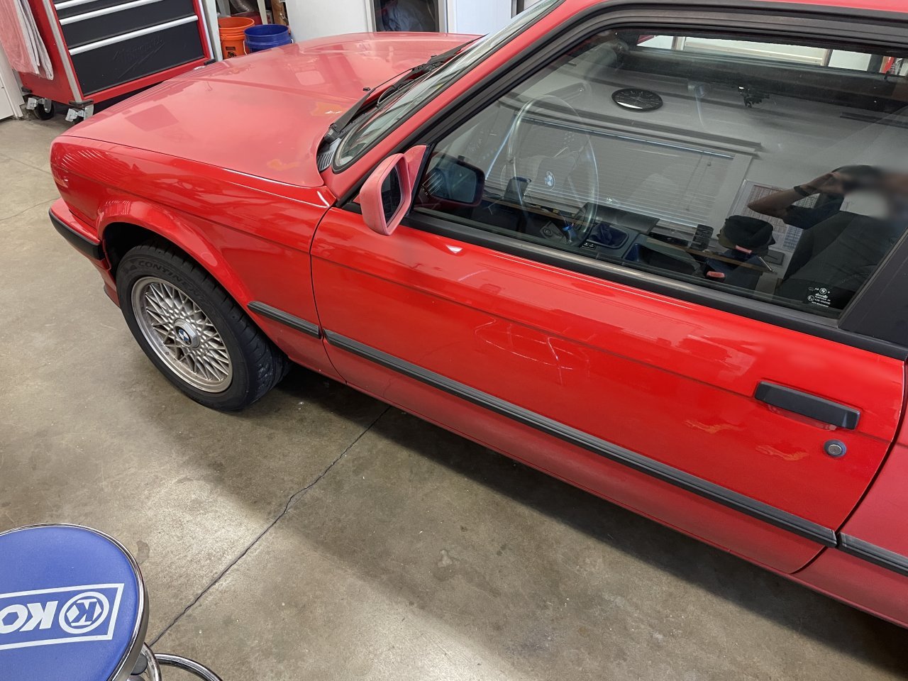

    Some photos of the car as it looks today. SAD. Has not seen wax since early 2019 when I decided to repaint it.

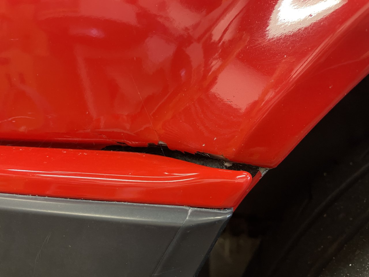

    Back in 2006 I got into a little fender-bender at the front driver's side. At the time it was my only car and I needed to get to work, so I had insurance deal with it. The shop did a poor job for sure. Orange peel, drips, and more recently the paint has been peeling due to improper prep. The shop basically said they didn't like dealing with older cars, but I was sort of in a pinch. At least the other party in the accident was at fault, so it did not cost me anything. Still, I will be glad to get rid of this crap.

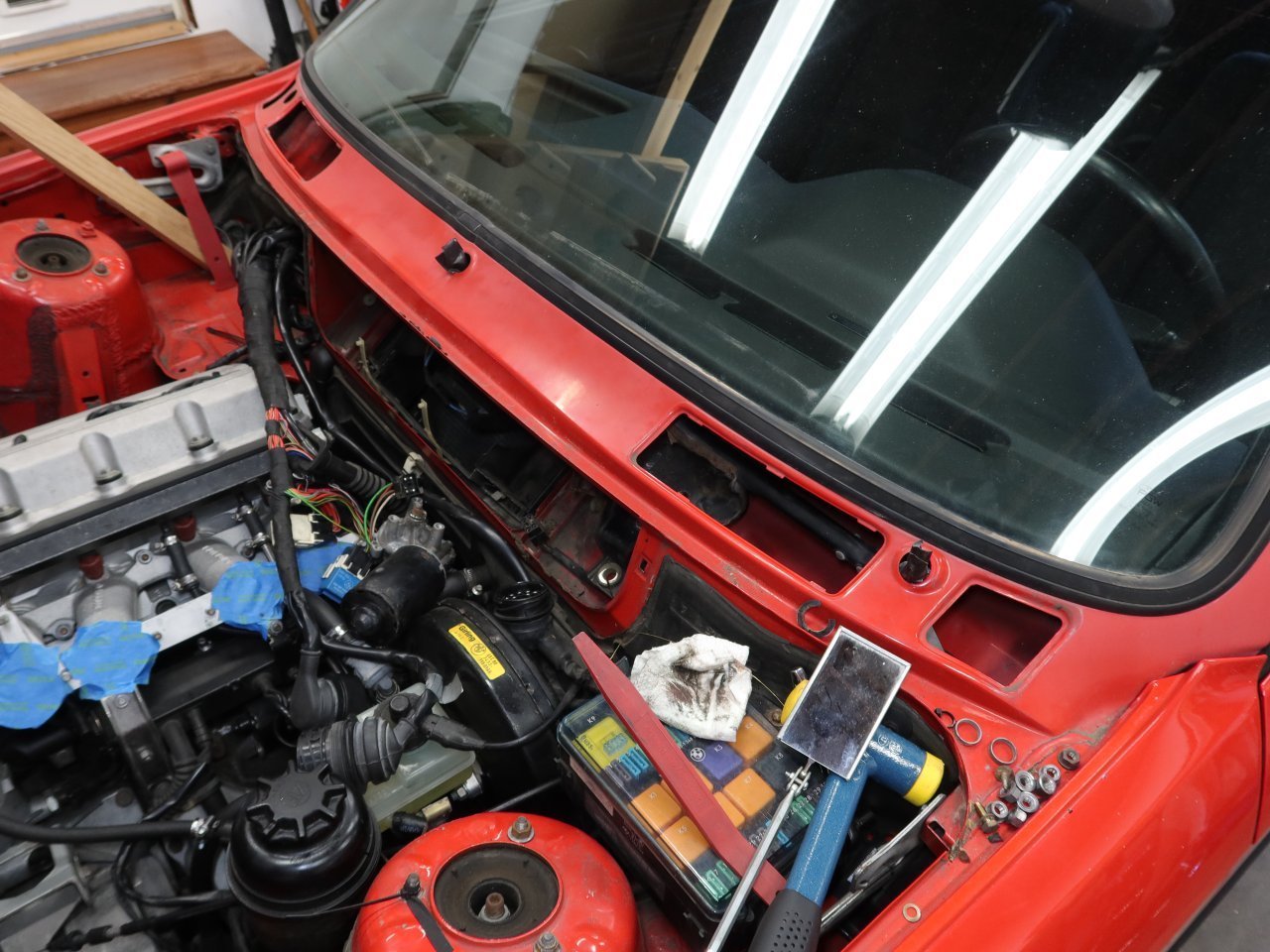

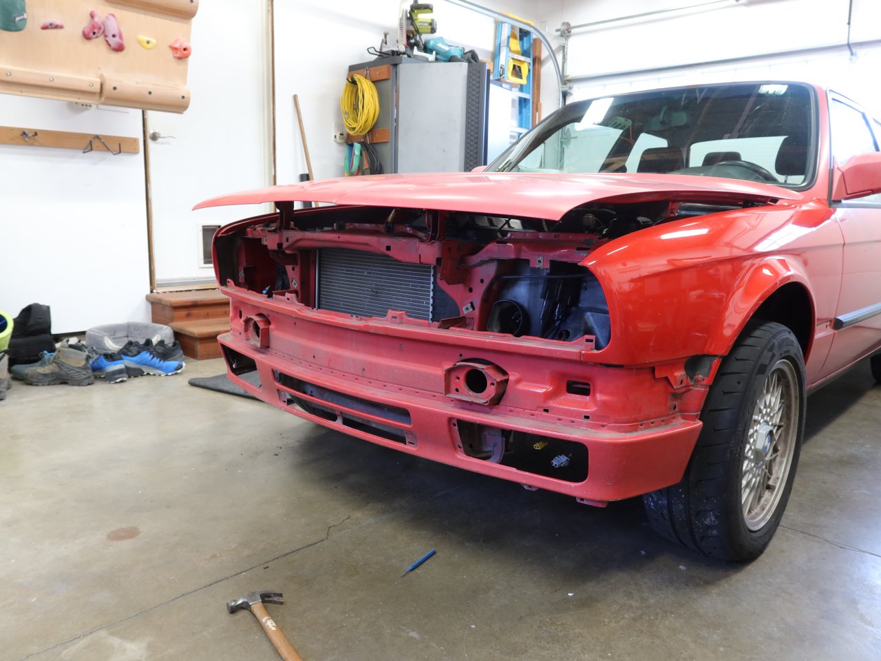

    I did get going on disassembly today. Part of my cost control for this project is DIY'ing as much mechanical work as possible, which will basically be everything except removing the doors, fenders, hood, and trunk (although I will prep all of them for removal as much as possible).

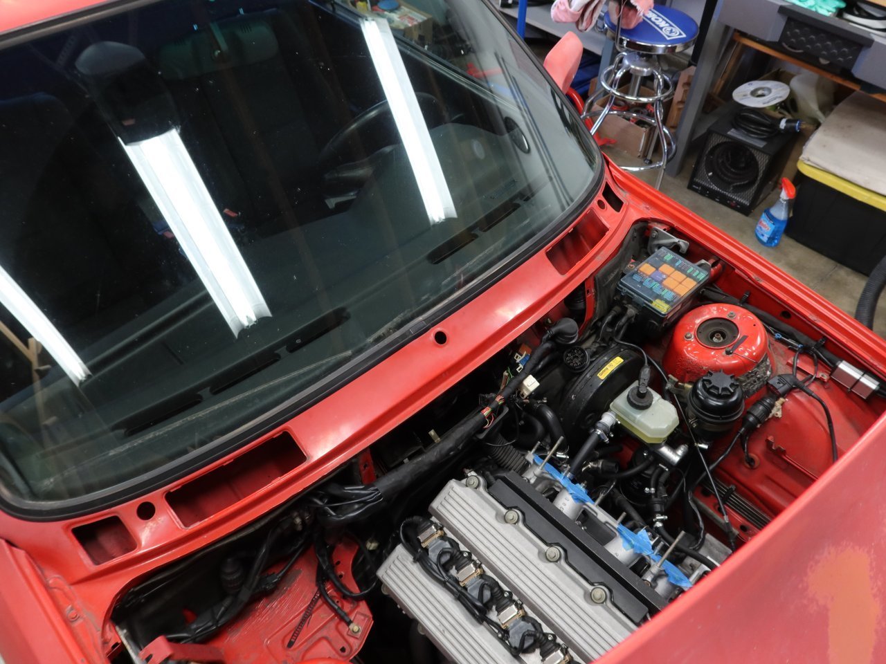

    I got the front third of the car completely ready with a few hours of work. Despite my seeming thoroughness when I ordered parts in 2019, I found a rather long list of little fasteners and body-nut type things that I will need to order since all of the old plastic ones are in shabby condition, and some of the metal ones are as well.

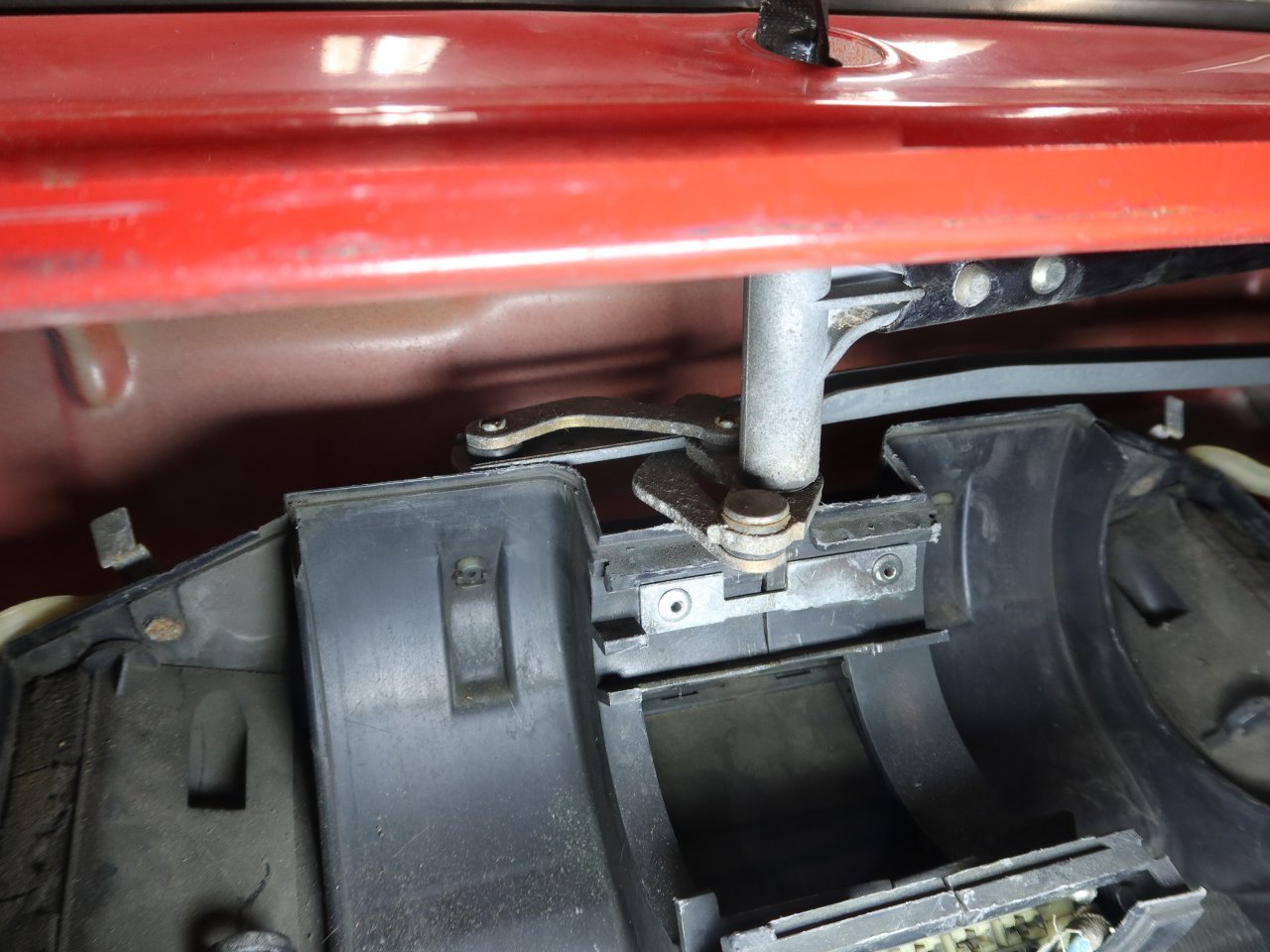

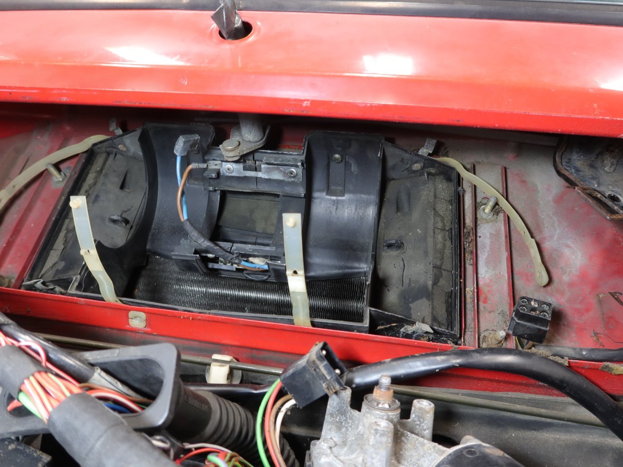

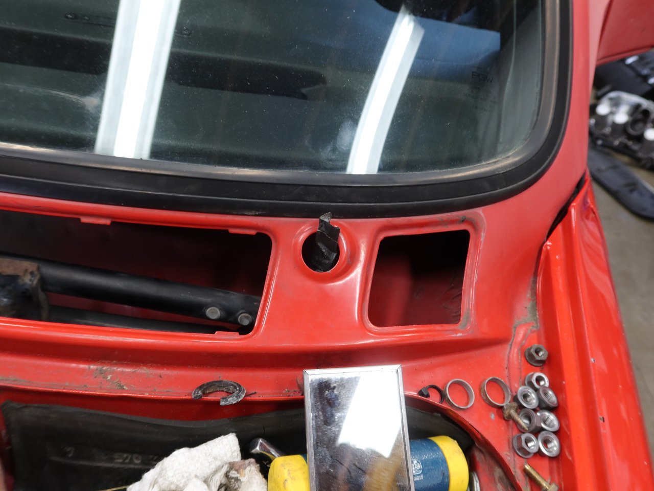

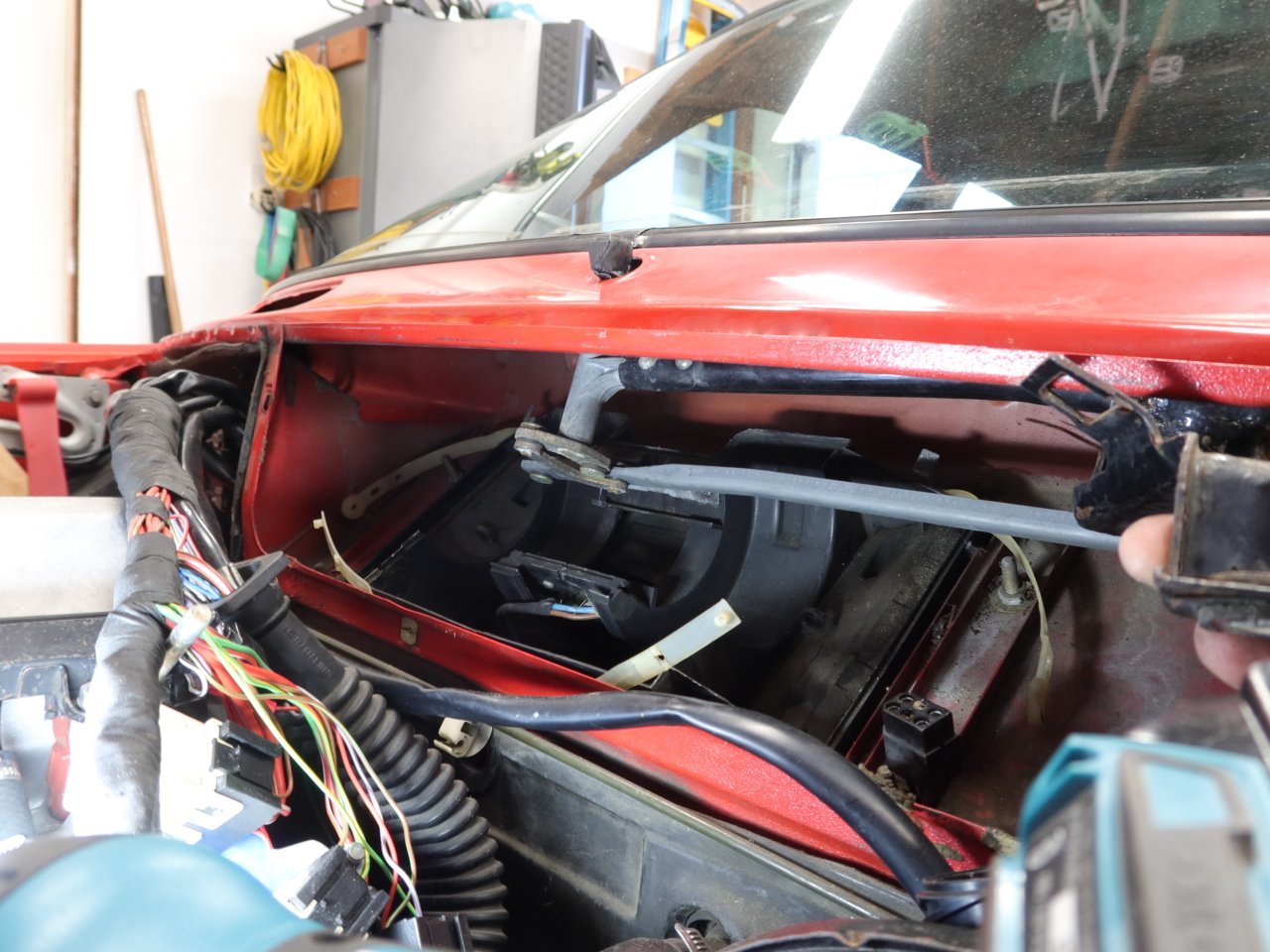

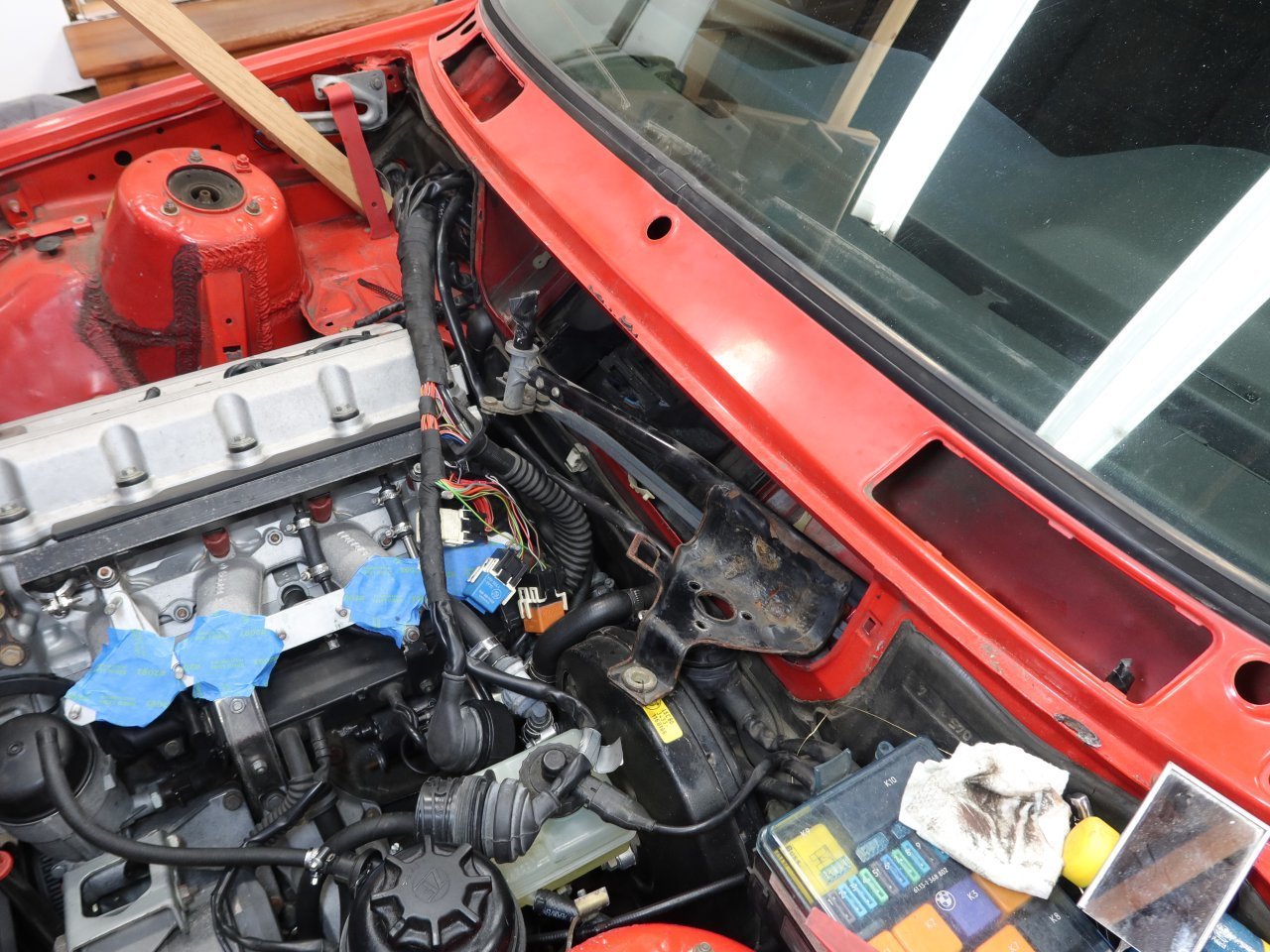

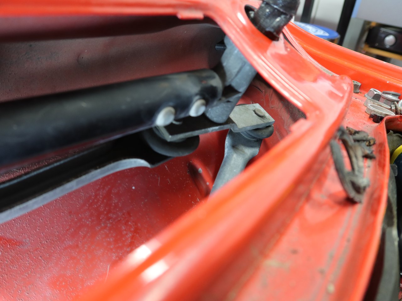

    There was a first for me as well. I have never had the pleasure of removing the wiper linkage/motor assembly before. When I realized that I was going to need to pull the strut brace, intake manifold, part of the engine harness, and blower motor, I was less than thrilled. At first I thought about just sort of dropping the assembly so it would be out of the way, but it is original, a little rusty, and the wipers did seem to be struggling a bit over the last year when I turned them on. So, I will just replace the whole thing.
    At first I simply could not figure out how to get it out. Even with the upper blower cover removed (which I did by popping the air flaps out entirely, and popping the 4 metal clips in the corners off), things were not looking good and I was feeling stuck. At that point I took a break to go grocery shopping with my wife, and consult some old r3v posts on my phone. After the little break, I got back in there, removed the motor from the bracket, pushed the linkage to one extreme, and the thing came out very very easily. So the keys here are removal of the motor, and setting the linkage as shown in the below pictures. Leave both of the wiper posts up in their holes when doing this, and with them up in their holes rotate the bottom forward until the passenger side clears the blower housing, and then it will drop right out. Also I recommend putting some tape on the posts to avoid scratching up the cowling.
    Everything else was pretty straightforward. As far as I can tell, I got everything off of there which will need to be off.

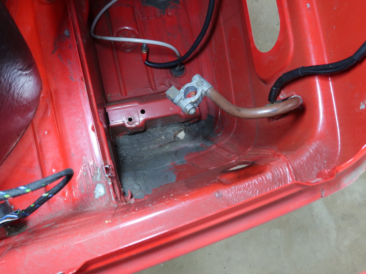

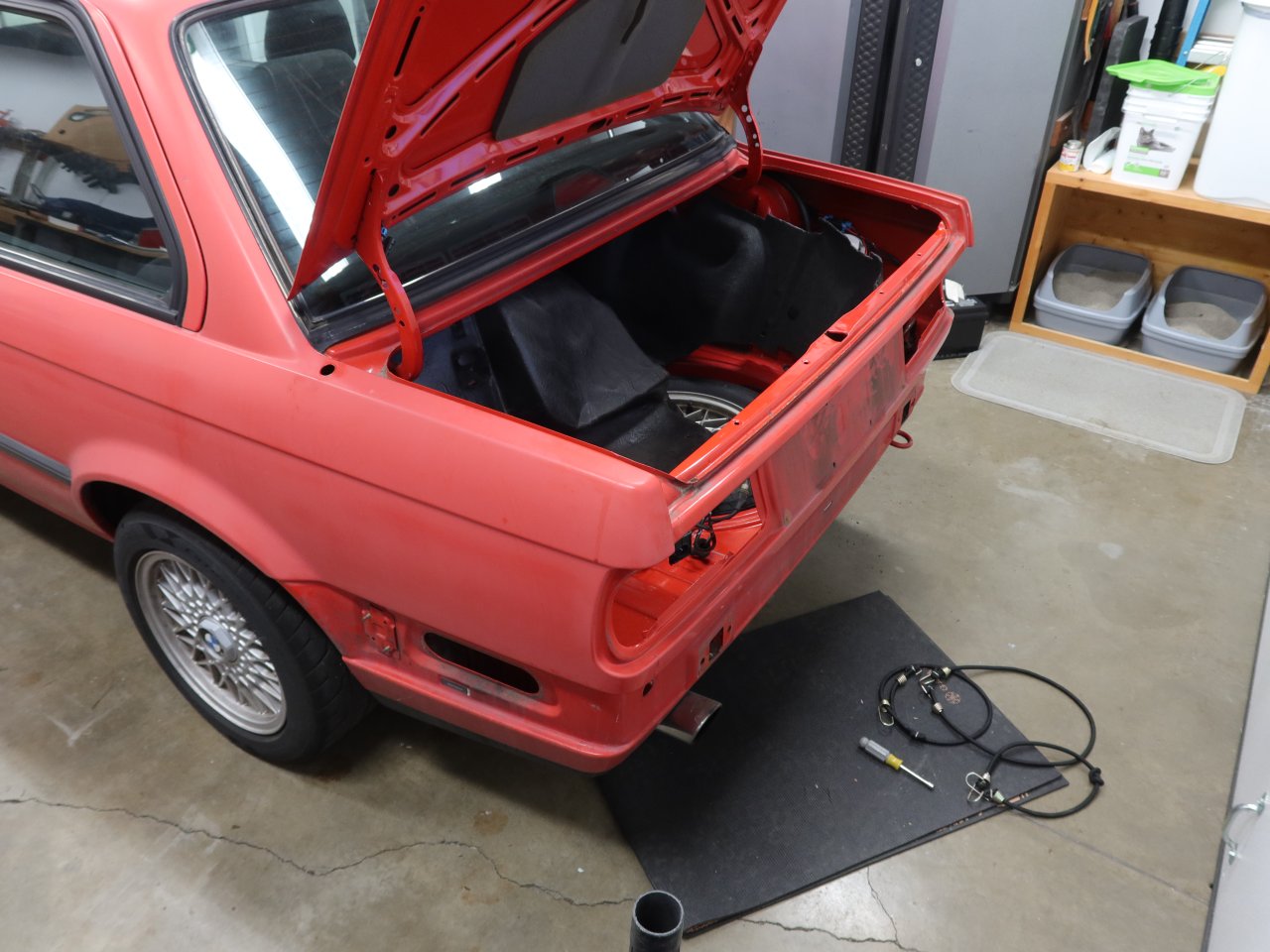

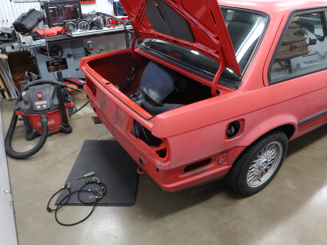

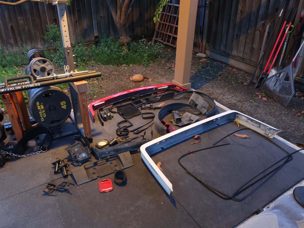

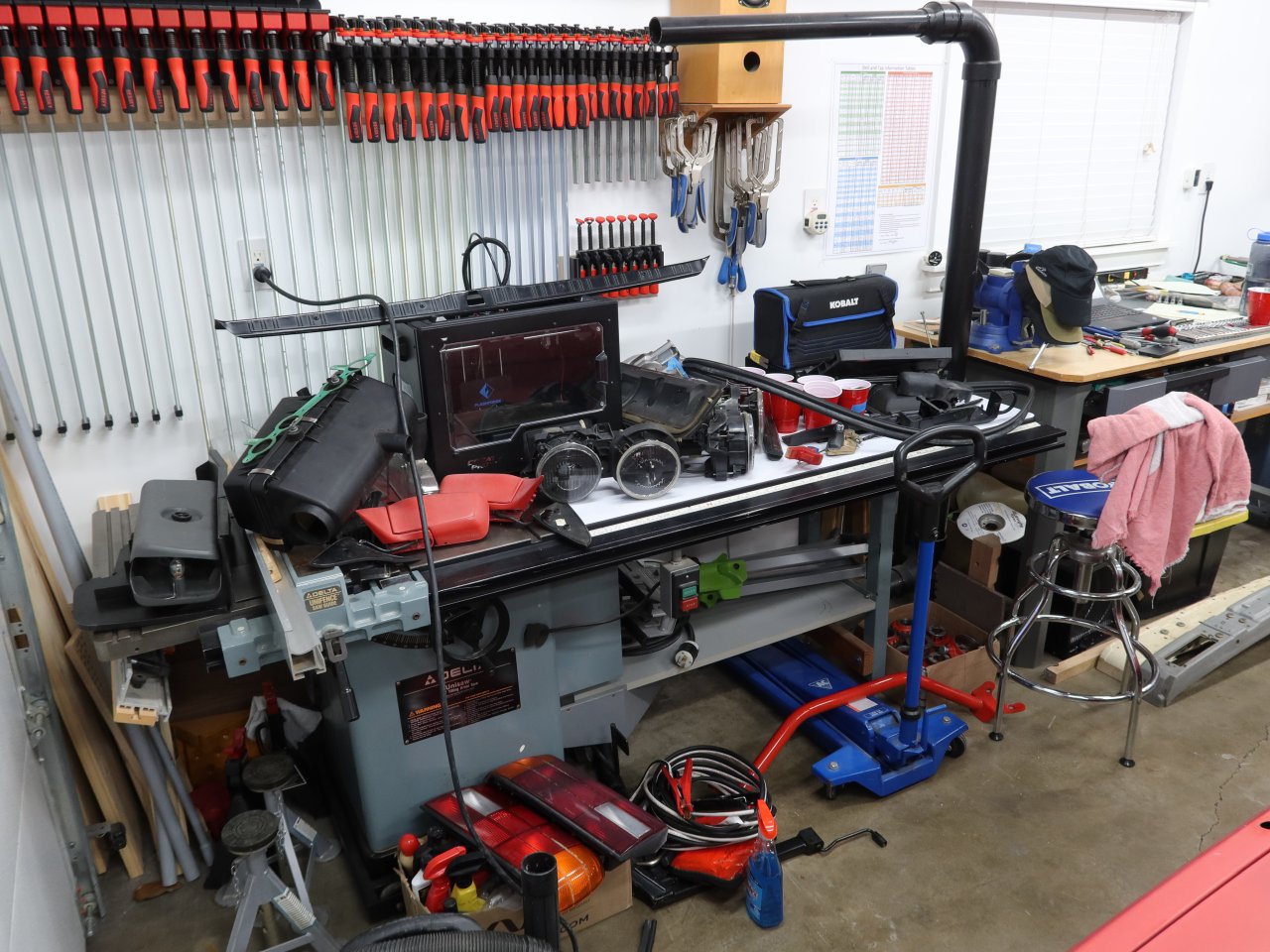

              The rear portion of the car is mostly done being taken apart. It all went pretty smoothly for the most part. The one issue, and I sort of had a suspicion that it was going to be there, was a rust patch under the battery compartment. Once I got everything out, I gave an ugly-looking spot a poke with a screwdriver, and it crumbled out. I sent a pic to the body shop for evaluation. It turns out that you can get various replacement E30 sheet metal panels, including this one. So the plan will be to cut out the affected portion, buy the replacement panel, cut out the corresponding patch, and TIG it in.
              The rest of the rear end came apart in a couple of hours.
              So far I have a pretty good pile of parts coming off of this thing. Some is being reused, some is being painted and reused, and some is being replaced.

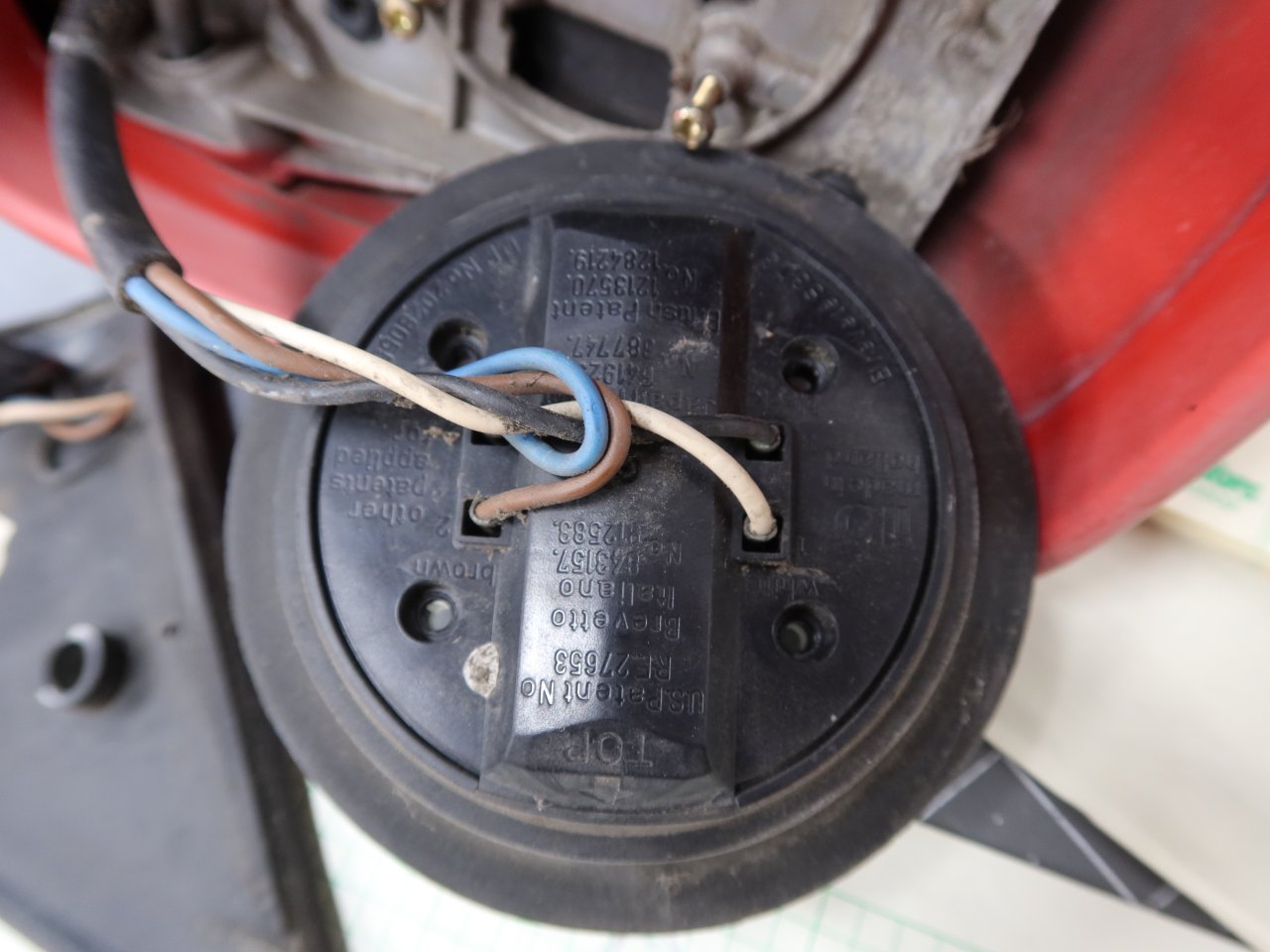

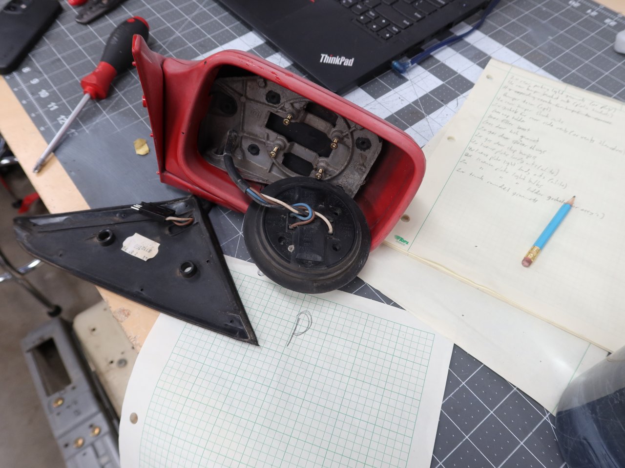

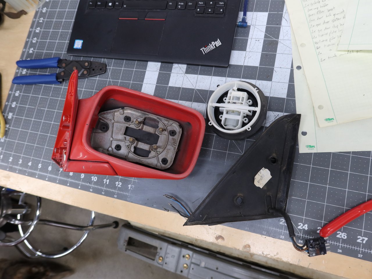

              I also finished taking the side mirrors apart as much as possible. The plastic housing is heat-staked to the aluminum mount/pivot, and the halves seem to be glued or ultrasonically welded together, so there is no practical way to get them separated any further. The wire harness can easily be unplugged from the motor assembly and then snaked out of the entry hole. The trick is to get the cable sheath out of the hole, and then pull one of the wires with its terminals out. After that there is enough room to pull the rest of the wires through.

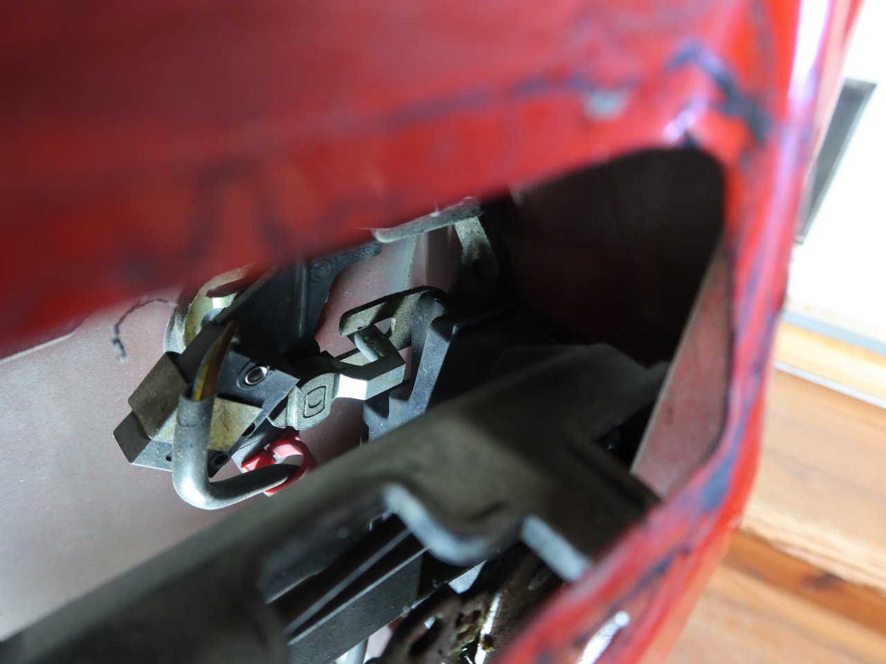

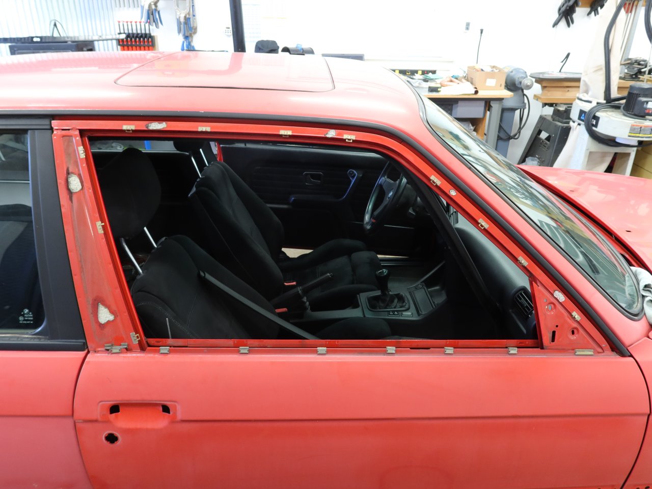

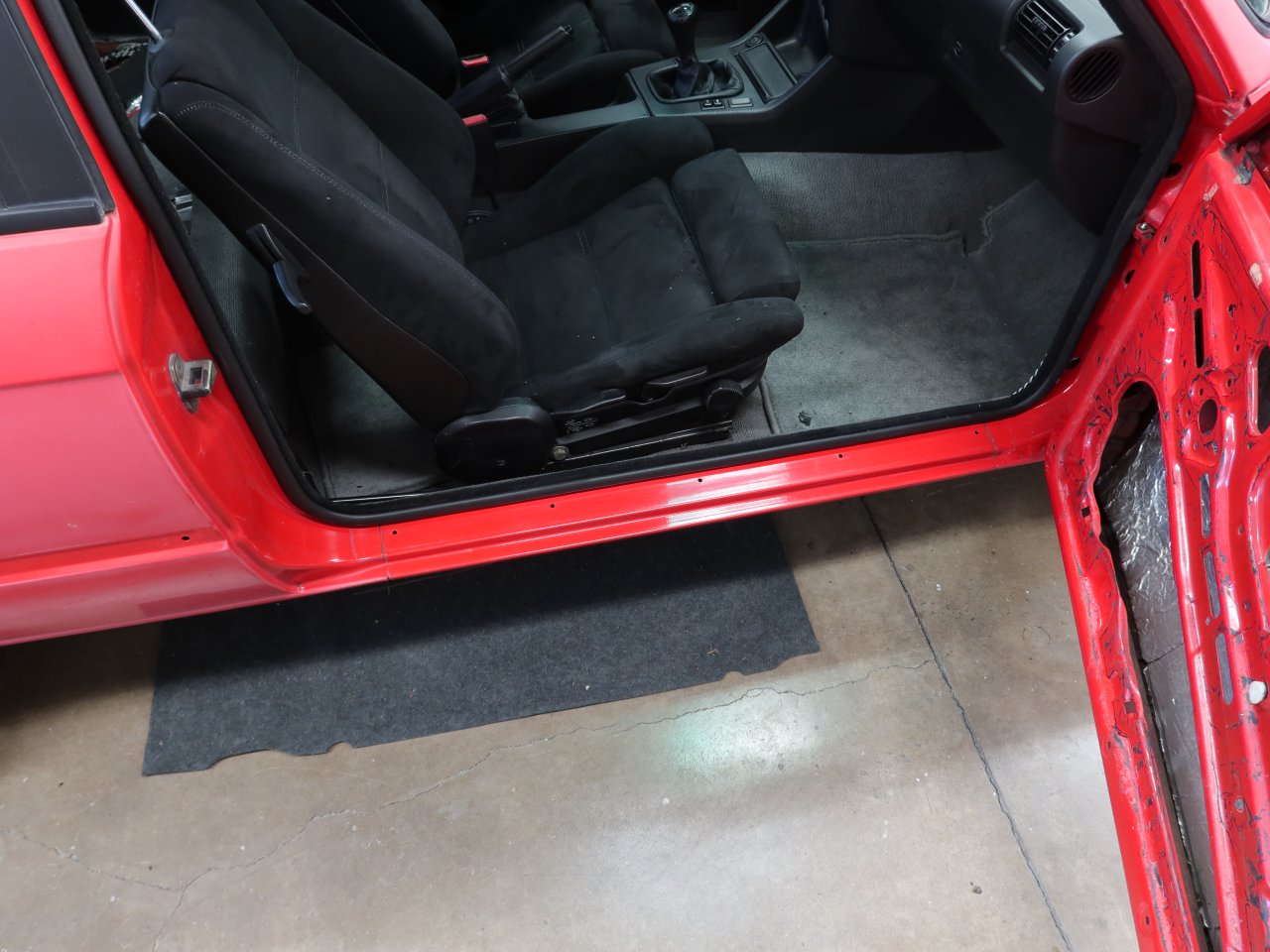

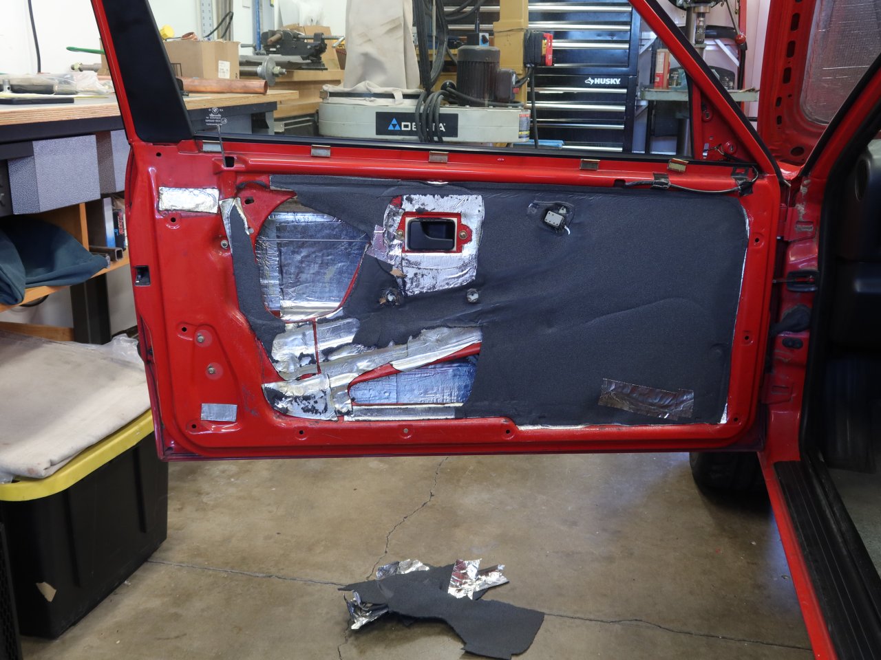

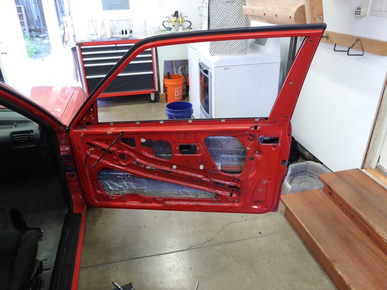

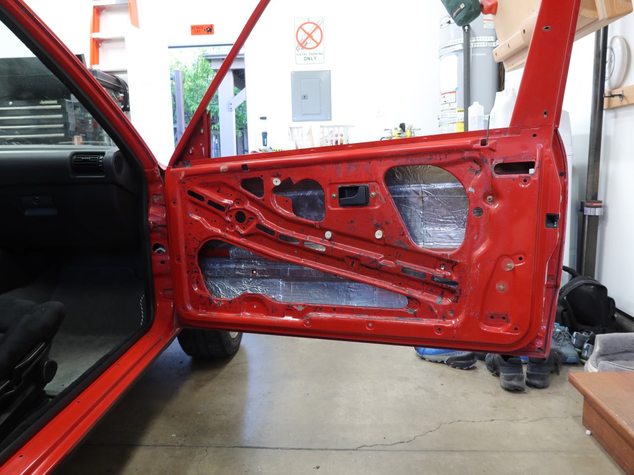

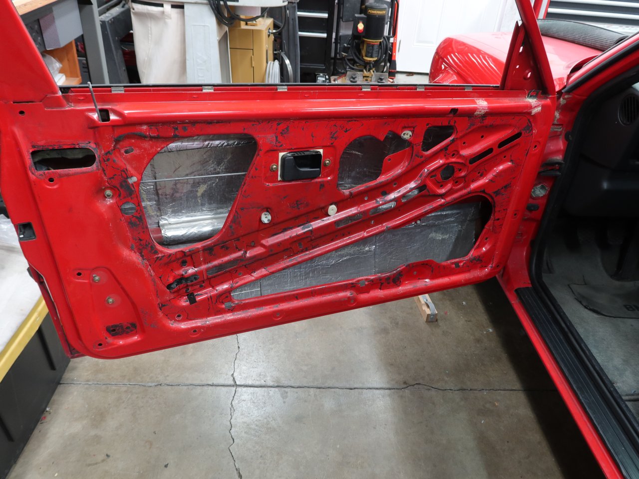

                        Yesterday I got the passenger side all torn down. Here is how it looked after removing all of the sound deadening that I (should not have) installed on the inner frame 12 years ago. Removing it was a real chore, and you can see the residue all over. With that out of the way, it was super simple to get the window, regulator, wire harness, and seals out.

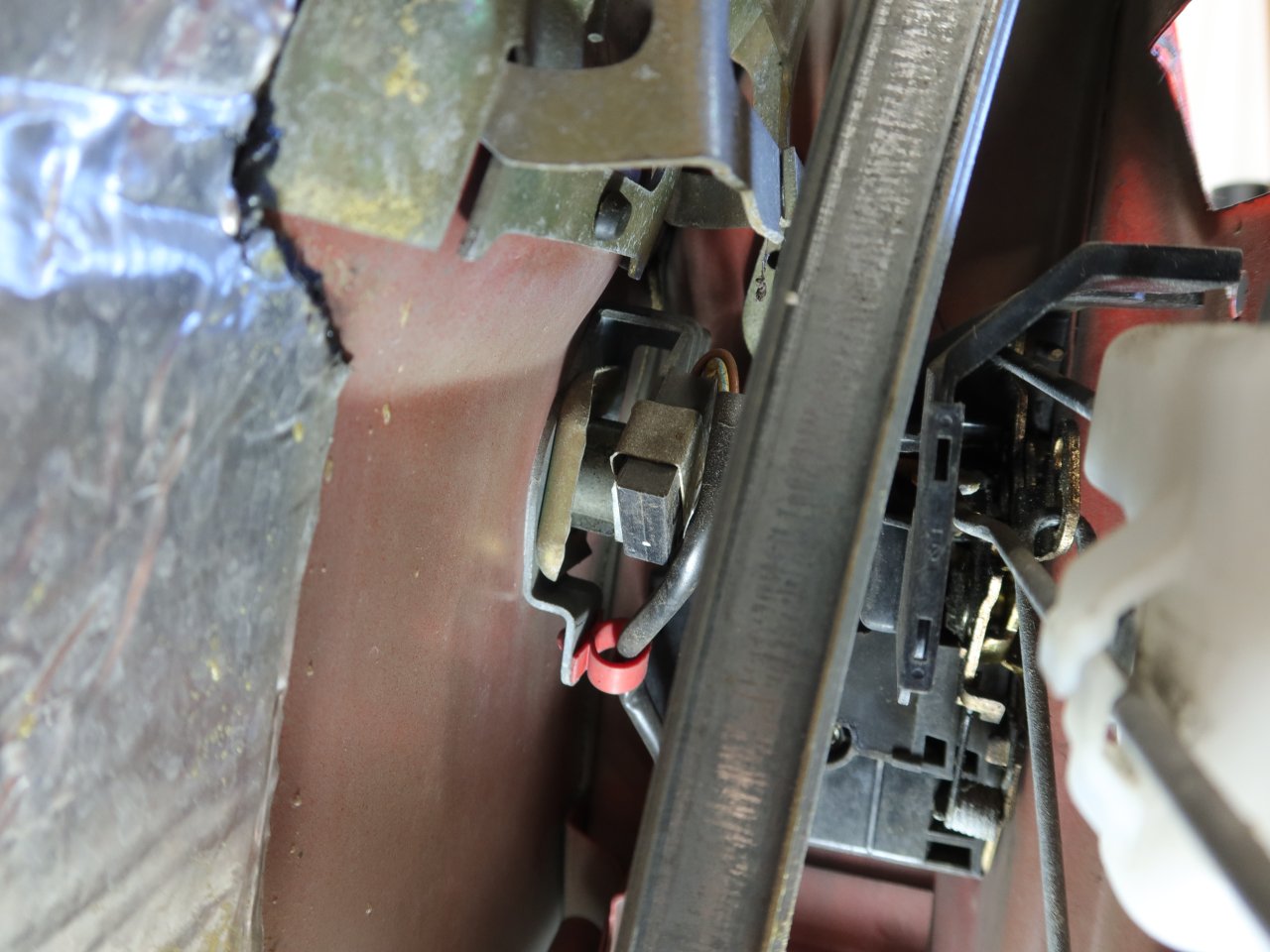

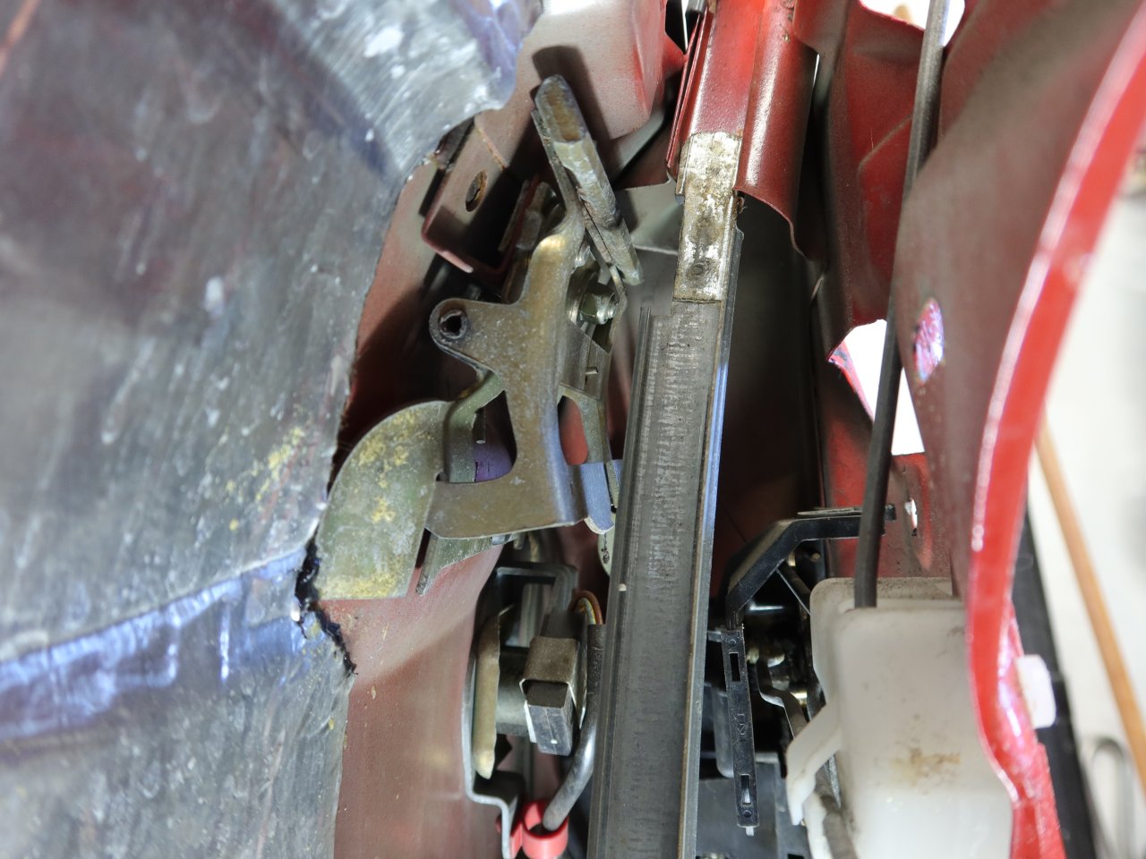

                        Getting the door handle and lock cylinder out was also fairly easy. The handle comes right out if you remove the window guide channel first, and the notorious C-clip that holds the lock cylinder in is fairly easy to pry out with a screwdriver. Here are some nice clear shots of those items before removal for reference.
                        Much to my surprise and delight, the plastic trim at the rear of the door came out without being damaged. Just get a plastic trim tool in under it and pry it out of these 3 clips.

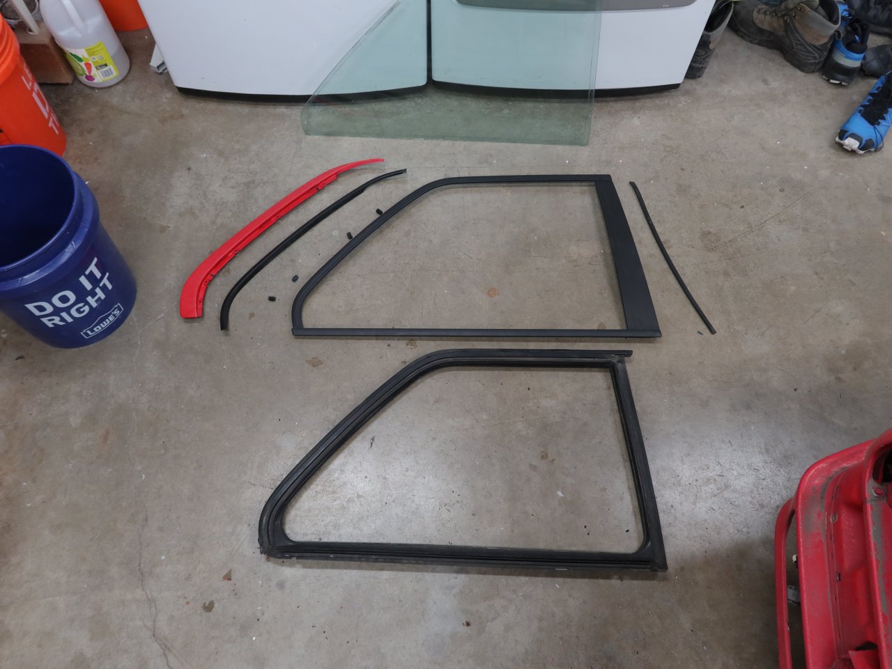

                        As far as removing the aluminum window trim, it had me sweating a little since I had never done it before, and the stories of how easy to bend/kink it had me a little worried. Overall it is easy to remove, but it is equally easy to bend the crap out of it if you are not exceptionally careful. You know how you pull on a wrench with a stuck fastener in a tight space, where you want to apply a lot of force, but let up the nanosecond that the fastener comes loose so that you don't bash your hand into something? This is just like that, except you are letting up to avoid ruining the trim. I would say that this is most applicable to the bottom strip under the window in the door since it is probably the most securely clipped in, and also the flimsiest piece by far. I did bend it a little when it got stuck on one of the clips, but I was able to straighten it by hand VERY slowly and VERY carefully. If I hold it up and look down the length, there are a couple of very slightly bent spots, but they are only visible when looking right down the length while pointed at a fluorescent light. There is no kinking thankfully. Jordan's excellent guide was invaluable here, along with this YT video.
                        Also, there is some sort of putty under some of the trim pieces, I assume to prevent vibrations. It is soft and comes right off.

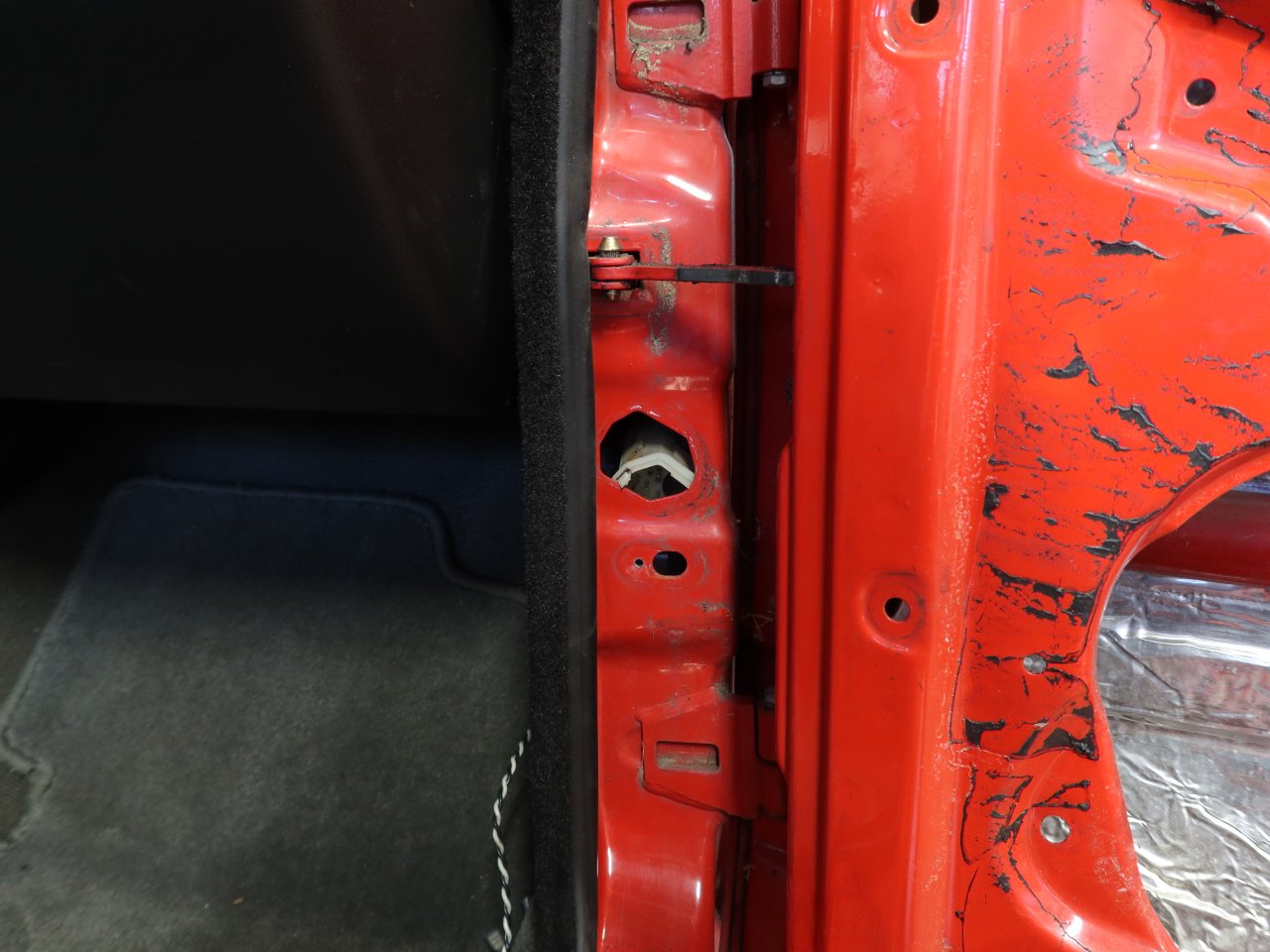

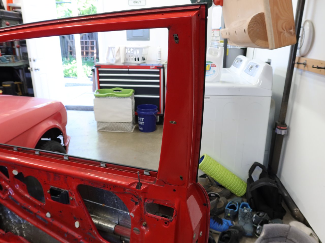

                        Here is the door and jamb area, all cleared out. The inner sill piece is such a damn PITA. I have had it off before, and it never gets any easier. Since I have new ones, I just ripped the old one straight out and let it shatter since it was cracked anyway. And the stupid little clips that it sits on...those were a real chore to try to pry out. Two of them are now living in the lower rocker channels as the tops just broke off. Oh well...

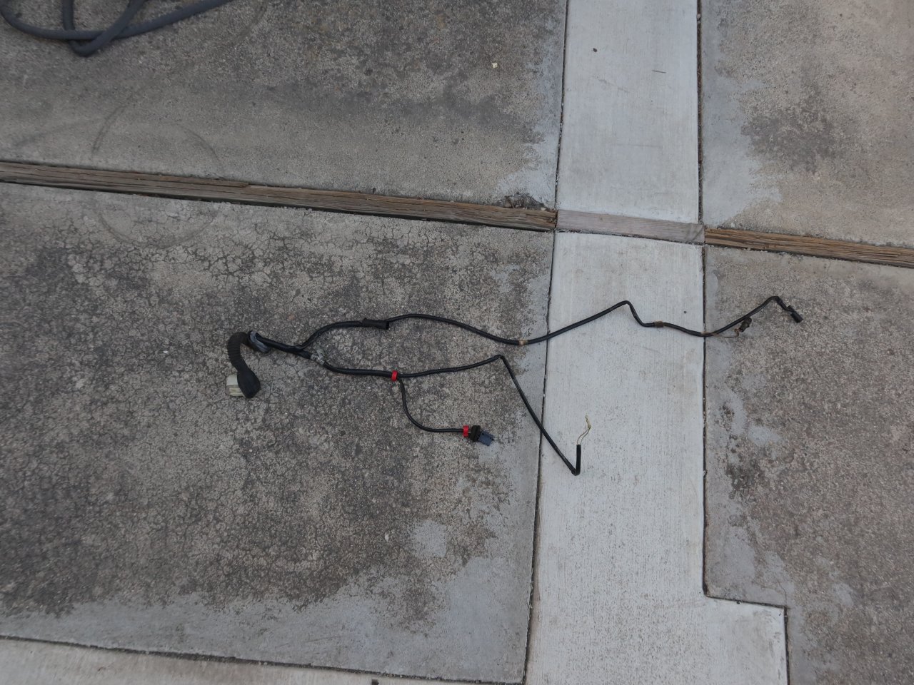

                        The door harness had like 4oz of water in it. It must have gotten up in the sheathing. Not my favorite design form BMW. I am going to clean these up and properly seal them before reinstallation.

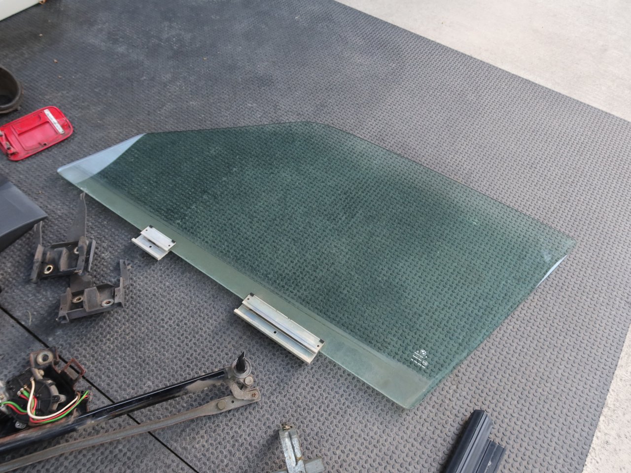

                        Now that I am removing glass, I need to get some 2-by lumber and make a rack for it. OEM replacements are obscenely expensive.

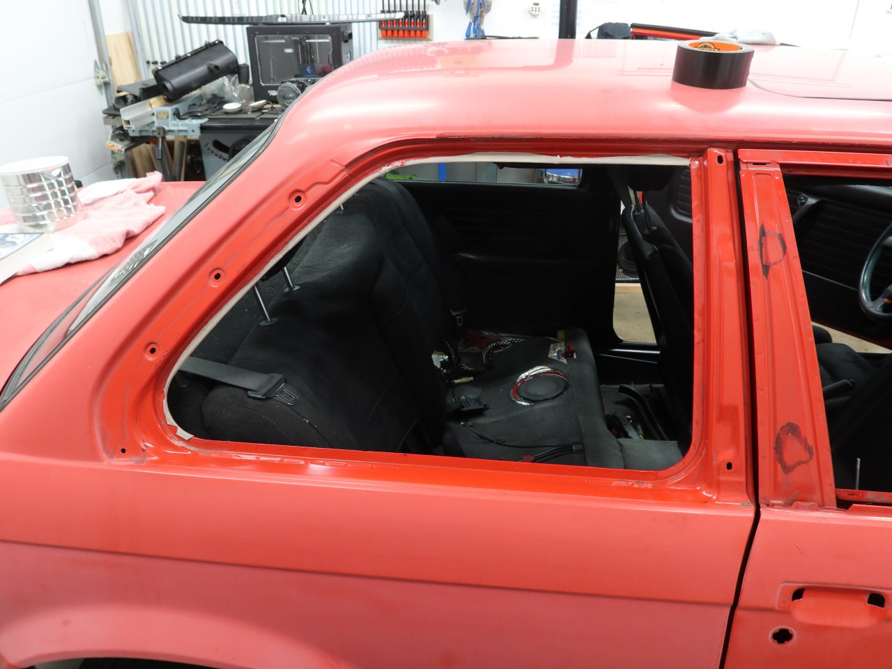

                        Another first for me was removing the rear quarter glass. Getting it out took some intense prying of the inner seal lip with trim tools, and some firm pushing. Reinstallation is starting to look to me like something that I will want to pay a professional for. Also, I had not realized that the rear window trim was a) a single assembly, and b) the lock strip (sort of) for the window glass in the seal. Interesting design. No rust found anywhere in the perimeter of the car window frame either!

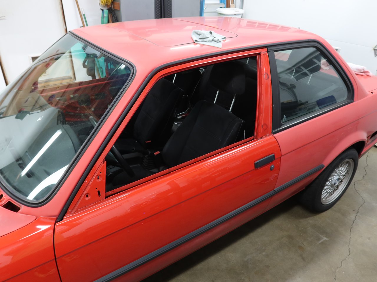

                        ----- Driver's Side -----

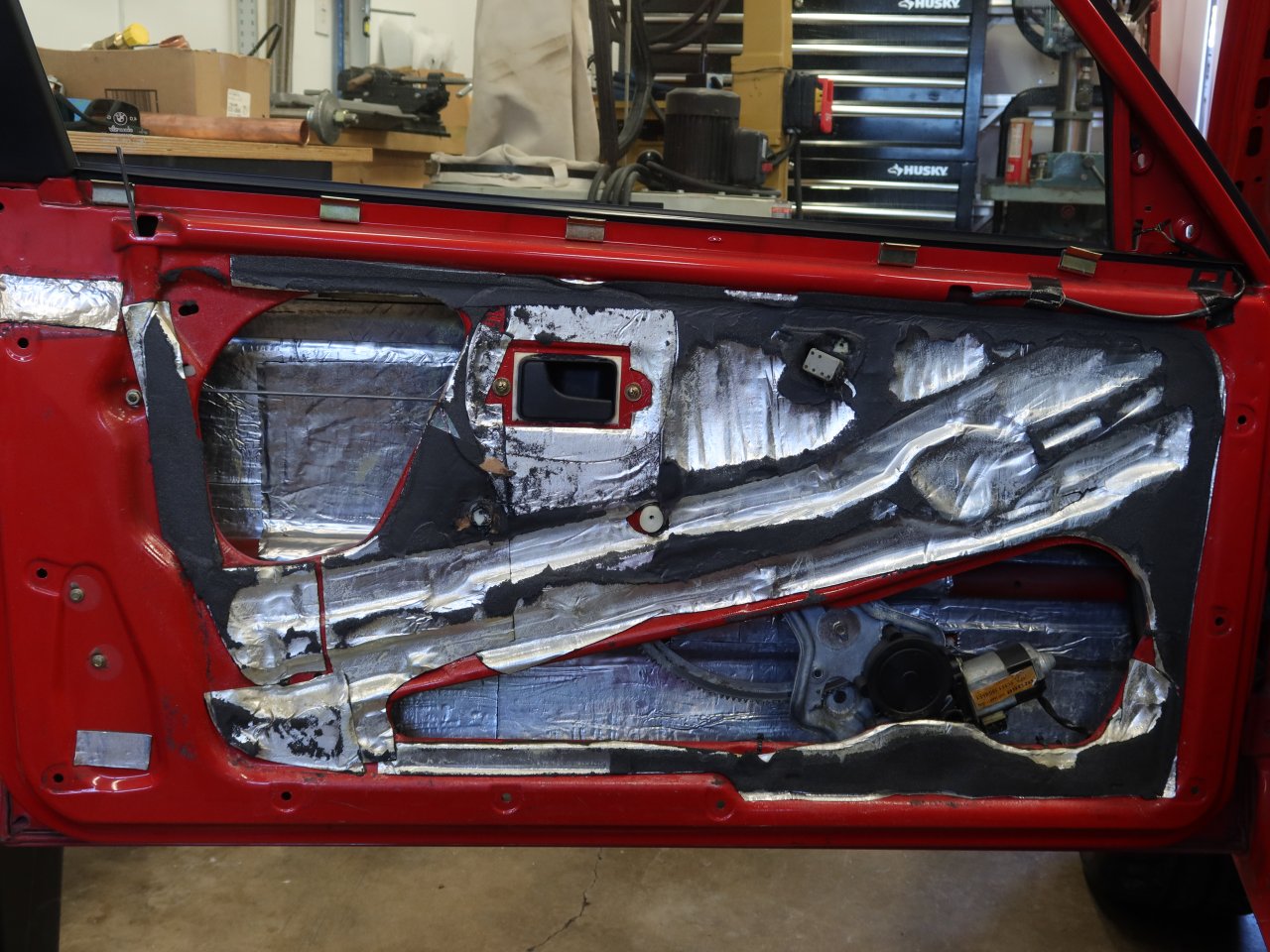

                        Today I got some work done on the driver's side. Once again I was faced with removing all of the sound deadening that I had stupidly put there. This side was worse for some reason, maybe because it is the side which gets a lot more sun when parked at home? Whatever the case, it took a little over 2 hours to clear it off. There are a bunch of small nicks and scratches from the window scraper, so I will be using some touchup paint to seal them when this all goes back together.
                        I took out some of the door guts, found a few more ounces of water in this side's wire harness, and popped the door trim. There was much less bending involved this time since I knew what to expect, but I did still need to straighten the lower one from the door. Damn, that piece is flimsy!
                        So there it is for now. I just need to deal with the door jamb and rear quarter window to finish up the bulk of the work here. From there, I just need to remove the sunroof, pop out the windshields, and remove the muffler to make room around the rear valence. So far so good!

                            Sound deadening: 100% worth it! The doors sound like blocks of wood when closing them. I used a product called Damplifier from Second Skin Audio, and in some places added their Overkill 1/8" closed cell foam. There are some lessons that I can pass on.
                            - Wear gloves. The heavy duty metal foil layer is awesome for its purpose, but it will shred your hands when installing it
                            - Get a small roller that is like 1-2" wide and 1" in diameter. The deadening sheets only work if they are actually fully adhered to the sheet metal
                            - You will need to remove all of the old tar-based sound deadening, and then clean the surfaces that it was on since the oily residue will prevent any new sheet from sticking
                            - DO NOT PUT THE DEADENING ON EVERY LITTLE SURFACE! I went nuts and was trimming little pieces to cover every square inch; it a waste of material and time. You want to cover the large panel centers since those are the least damped areas. So, apply the material to the inside of the door skins (seen in my photos) and NOT the inner frame where the door cards go, the inside of the rear quarter panels next to the rear seat, the rear bulkhead between the seat and trunk, under the rear seat bottom, the floor pan and transmission tunnel, the sunroof panel, and up along the firewall. Again, you don't need to go out to the very edge of everything, just cover the central 90% of those areas. I would say that doing the doors made the most noticeable difference.
                            - I also did the underside of my hood in the 3 recessed areas, and then applied (IIRC?) the Mega Block heat shield product from Second Skin, with some high temperature aluminum HVAC tape around the perimeter. This made a HUGE difference in terms of quieting engine noise.
                            - If you want, you can also apply it to the flat inside faces of the door cards and rear seat side panels.
