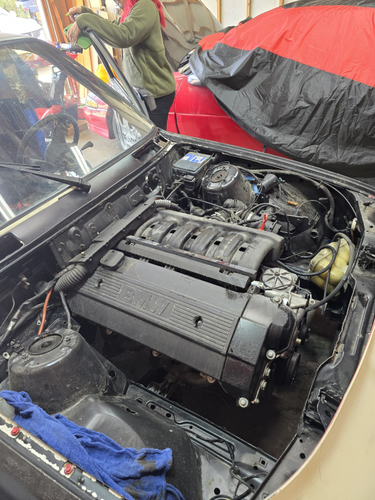

            Im working with a mess

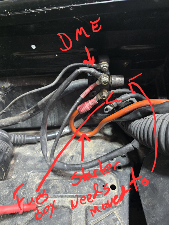

            I did figure out that there was the old e30 fuse box wiring in place and thats what my mystery red wire was for. It was the m50 fusebox wires.
            Now Im stuck on the e30 distribution block. The big battery cable I know would normally clamp to a starter cable. This m50 has a red eyelet for that instead. What I dont understand is where do other posts get power as it doesnt look like the big cable feeds any if them with a continuity test.
            As for background .. never touched a bmw before but give me a 350z or dsm and I can work on them blindfolded.
            i hate to even ask wiring stuff but inheriting something I didnt take apart and no e30 to look at makes it difficult
            I know the starter wire has to move to the end of big cable.
            The 2 that go to fuse box should go on a post I believe but only one has a big enough hole.

                There should be two main positive feeds coming up from the battery.
                The large one which goes to the starter, and a smaller cable (which has a fusible link in the trunk) I believe this is the one you labeled "DME".
                Both of these normally connect into the left side of the block.
                On the right side, there is the main lug that connects to the starter as you mentioned.
                Believe on my car there are two wires connecting to that smaller wire on the right hand side of the block. Don't quote me on that though, it's been some time since I've even had that engine bay block installed.

                  I figured out by looking through the pictures of stuff I need that the starter cable is where the 2 wires to the e30 fuse box go. At the least Ill need to find an old clamp to put on there so it has those conections.
