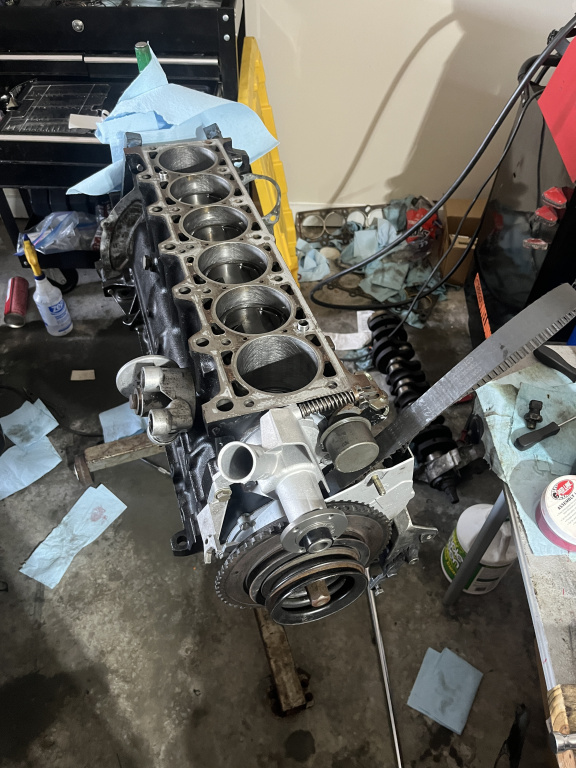

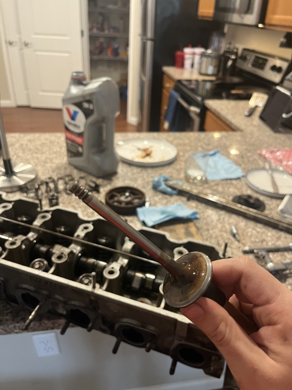

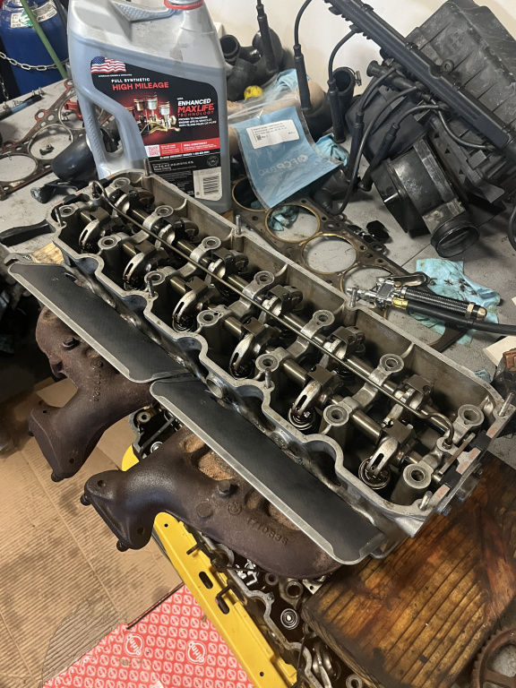

    As I mentioned, I started with the head. I wanted to keep the budget under control, but build the bottom end up enough to support a turbo in the future. I compromised on the head, deciding to keep it completely stock.
    Freshly lapped valve, in the kitchen of course
    Freshly rebuild and ready to go in. Every gasket and seal replaced, rockers inspected and lash adjusted to spec

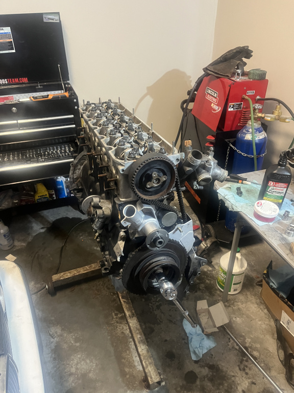

    With the head ready, I focused on the bottom end. I didn't do as great a job getting pictures unfortunately. I gapped the rings and assembled the engine, but in the process, I made a stupid mistake and damaged the threads on one of the connecting rods. They were K1 Technologies rods, which have been out of production for years. I couldn't find a replacement anywhere, and I ended up just buying a better set. I went with Supertech rods, they are clearly much beefier and only 20 grams more. I will post a more complete list of every part I used later.
    Fresh cylinder walls, new water pump, and ACL rod bearings installed and ready to party
    Head torqued and timed. Getting close!!

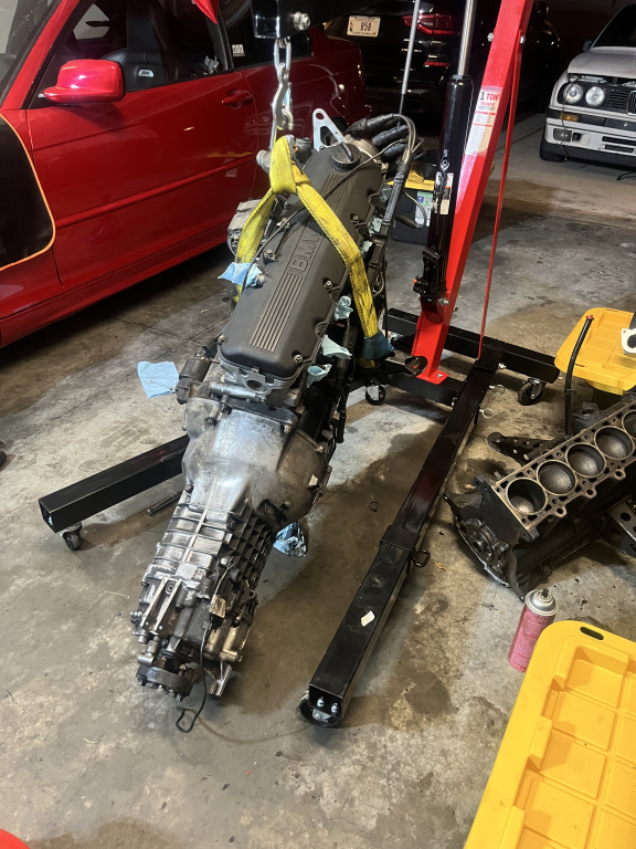

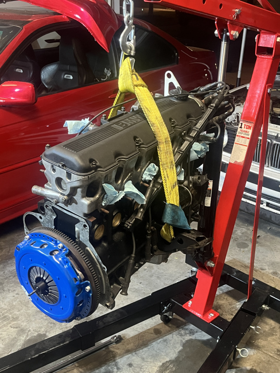

      Engine transferred to crane
      Clutch assembled
      Transmission mounted
      I was hoping to reseal the transmission and rebuild the shifter while everything was out. I realized I didn't have what I needed for either project though; for the shifter, I can't get the plastic carrier and shift lever apart without taking the whole thing out, which requires breaking off the old shift knob. And after digging around, I can see I need a rear shift carrier more anyway, and I'd probably like to do a DSSR. For the transmission seals, it seems necessary to use a silicon lubricant and Curil or a similar sealant to make sure it doesn't leak. So, I've decided to wait on those projects.
      Next step is installing the engine and getting the standalone setup!

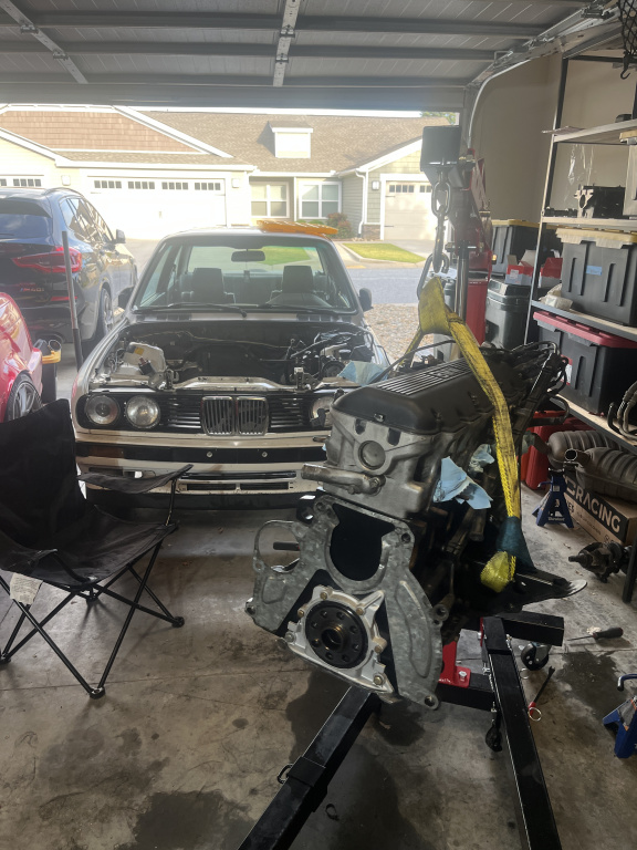

        Back where it goes. Ignore the odd mix of white and black, my girlfriend is painting my spare valve cover. Cleaned up the old one for now.

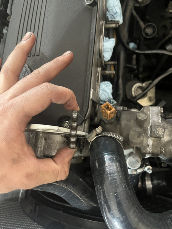

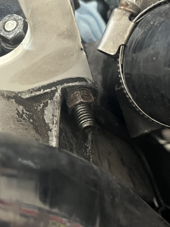

        While pulling the engine around to get it on the mounts, the threads pulled out of the upper timing cover bolt. Turns out, you can use an exhaust stud and an intake nut!

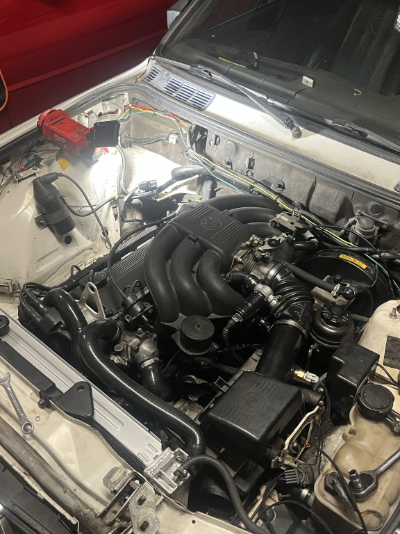

        The current situation. Cooling system is back together, standalone pigtails installed, intake installed. Still need to mount the ECU, power steering, and a few misc bits and bobs.
        A quick mockup of future potential

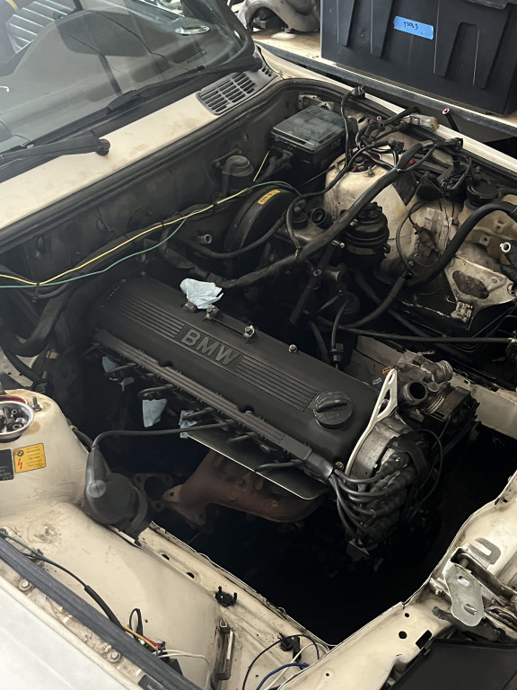

        Also, what is the general opinion regarding throttle body heater hoses? Mine has been bypassed since I got the car, and it takes FOREVER to warm up. I installed a new thermostat a while ago and it made no difference. I'm pretty sure my throttle body won't freeze here in SC, but in general I'd like to keep things OEM ish. At some point I'll probably use them for the feed and return to the turbo (no time soon), but in the meantime should I just leave it bypassed?
        First start is getting very close!!

          YMMV but I don't mind a throttle body heater bypass.
          Worst case you hit the (narrow) conditions for the throttle to ice up. Then you just push in the clutch and pull over, same as a sticky throttle cable.

            I had my TB heater hoses looped on my M20 for years and never had a problem.

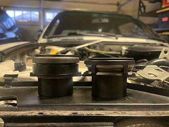

                      I need some help from those with more wisdom. Should I just try to return the clutch and get a 6 puck cheapo on ebay? Should I try a 323 throw out bearing? I saw that rouge engineering makes an adjustable length slave rod as well. I bought the clutch through VAC motorsports, not sure how helpful they will or won't be. Advice is appreciated as always!!

                        I decided to order the 323 throw out bearing. It arrived yesterday and it seems to be longer than the one included in the kit based on pictures online. Once I drop the transmission I'll know for sure.

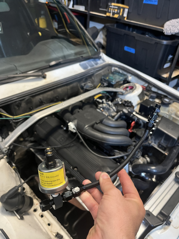

                        Also, I finally did something about my oil pressure sensor. For whatever reason, the setup I had in the old engine doesn't fit the same on the new one. I had a T-adapter coming out of the stock pressure switch with a 1/8 npt sensor in the side. When I tighten this in the new engine it always points the 1/8 NPT hole toward the block, and no stacking of crush washers can fix this.
                        My solution
                        I've been wanting to experiment with AN lines, and this seemed like a good opportunity. I have an adapter from M12x1.5 to 4AN, then a short 4AN line to a sensor block, with the end capped off. This may seem like way too many connections, but the idea is that I can expand this as necessary with an oil temp sensor, provisions for the stock switch, and I can use this as a turbo feed as well.

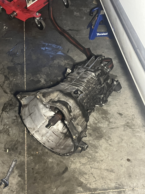

                          I got the trans out!

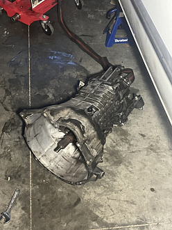

                          It was much harder to remove from the bottom

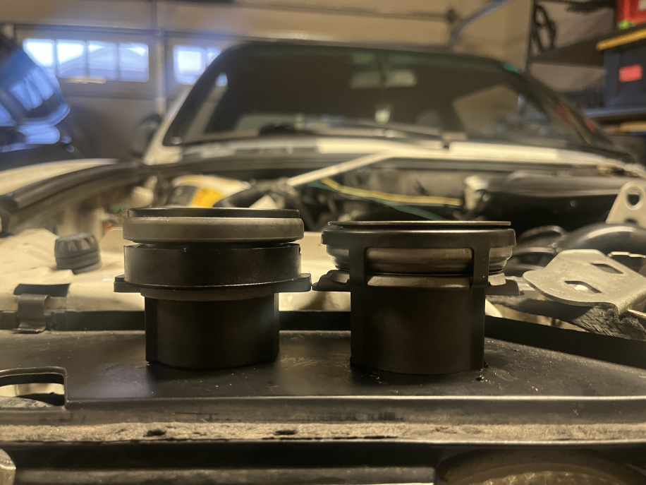

                          And thankfully the throw out bearings are different!
                          Left, new 323i TOB. RIght, TOB included in spec kit.
                          I'm hoping and praying this will fix the issue. Absolutely no idea why I need the longer one since I'm running a late model 325i getrag 260 with a stock single mass flywheel. The plan for today is replace all the seals. New trans fluid and a new bitch clip (i broke it) are on the way from FCP. My 20 minute drive with the messed up clutch has refueled my motivation just enough!
