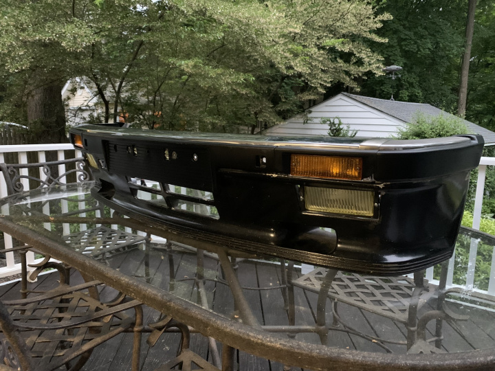

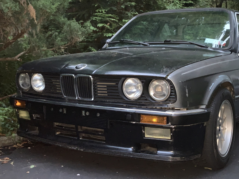

      Replaced the euro bumpers - previous owner had banged them up pretty bad, filled them with bondo and painted them black. They were also completely rusted out on the inside. Installed fogs, new turn signal housings, and smileys. At this point I no longer had my shop space in Brooklyn so all work was delegated to my parents driveway on weekends when I had time.
ID:	10131913 Click image for larger version
ID:	10131912 Click image for larger version
ID:	10131914 Click image for larger version

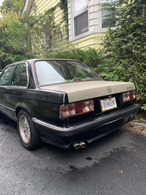

        Sourced some replica startecs that I thought would fit the build well. With the Mtech kit I thought it would be best to stick to period correct mods. Also got a trunk, hood and sunroof which I was waiting to have installed during paint.
ID:	10131916 Click image for larger version
ID:	10131917 Click image for larger version
ID:	10131918 Click image for larger version

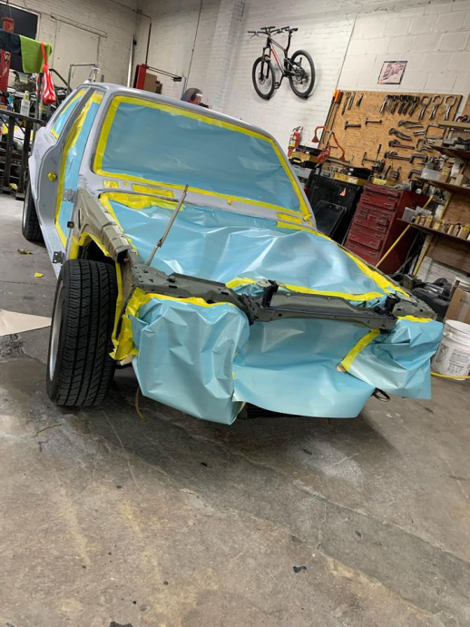

            Coming up on a year of ownership now and the car had really come a long way. I'm really proud of how much work I put in. I had always been interested in working on a car like this but I found it to be really intimidating. Once I started though, I realized it wasn't impossible. It sure cost a lot of time and money though. I had put in too much effort for it to look bad, so I decided that paint was best left to a professional.
ID:	10131930 Click image for larger version
ID:	10131927 Click image for larger version
ID:	10131928 Click image for larger version

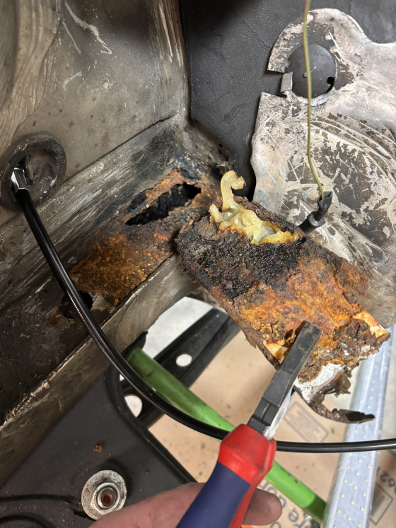

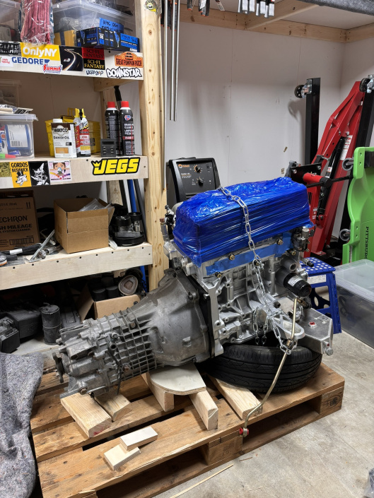

                    Moved out of the city and finally have my own workspace. Picked up a K24 that was previously installed in an E30. It included most of the components needed for the swap. I had been researching this project for a long time and when this local deal popped up, it was time to dive in. First up I removed all the accessories and painted the block.
ID:	10131960 Click image for larger version
ID:	10131962 Click image for larger version
ID:	10131963 Click image for larger version

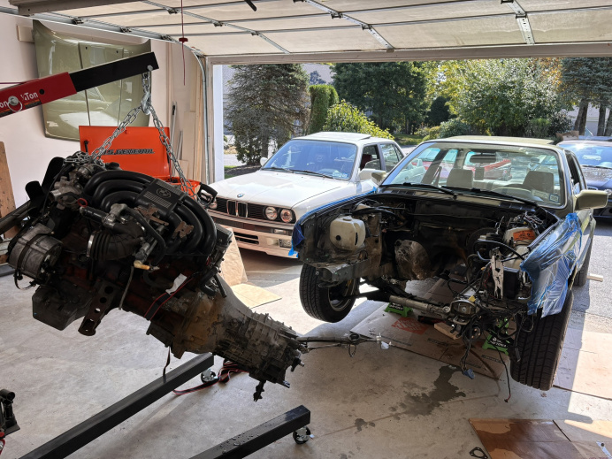

                        Originally posted by 2mAn
                        Man oh man! WOW!

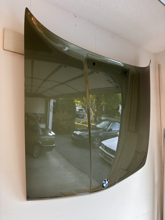

                        Hung my hood on the wall, help came by and we pulled the M20. This K24 swap is going to be in 2 phases. The first phase being mostly a mockup and test fit. Hopefully can get a few test drives in too. Then it's going to come out so I can do a wire tuck, shave the bay and have it painted to match the exterior.
ID:	10131975 Click image for larger version
ID:	10131972 Click image for larger version
ID:	10131971 Click image for larger version
ID:	10131973 Click image for larger version

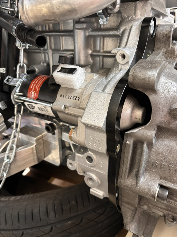

                              Next up I bolted in the TF Works transmission adapter plate. Little tricky to then hold up the g260 and see where it has to be modified to fit the Honda starter. I marked it with a sharpie, then cut slits with an angle grinder to get most of the material out. Then I used a flap disc to smooth out the edges. With that complete, I installed the clutch and pressure plate.

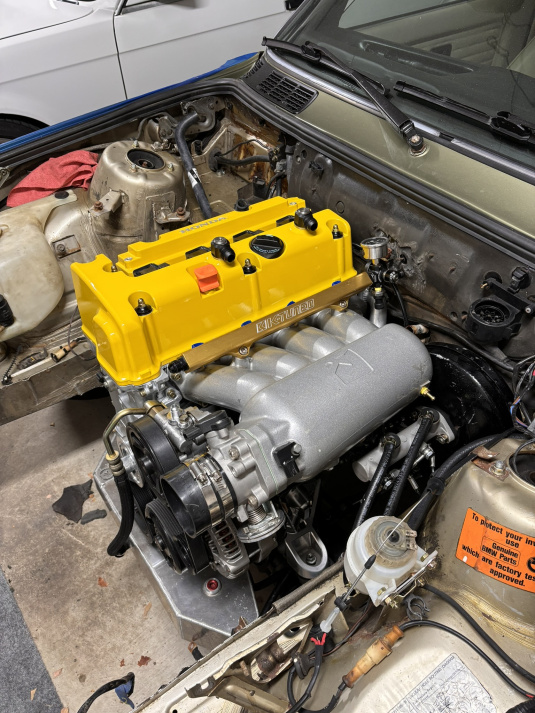

                                Installed my fancy valve cover and got the whole shebang installed with the help of a friend. Clearance at the firewall wasn't good. I had to use a prybar on the back of the head to bend the firewall a bit. This will need some more 'gentle massaging' when I take the engine out. Pretty sweet how far back the motor sits. Oil plan clearance is also great.
ID:	10131996 Click image for larger version
ID:	10131997 Click image for larger version
ID:	10131998 Click image for larger version
ID:	10131999 Click image for larger version
