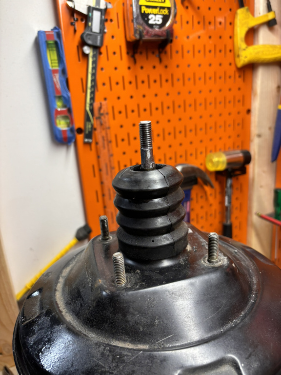

    Whoops, going out of order for a second here. Forgot to post about the brake booster setup. Really nice to ditch that crusty old one. 944 booster with a 2002 reservoir and some hoses to relocate. I opted for the Chase Bays ABS delete kit to clean up all the lines. It wasn't my first choice to remove the ABS system but it wasn't working. I also installed a Lantzfab Wilwood clutch master setup as it seems many people struggle with the high RPM shifts with a stock setup. Apparently this is the fix.

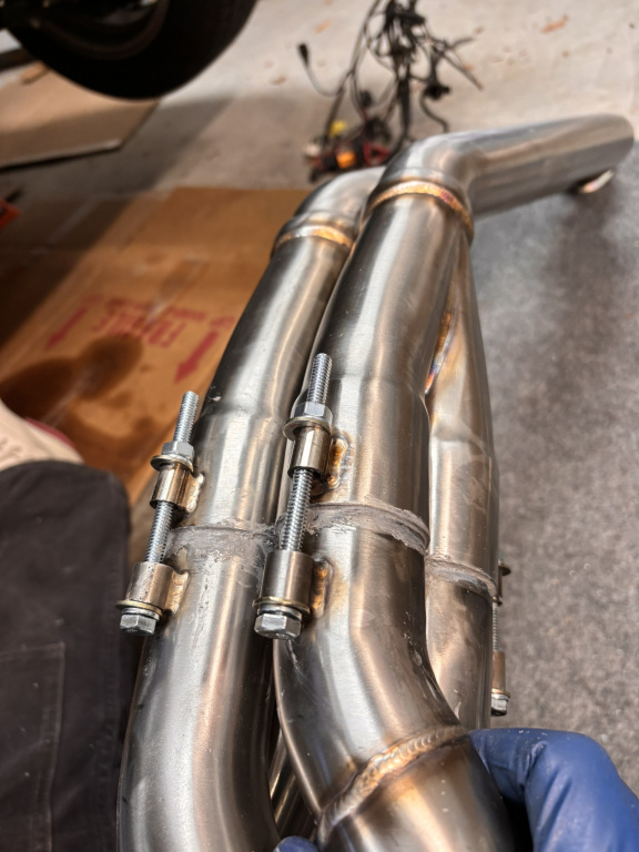

        #33
        Next up was fitting the Kpower headers, this was a major pain. The pipes don't line up at all and they provide you with some laughably short bolts. There's really no way these work out of the box. I had to grind a bevel onto one pipe to be able to get it started, then a mess of prying and hammering to get the others. I also bought some longer bolts that really helped. Of course they leak like a sieve too, so some exhaust sealant is required.

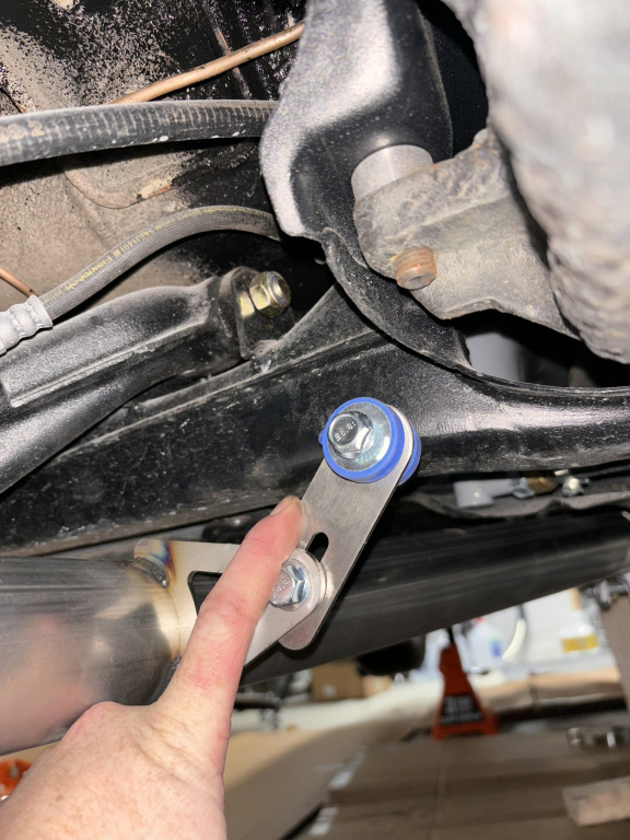

          #34
          I jumped on the Synchro Design Works 24v stainless exhaust group buy. Obviously the downpipe can't fit up but the rest should be a bolt in affair. The Kpower headers finished with a 3" flange and we were trying to fit up to a 2.5" v-band. With some help from a welder buddy, we managed to fit it all together. It wasn't long enough to fit the mtech bumper so we had to extend the mounting brackets.
